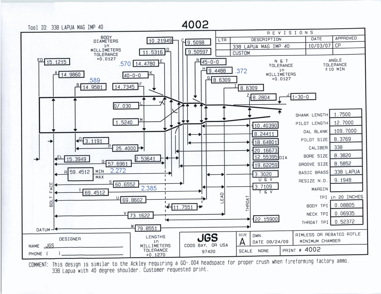

Yep, 40 degree is the most common. Here's a copy of the reamer print I've used (JGS reamer) over the past 12 years.
As for magazines, I've only had experience with the DT SRS magazines, and they can fit a COAL of 4.00" Most of my jacketed loads have been around 3.880" COAL and some solids have been single feed because they were >4.10"

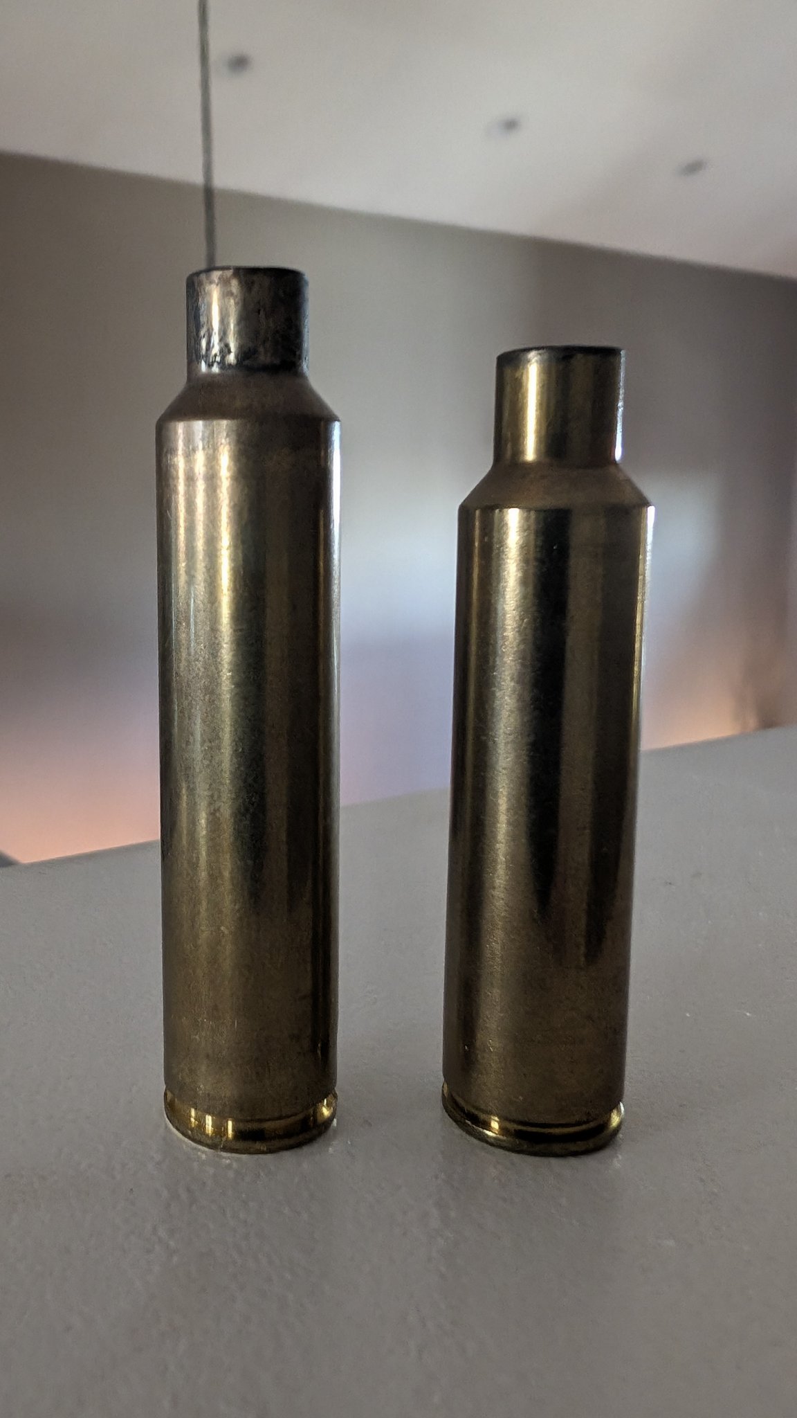

As far as single shot vs. repeater, I prefer the Norma strictly from a case length standpoint. I have never had the need to rapid fire a Lapua, but YMMV. The Norma case is shorter and lends itself better to common magazine systems, such as the AICS CIP magazines. The 338 Norma shares the same bolt face as the Lapua but in a shorter package. It's still a beast, no question.
Lapua improved on the left, Norma improved on the right.
