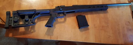

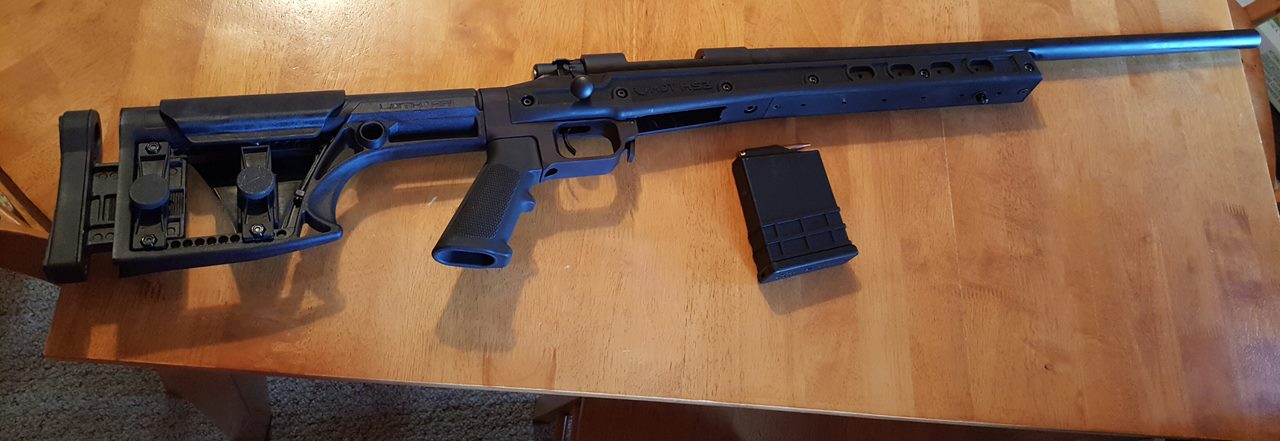

A few years back (probably 8) I built a 6.5 Creedmoor by buying a Howa 1500 barreled action and a chassis from MDT. I am wanting to do something similar with a 338 lapua but I am not seeing many, if any, barreled actions, and seeing so many different options on actions and barrels has me nervous on picking ones that would work together. I was able to figure out everything on the 6.5 but obviously the action and barrel came together. This would be my first time getting them separately if that's how I have to go. Any input, suggestions, or articles/threads to read would be appreciated. I want to learn on my own but also don't mind some guidance. I would rather build one that buy one off the shelf (even if it's just putting a few pieces together like the 6.5>
I just want something decently priced that I can have fun with 1000+ yards but also be consistent although I will almost certainly never do any kind of competitions with it.
Thanks in advance
