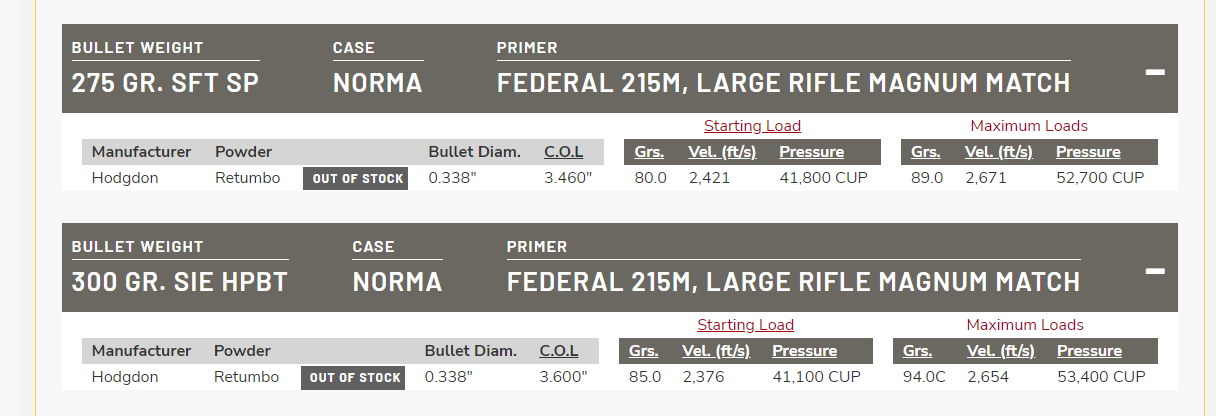

Your powder manufacture will have the online data that I trust most
From the Hornady Manual (11th Edition) for 285gr ELD:
Start: 81.7
Max: 93.0
Powder: Retumbo
Case: Hornady
Primer: Fed 215
Max COL: 3.681"
Barrel: 27.17", 1:10 Twist
Start low and work up!
Reactions: 338dude

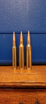

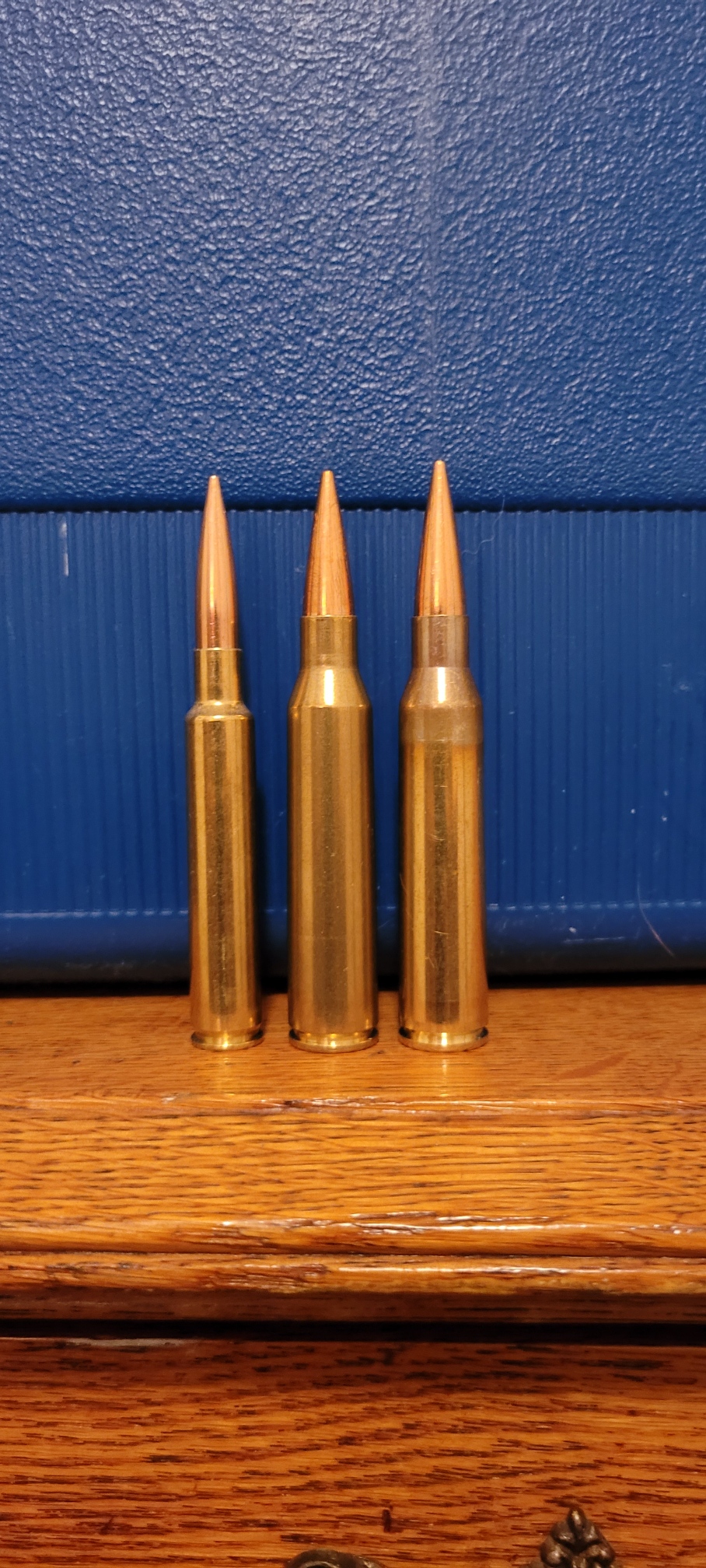

I have the christensen mpr in .338LM my rifle has an obnoxiously tight throat form the factory which seriously limits the ability to seat the bullets out and robs case capacity. Also causes pressure often under book maxes.
!I feel it's imperative with christensen rifles to have a coal gage and test every bullet you plan to use to determine your max seating length! Obviously it's a good practice in general but there is too much variation in clambering with christensen to risk it.
Below L-R .280ai, my load lapua brass berger 300, berger factory same components
Reactions: THN338
Its got 275 and 300 which are close enough. Interpolate.
To the OP, I happened to have the Hornady data but just an FYI since you’re new; ^ this guy knows his shit inside out and backwards and forwards. When you’re in between on bullet weight with published data you can interpolate as he said; and Retumbo is an excellent powder for .338LM.
