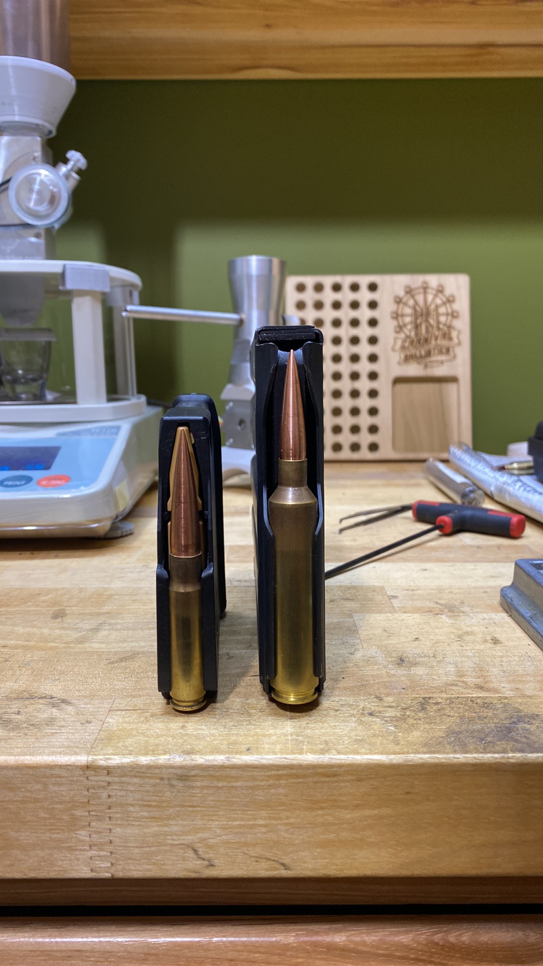

338 Snipetac with 265 badlands in a rather short throated chamber. Getting these things to fit in a mag isn’t optimal
