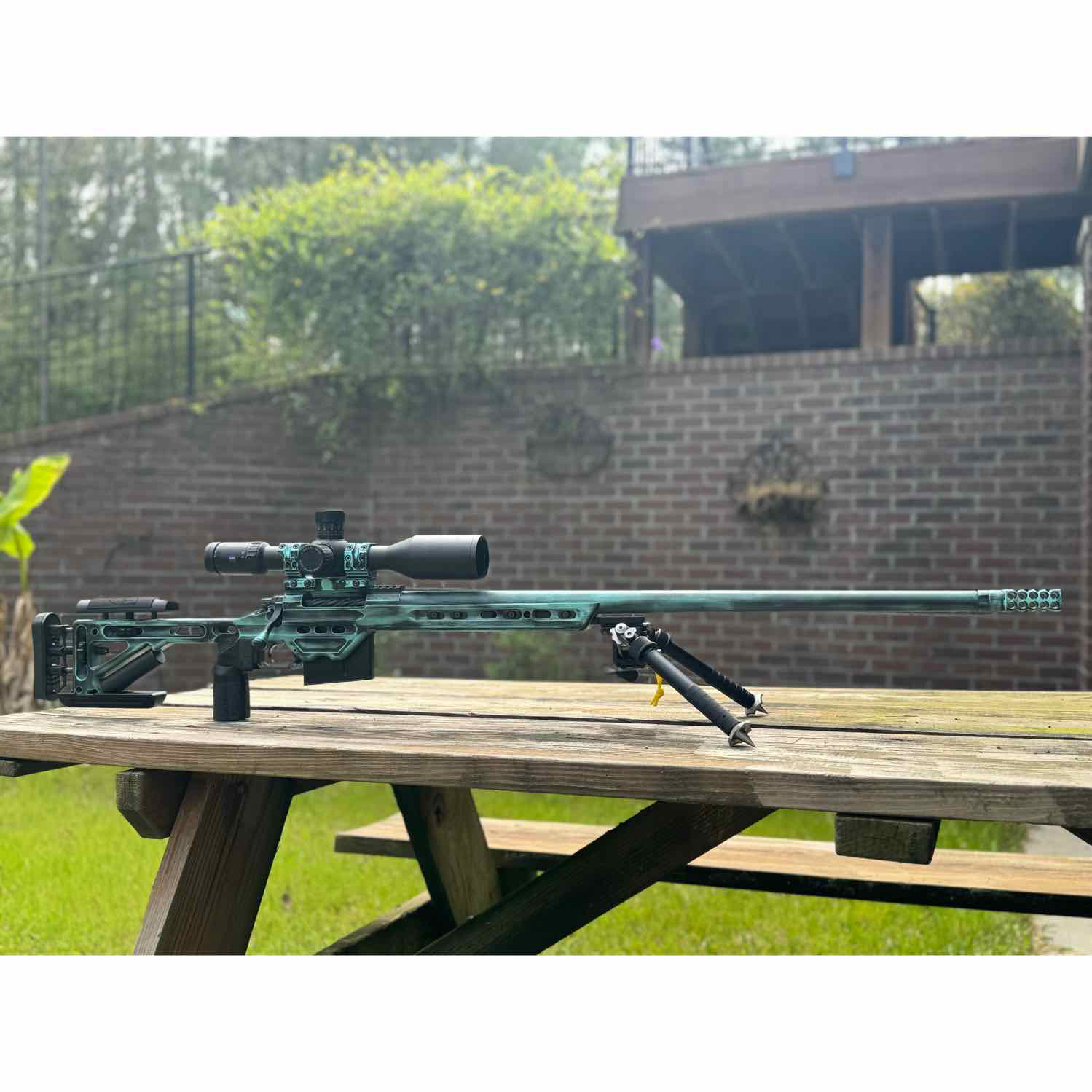

what is everyone’s stock/chassis of choice for a 33XC when trying to make light gun requirements? Currently running just a basic MPA ba comp but wanting to make a change once this barrel craps out. Already got my new blank from K&P which is a 34” 1.35 to 1.10 taper. My rifle right now is currently sitting at 25.5lbs but really wanting to move to a stock or a chassis set up that has a similar feel to a stock when behind it.

What is the build specs of your rifle, looks like a Stiller TAC 300 long action? I see it's git a magazine, I didn't think it would run in a CIP magazine.

It’s a defiance deviant action. Still doesn’t feed through the mag, I just keep the mag installed in the gun so it’s easier to single feed.

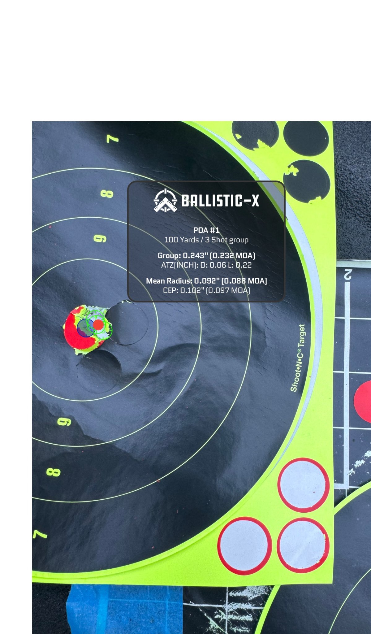

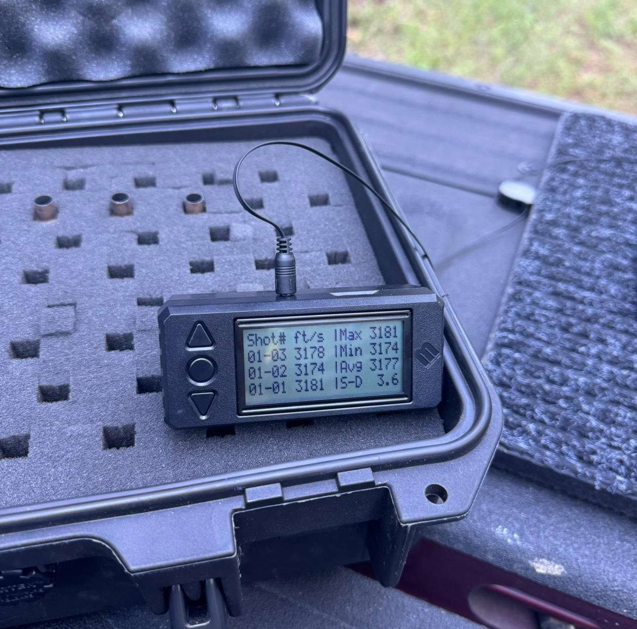

Yes that is correct. And I’d say barrel life on the 33XC could be anywhere from 600-1000ish just depending on your load. The load I’m shooting I fully expect to be around 700 rounds. I’m shooting the 300gr bergers right around 3175 with N570 in a 30” barrel.

It’s a Krieger 1-9.3
Once it gets shot out then I’m gonna play with my 34” barrel from K&P that I just got. It’s a 1-8 so I’m gonna mess with some cutting edge lazers. But so far the Bergers have been great, ATips haven’t shot to bad either.
