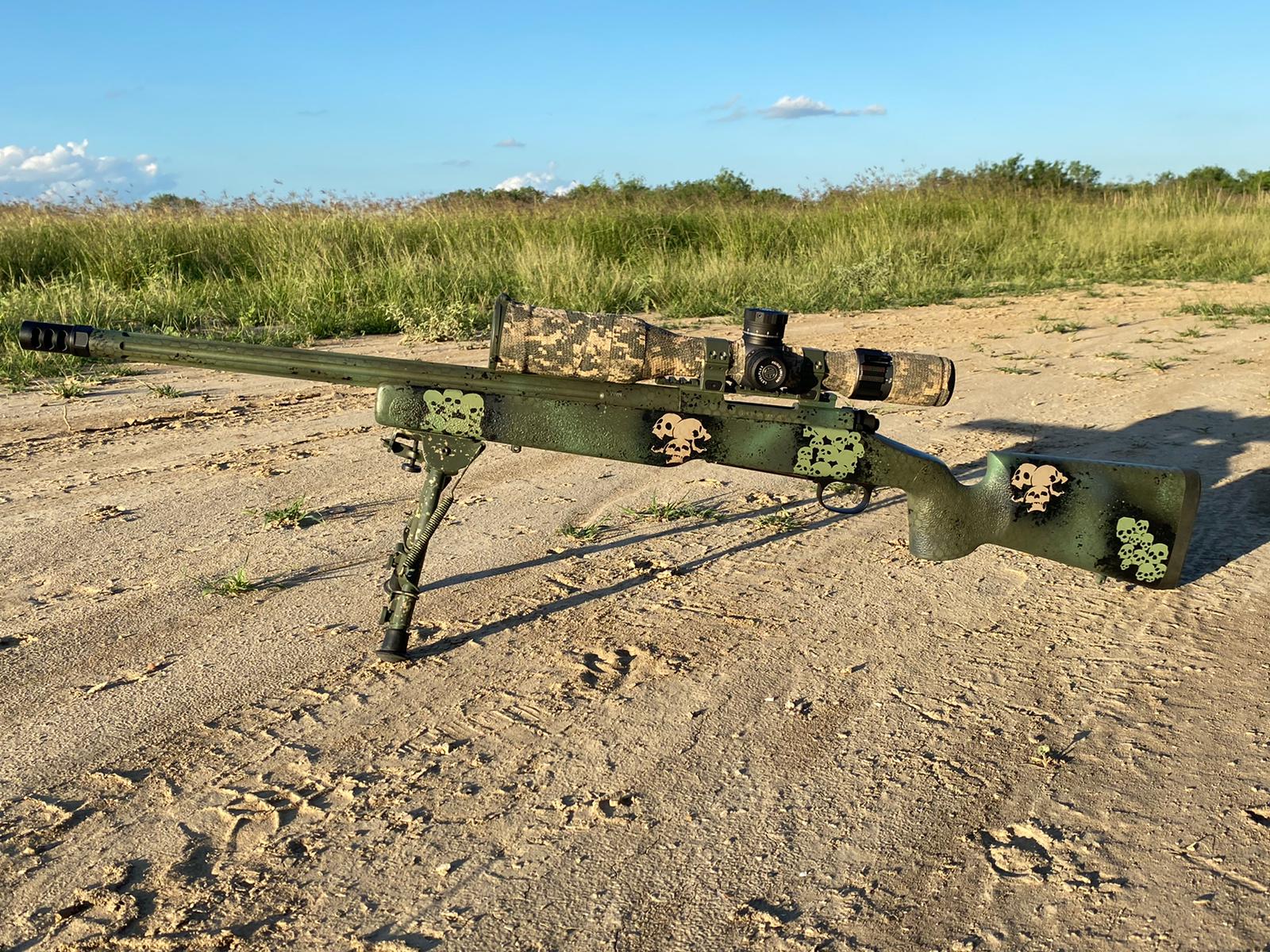

If that is your setup in the picture, I dont think you can go much lower.
The objective will probably hit the picatinny rail and sooner or later your bolthandle will get too close or even hit the occular of the scope.
If you change both the rail and rings then you might get a tad lower, but your bolthandle will still need to clear. Is it really worth it?
It looks like you have a super solid setup as is.
Reactions: Pippinm7

I'm not sure you can go that much lower.
Having a rail that does not extend out forward is going to help. You should look into APA rings or Ken Farell rings as those two options are going to the lowest you will find with them being very high quality rings.
You can try and remove the base and go with direct mount rings or mounts as you mentioned, but idk how low those go. The very few that I've seen, are not as low.
Going super low is not always best though. You need to figure out where you get the best cheek weld. If it truly means going real low, then by all means go for it.

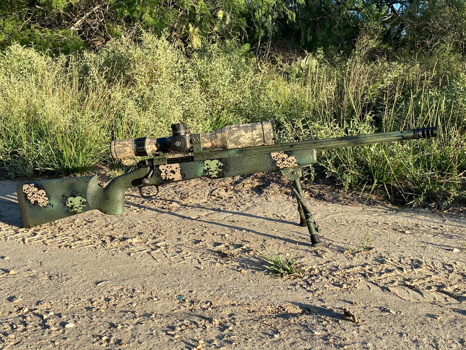

My setup in that picture as you can see is real low. At the time, it had EOtech low rings and a second gen Sig Tango6 4-24 scope. The stock I believe is a McMillan A2. Those were just some temporary rings though, my setup is a bit different now as it has some slightly higher rings and a different scope.
Good luck!
