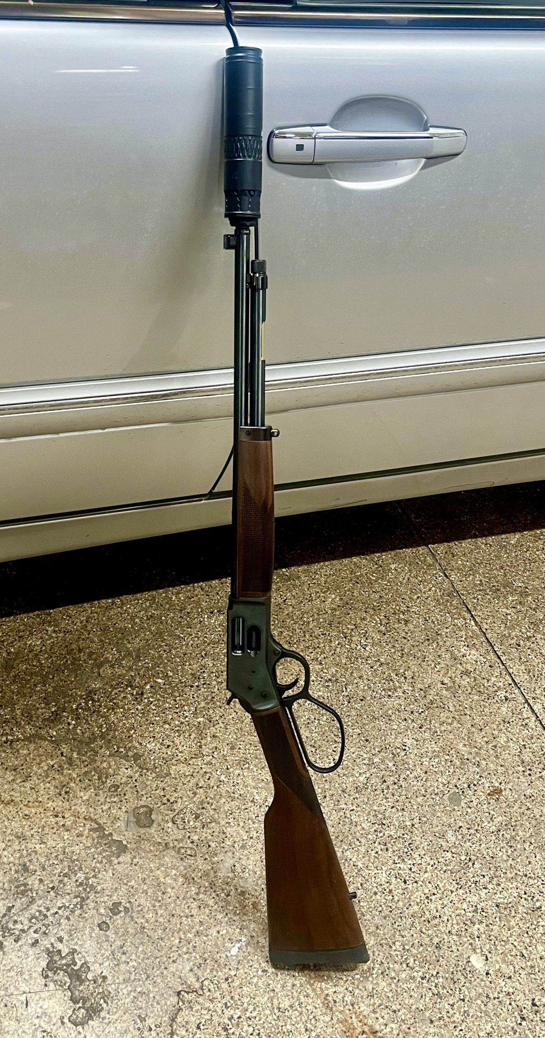

I picked up a Henry Big Boy .357 and had it threaded. A bit pricier that route but I wanted wood furniture. Suppressed .38 is a blast.
