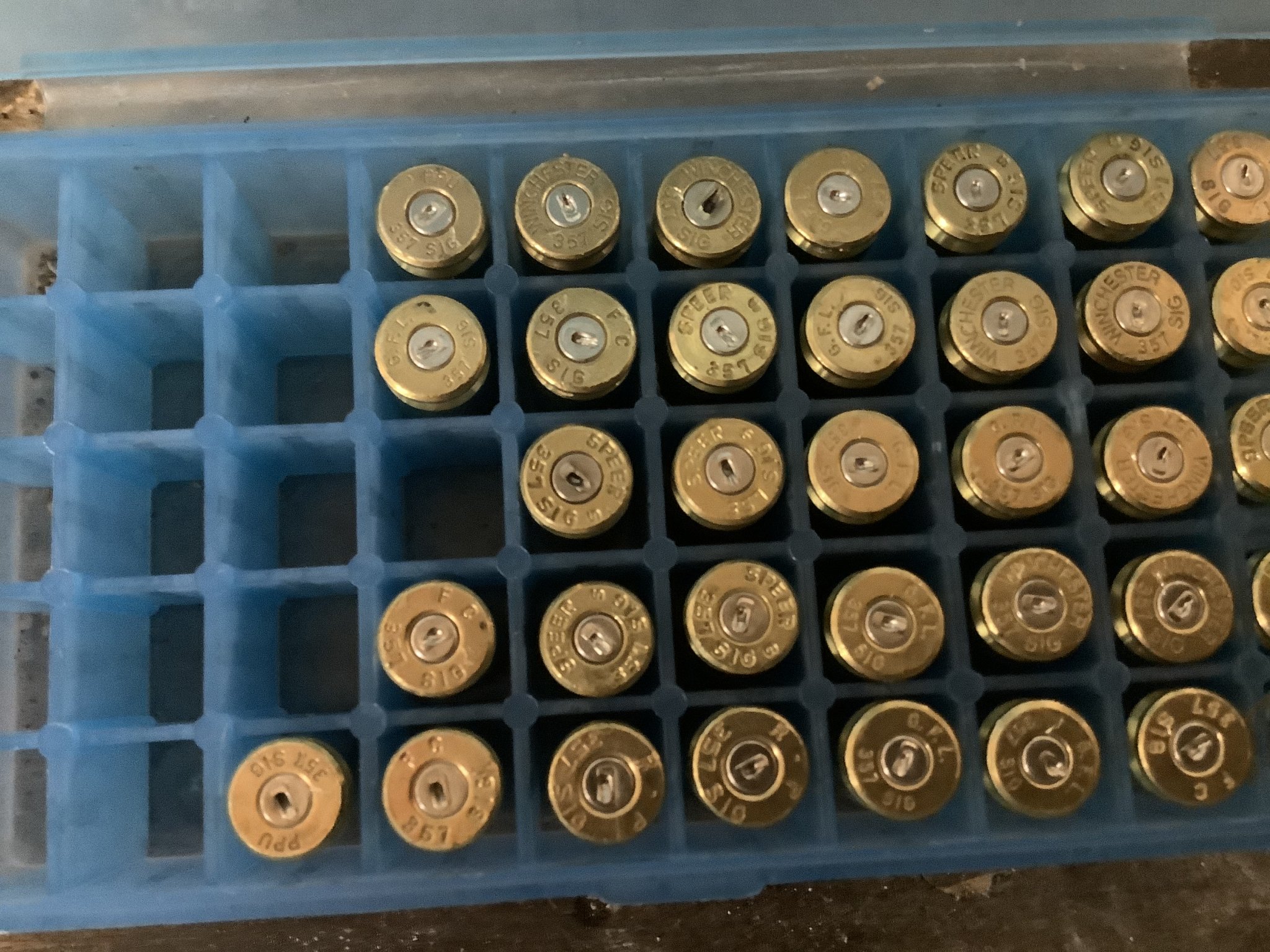

I’ve changed my mind.... unless I have done something horribly wrong, and that’s a distinct possibility, 9.2 blue dot under a 115 FMJHP didn’t work out well. I loaded up 50 and I’m not happy with the results. Lots of failure to extract, groups were large and the recoil and muzzle flash were spectacular. I think I even perforated a few primers
It's a bad idea mixing headstamps with fast powder and high pressures. Just last weekend I worked up a different load for 357SIG. I sorted a few hundred headstamps, and within the same "Federal" cases there was an 500mg (~7.5gr or 10%) spread in weight. That difference in weight accounted for a tenth of an inch difference in powder level in their respective cases!
In your photo I see at least 6 different head stamps(!):
PPU
Speer
FC
R-P
G.F.L.
Winchester
Sort them and weigh them for a coarse comparison. If they're all the same weight then it's less dangerous at the pressure limit.
How are you dispensing powder? If you're inconsistent then you may be getting excessive pressure in one case and safe pressure in another... Then, being that you're reloading SIG, have you confirmed that you're not getting any bullet set-back on chambering? High variation in cartridge overall length at the time of ignition can severely affect peak pressure too. Different head stamps might yield differences in neck tension as well.
And don't load and shoot 50 of something that's blowing primers! You're literally playing with fire.

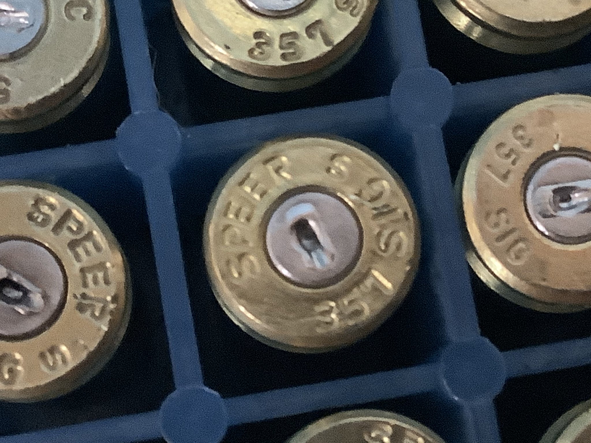

I have been re-loading a pile of those Speer "s" cases, like what you have in your pics above, for more than a decade. I have run them in a carbine at some pretty high pressures and through a couple pistols and I have not had one fail on me yet. I'd sort those out of your mixed cases and run those, personally.

I'm sorting out speer and it seems that Winchester is my most common headstamp. any opinion of the Winchester? I'm setting the starline I find aside. should I mix that in with any new starline I buy or not risk it?
That said. I picked up 1500 of the Starline cases a few months ago. As far as pistol brass goes Starline has a good reputation. I have not yet loaded any but they're nice, just looking at them. Well polished, round case mouths, flash holes consistent diameter and centered. FWIW 4.198 grams each average, 150mg ES, 35mg SD sample of 100.
you've triggered my inner OCD.. thanks :(
I had 549 pieces of brass, of that 158 is speer. Of that 158, 44 are stamped with something other than an "S" or are light stamps or nickle plated. of the remaining 114, there are 11 deviate more than .7 grains from the average weight of 70 grains leaving me with 97 pieces ....

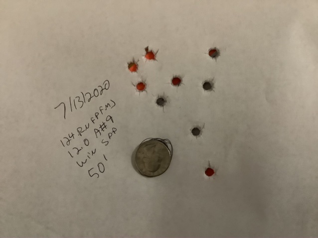

Not great but we are getting there. 12.0 grains A#9 Ofer the Montana gold 124 .357sig bullets slowfire 50’. I put a quarter over my POA for reference. I think I can tighten that up a lot . I’m only finding about 50% of my brass so I ordered 600 starline nickel, hopefully it will stand out better. One flier over the top of the photo area.
If you're just shooting from one position you can put down a tarp to catch brass. I lose a lot of my cases too, and spend too much time easter egg hunting for them.
