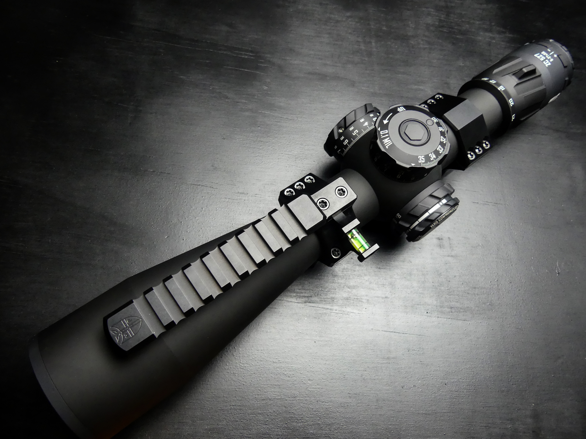

Tier ones are great. I don’t have the 6 screw. I have the pic rail rings. The bubble level where that one is, is not usable so I bought their bubble level too. I had to come off the rifle for the one that was built in. The 6 screw might be different.

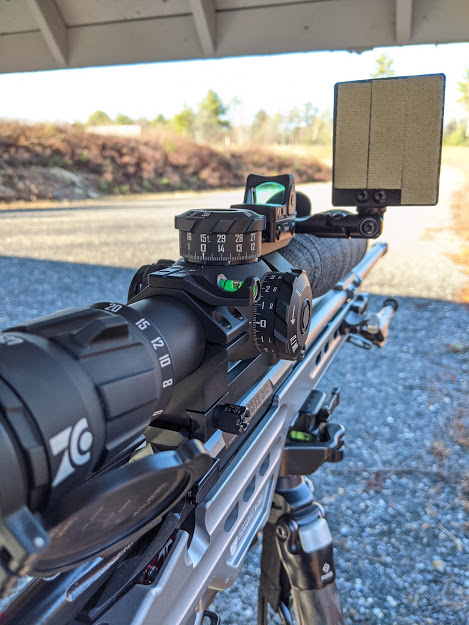

Been running 32mm (high) arc rings for both my zc527 and zc420. Perfect height for both.au I adk

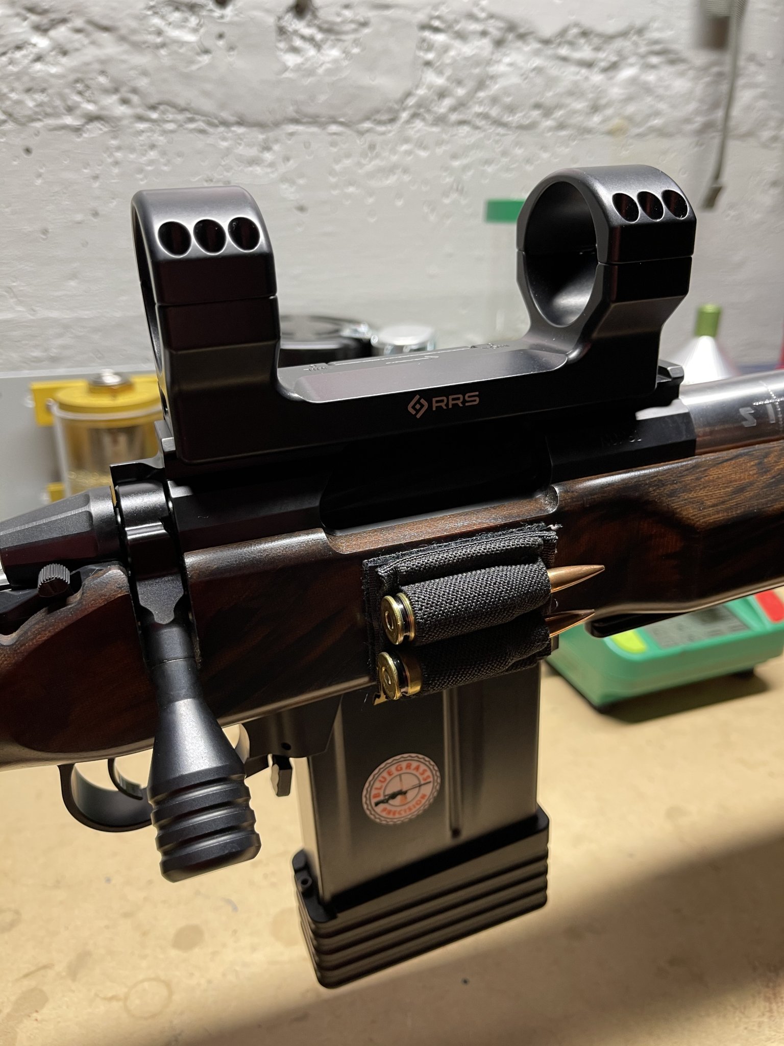

Will check them out. 32 mm height is not very available on Spuhr. They have a cantilevered design at 32 mm tall. RRS has a good looking design made from 6061 Aluminum, not 7075 like most that I am considering. Though, Not all are 7075.

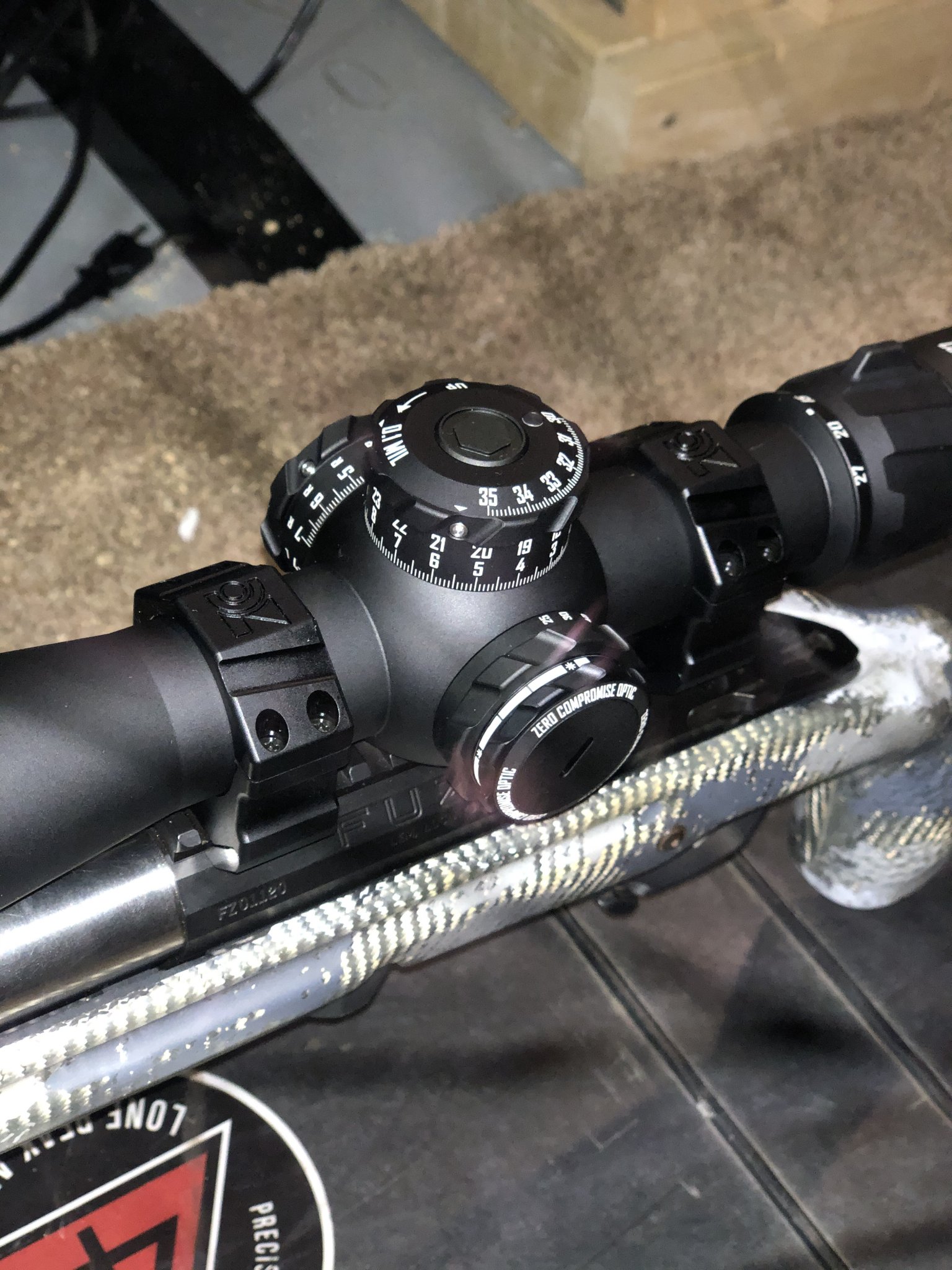

Really like my zco rings. Made by APA. View attachment 7516733
