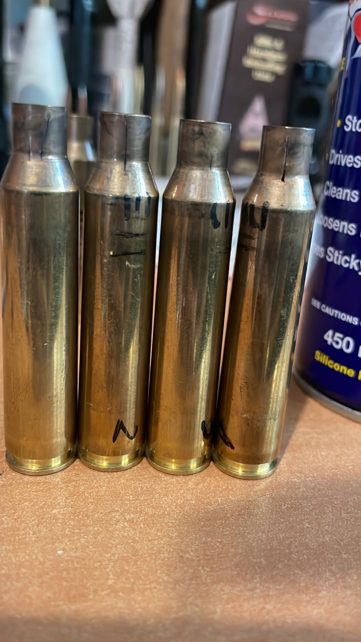

But, I’m only managing three firings before necks are splitting.
Should I be annealing after every firing?

I was however a little surprised to notice case necks were splitting after only three firings; the first two firings were from running in the barrel with 300gr soft points (very affordable) with fairly light loads (135gr RE50) so it’s not as if I was pushing the brass to its limit.
So annealing it is then……..

Necks splitting after 3 firings; annealing will help, but there is something else going on. That is the difference between loaded and fired outside neck dimensions?

0.4030” is the outside neck dimension of a loaded round (with new brass).
Unfortunately I’ve resized my fired brass, so will take the measurements of a fired case when I next book our local testing range. Wish I’d have thought of that before.

Current round count is 35 including the 10 light loads to run the barrel in (shot-clean, shot-clean, shot-clean, 2 shots-clean, 2 shots-clean, 3 shots-clean).
The split cases came from the ammo used to run the barrel in.
I’m pretty sure all five cases had two firings each (but I may be wrong).
I can only measure a resized case for comparison at the moment, but they are also 2.700” give or take a thou.

Usually excessive headspace leads to head separation, not neck splits
