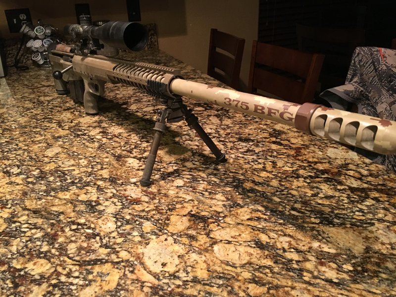

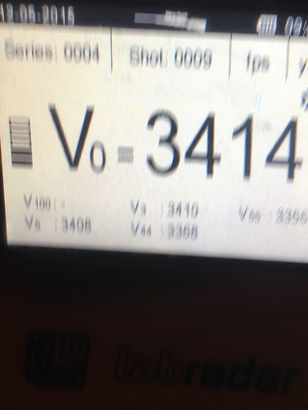

I've been running one in 375 Cheytac, it has run well for me. Competed in two ELR matches with it so far in SoCal. URSA. Won both matches at 2082 yards. Last one was in some pretty brutal wind, managed 5/10 with 30-35 mph wind at 2082 yards in qualifying and 4/10 was good enough to take first in the match. I've been very happy with it. Also have a new conversion for 375/416 Barrett that Ive been playing with and hope to debut for the ELR Central's World Record match before SHOT. Its showing good promise....3400 ish with 361 Flatlines.

Barrel is Bartlein 1:10.5 twist with HTI spec shank, 1.250" to muzzle. XXX bastard brake. Reamer came from PTG. I'm making brass from 50 BMG Tto 416 with dies from CH4D. getting it to 375 with home made dies.
I'm running NF 8x32x56 (loaner from a buddy, I have a 5.5x22x56) it's on a Coldshot MOAB 150 MOA base.
