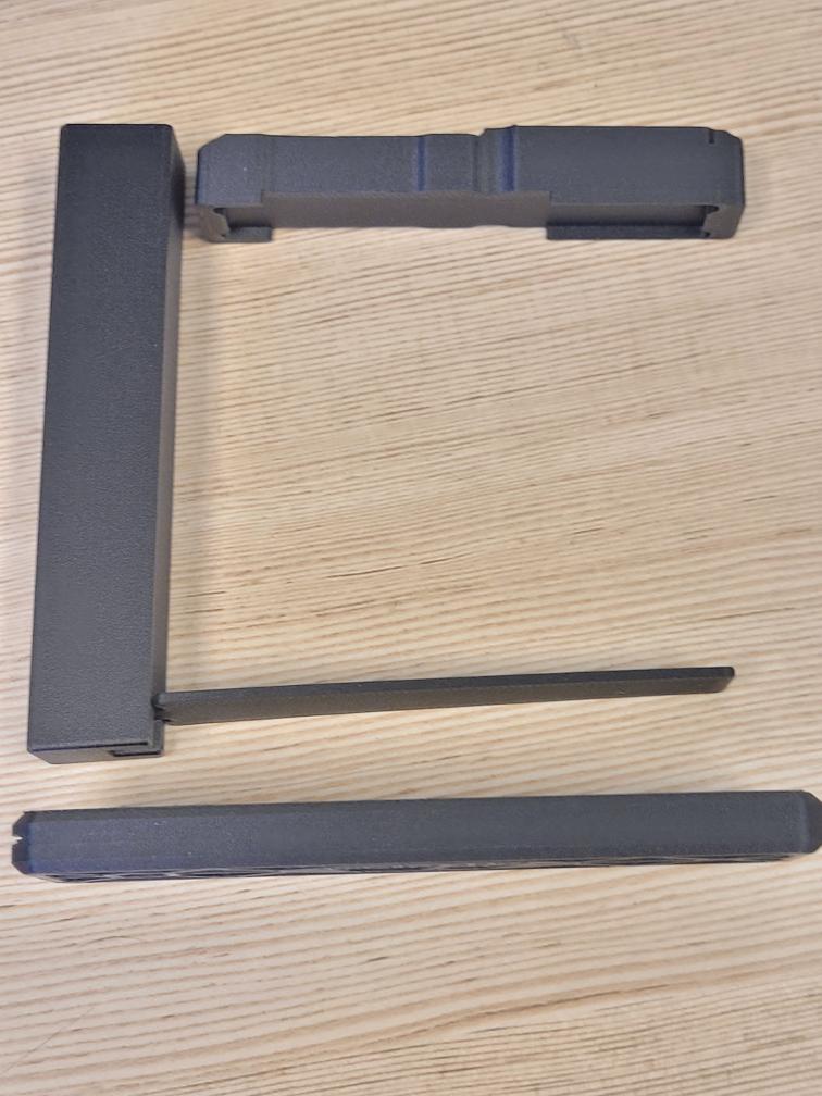

    Hi,
    338 CIP external dimensions but spacer, follower and feed lips for short action cartridges.
    3D printed in 316 stainless steel.
    Sincerely,
    Theis

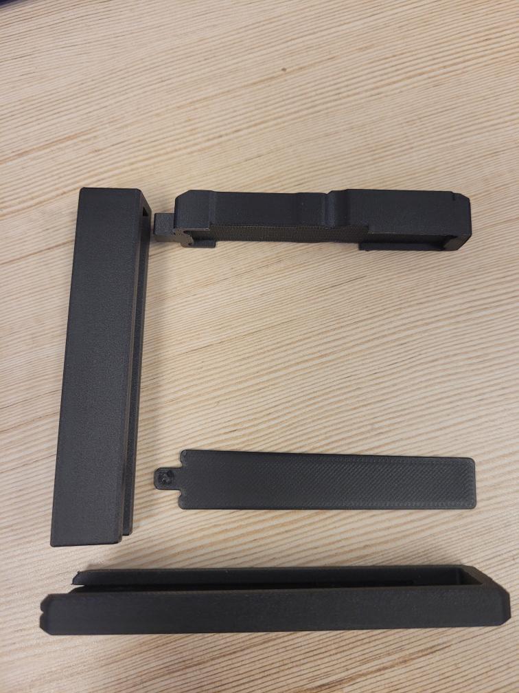

    Did you/can you print the follower and spring inside in one shot?
    Hi,
    Did we? No, Keeping them "independent" allows us to change out the spacer to follower length relationship for optimization of different cartridge shapes/lengths.
    Can you? I guess everything is possible but I would think it would not be productively feasible.

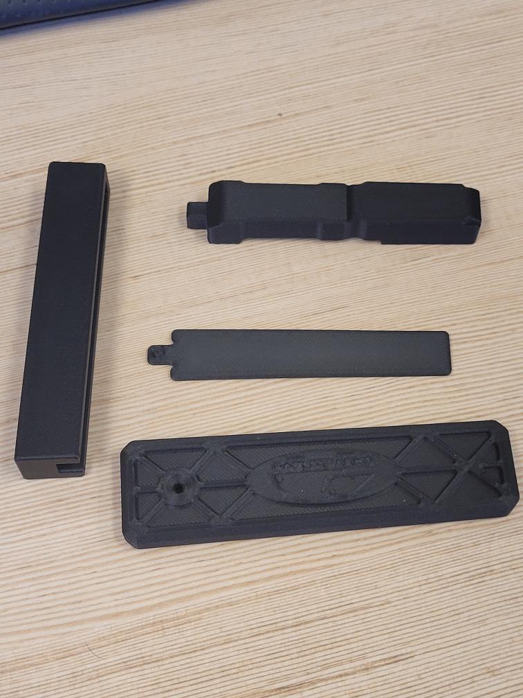

    Hi,
    Less than half of that but still cheapest way to test a concept than paying to setup forming dies, etc for stamping.

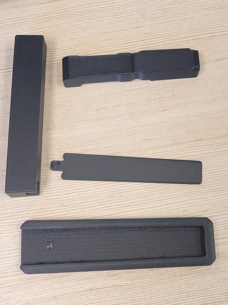

    no i hear ya...making 4 prototype mags sounds like a pain in the ass.
    DMLS im assuming?...any issues printing that thin? warping?
    Hi,
    Correct, DMLS.
    No issues so far but we haven't started running magazine changes through the rifles; but there should be no issue at all.
