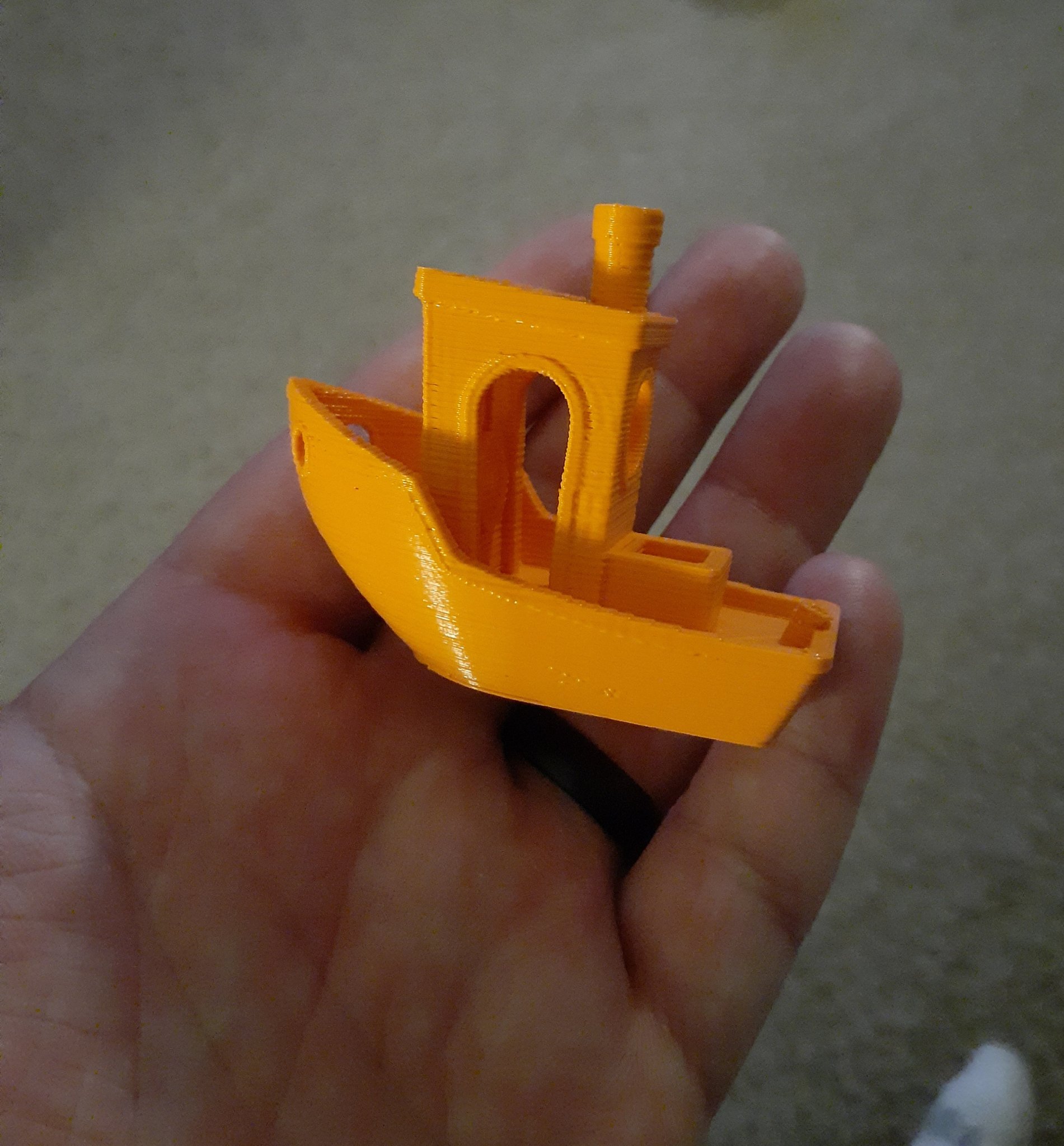

    Go to thingiverse and download the "Benchy" boat. It's a standard test piece that people use to adjust their slicer settings. Print it with various settings and experiment from there. Theres also other test pieces designed to test different characteristics of the print process such as overhangs, temperatures, etc.

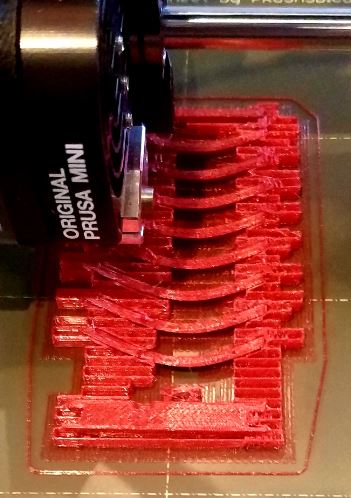

    i got a prusa mini so i could print better baffles for my air rifle moderator, and a speed loader. pretty slick but the extruder kept jamming 1/2 through the first print and i had to take it apart and figure out how to get the tension correct.

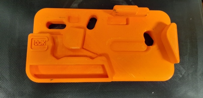

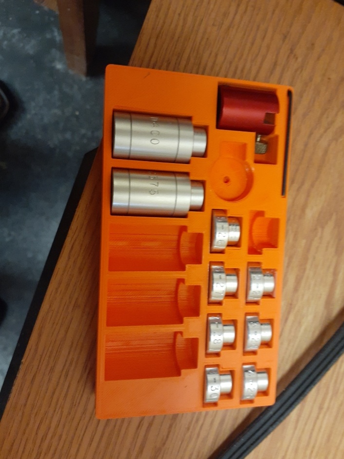

    Reloading tool organizers
    BXA tool holder rack
    Collet racks
    Test indicator holder

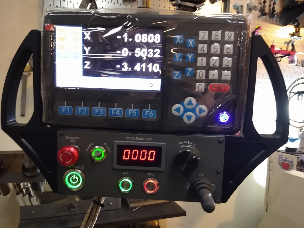

    Control panel handles
    Chuck cradle
    Mill table parts tray
    I wouldn't be without my 3d printer.

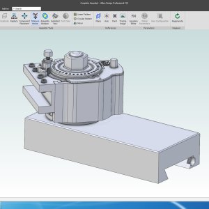

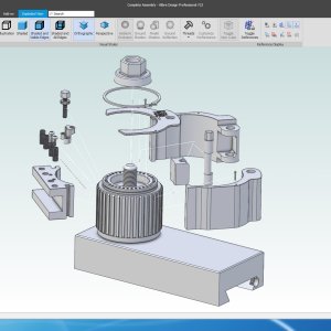

    All modeled using Inventor Pro and/or Alibre Design Pro. I used Inventor for 10 years, then switched to Alibre Pro a year ago.
    Alibre Design Pro is damn near as good as Inventor, but cheaper and a one time purchase.

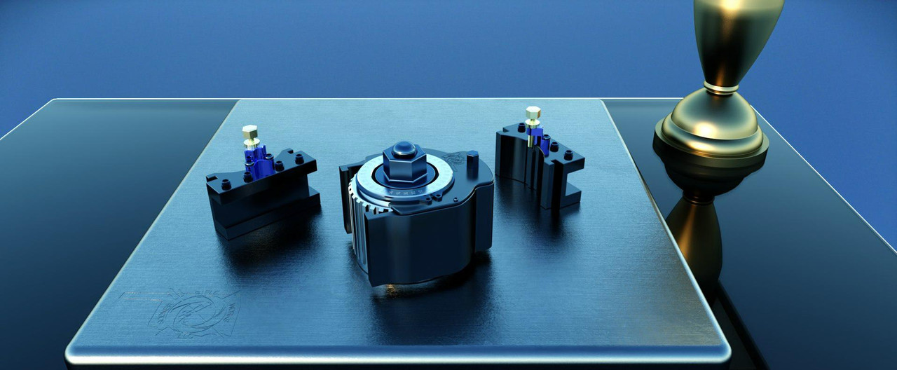

    My Multifix/Drehblitz hybrid design, modeled with Alibre. It has a 36 spline wheel for 10 degree toolpost position increments.

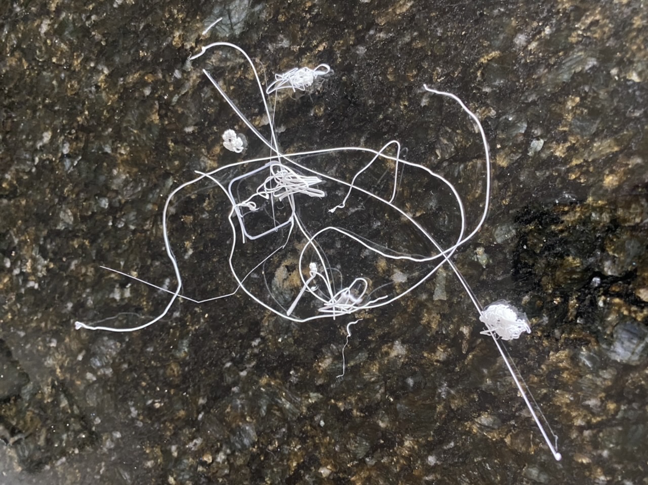

    I'm just getting started myself. Sat on the floor for a couple months and I think my problem might be water in my PLA now. Need to get something to dry it out.
    About to build this to make it easy to print from PC.. https://octoprint.org/
    If you have a food dehydrator or an oven with very good temperature control, you can simply heat the material and drive off the moisture. I try to stick around 120-135F when doing this - any higher and the material will get too soft. Fusing together a spool does not improve print quality :mad:
    I eventually bought a dedicated spool dryer, which is just a food dehydrator with a slightly different upper rack.
    Bulk desiccant and Tupperware work well to store filament. I use the stuff that changes color when it absorbs moisture, and then recycle it by heating at 300F for a half-hour or so. Works well in gun safes, too.
    I'd dare say that soggy filament and drafts in my office were responsible for, oh, 75% of my issues. Struggles in getting the print bed glass perfectly clean represented the other 25%.

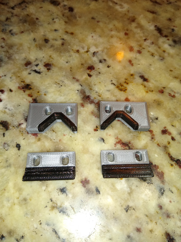

    Way wipes for my lathe. Tpu and pla epoxied together.
    I even drilled and tapped my tailstock for a set.
    These look fantastic. The black 'seals/wipers' themselves, that is "extruded too? Soft, rubbery-stuff as opposed to (what I'm assuming) the grey 'hard' plastic?
    If so, I didn't know that 3D printers could do that sort of material. That also opens up a whole different tangent of possibilities.
    Collet racks
    Chuck cradle
    I especially like the chuck cradle and your tool holder rack. If you're machine is ever sitting idle one day.... :)
    Yea, the grey is PLA, hard plastic. The black, TPU, is about the consistency of rubber. I control the hardness of the TPU, with the infill. Thin walls and low infill gets you a soft spongy type part. Thick walls and heavy infill makes for a fairly solid rubber puck. RC car people use the stuff to print their tires. Ya gotta watch out with TPU though, try to extrude too fast and it wraps around the feed rollers.

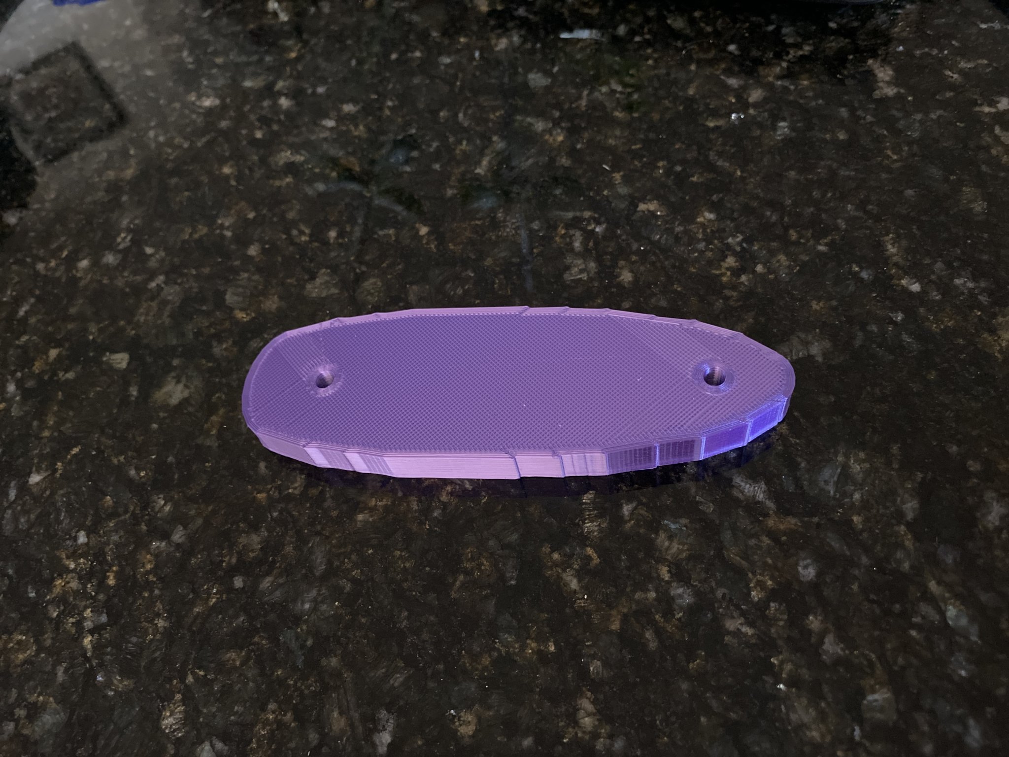

    Well, my first 'real print' was a successful failure. It is supposed to be a pic rail go pro mount. However, the supports for the go pro interface were insufficient and caused that part to fail. But, the pic rail mount slides on and off of the pic rail fine. I don't need a go pro mount, but the goal is to use this model as a jumping off point for a brass catcher for an AK that will not hinder the bolt movement, and be easily rotated out of the way for bolt manipulation. Why a brass catcher on an AK? Because I ran into a decent deal on boxer primed brass cased 7.62x39 and I'd like to save the brass. Doesn't need to be bomb proof, just easy to use and sufficiently durable to withstand range duty...
    So, the exercise in creating a printable model that translates into a functional piece continues. I've got a case block for my reloading bench printing right now. Man, the ender 3 is slow...

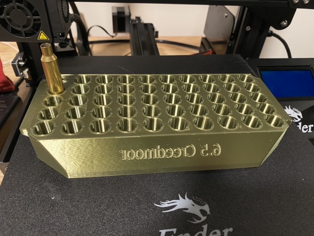

    @Campguy308

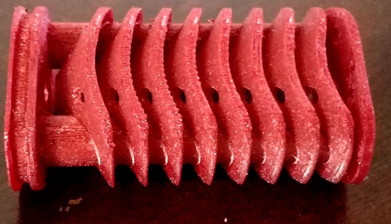

    Shiny, Silky, green bronze PLA. Yes, it did take a while to print- 14 hrs and change. And that is with only 10% infill, and the random "lightening" pattern that Cura does. Going to 10% and away from cubic infill saved 4 hours and 40% materials. But, I think that led to 2 issues with the print. 2 of the slots- the rear left most- didn't fully build the walls of the slot. I think lack of infill prevented one of the layers in each from going down well and failed. The case is sitting in one of the holes, and the spiderweb effect of the failure that formed in the slot prevents it from going all of the way in. The other is directly behind the case. The case is hiding the imprefections for the picture. And, no, that is not a mirror imaged picture. Cura has a "mirror" function, and if you are not paying attention, and really don't know what you are doing, you can hit that button and flip your print and not know it until the text is appearing on your print. One of the few downsides of printing a very symmetric model. Not perfect, but perfectly usable. have some pegboard screwdriver holders on the printer now. While the kids are at school I get to print things that I can actually use...
    Yeah Cura definitely has a lot of options. Ive wanted to print a reloading tray but havent wanted to monitor a print that long yet.

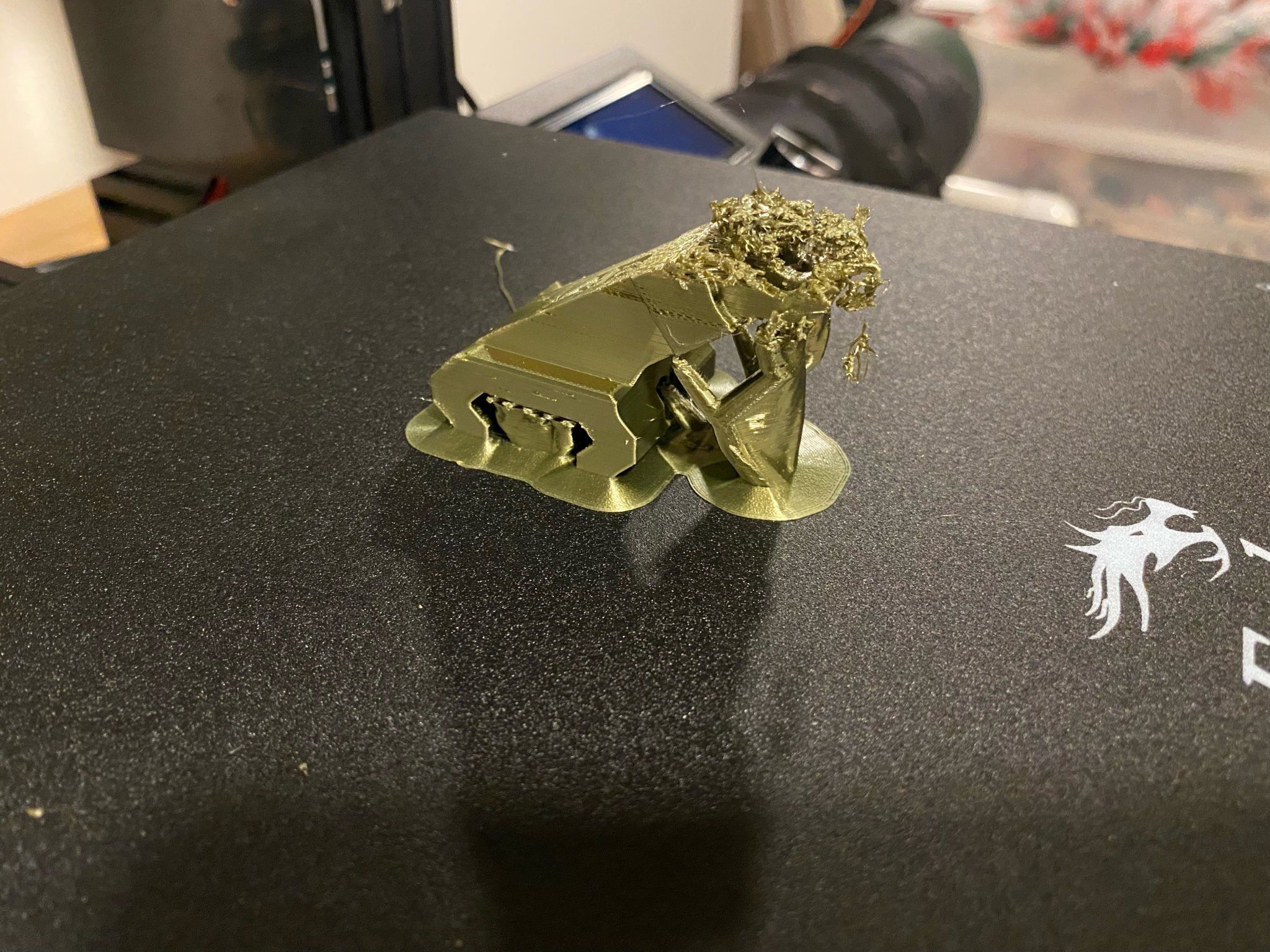

    Well, lets see how measuring and cutting works. I didn't have any issues until I ran out of the little starter roll of filament (no spool). I think the 1 Kg spools are just too much for the little extruder motor to handle...
    Well, a successful print of something that may be useful… My older son told me he needs a longer lop on his shotgun. He really wants a fully adjustable stock, but they’re pricey, and he hasn’t won enough money for one yet. But, he said “F it, I’ll print a spacer.” BAM! Not pretty, but it’ll work. We now have 3 spacers that when combined can add 20 mm to the LOP, with longer screws… School colors are purple and white.
