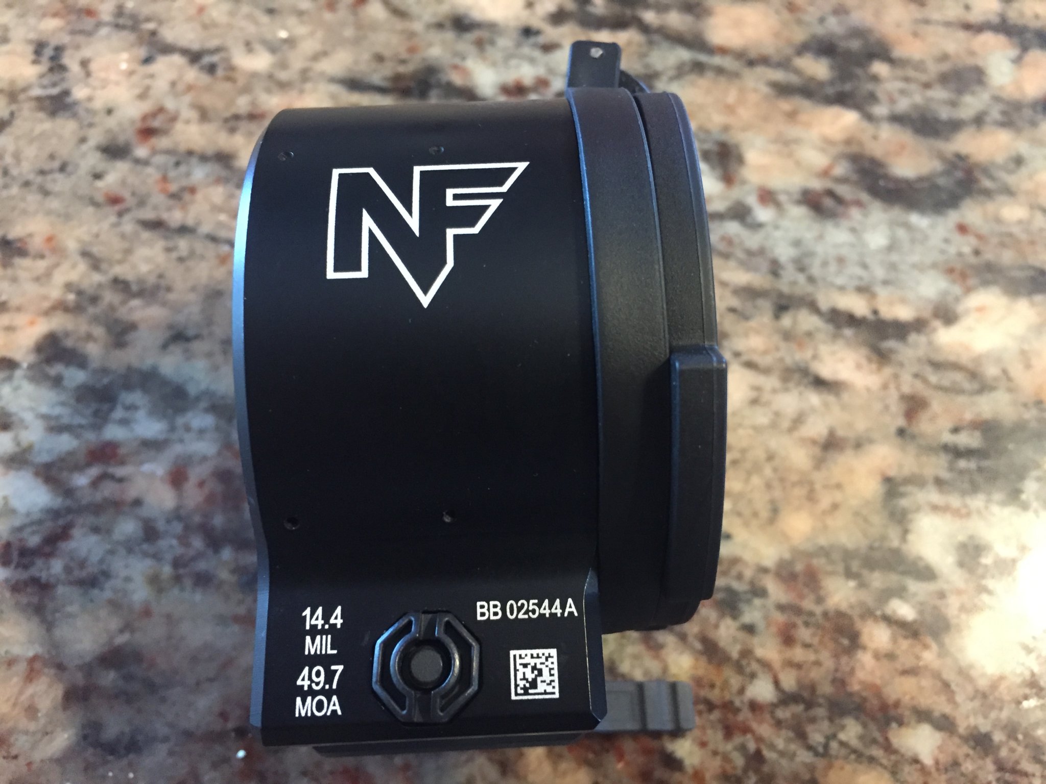

    I'm using Badger Ordnance 45 moa rails on two rifles, and a Nightforce 40 moa rail on another. They seem to be good quality.
    I run a 40MOA NF steel base on my 700/300 with a 5.5-22 NXS. Zero is 18 MOA off the bottom which gives me 80 usable MOA up. Zero issues with this setup on a 300wm shooting 230 OTMs and I can dial up WAY past any range I have access to.

    I have a Remington Sendero in 300 Win Mag, and due to my new scope being 34mm tubed DELTA STRYKER, and already having a 20 MOA rail fitted, I dug through my box of bits, and cradled the scope in a 45 MOA Accuracy International one piece mount. Plus 65 MOA is interesting.....
    I've only fired three shots to achieve about 1 inch high at 100 yards using 230 SMK bullets ; and this leaves me about 0.7 Miliradian of down adjustment left.
    I was fearing having it very close to be bottomed out, coukd be a problem, but it would appear I shouldn't be too concerned. Is that right?
