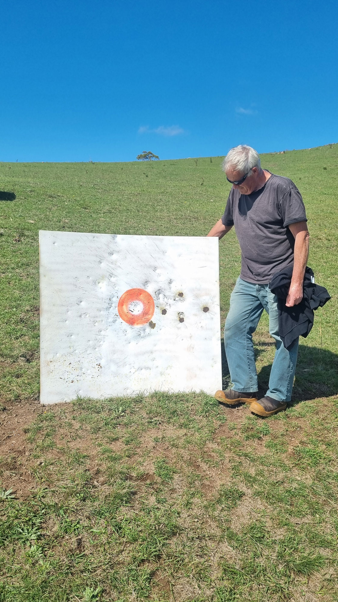

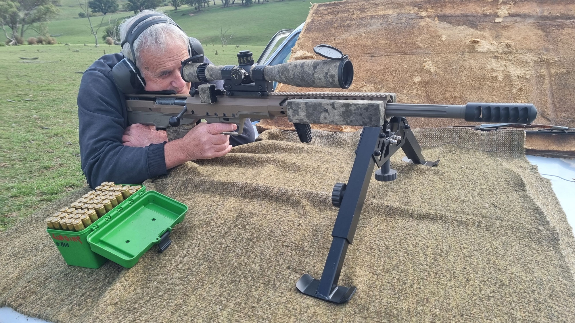

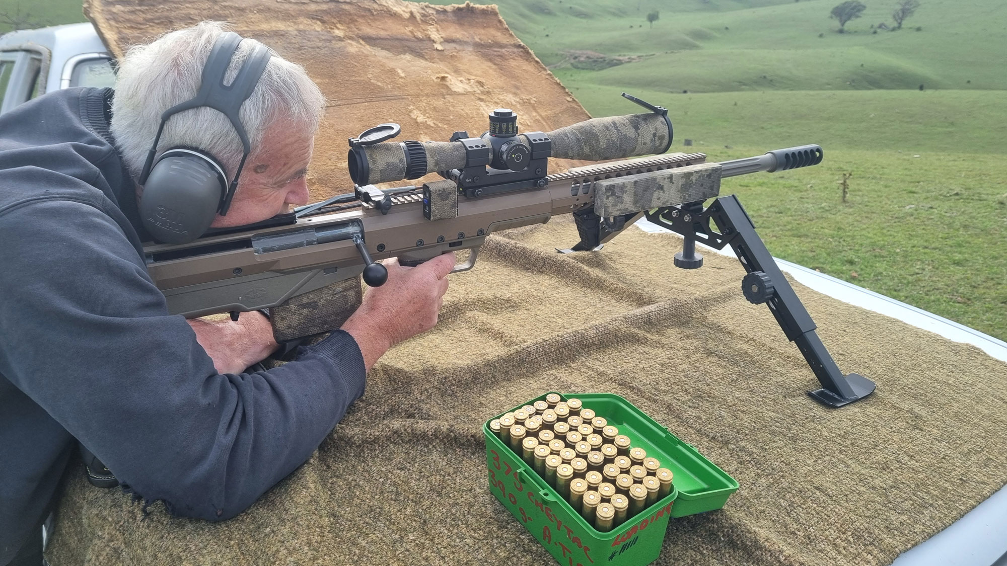

And everybody knew I was gonna say it, but consider the DT HTI for your base rifle
and...justifiably so .. its a superb ELR rifle!!
My mate shot this at 2500yds just recently with my 375CT..
