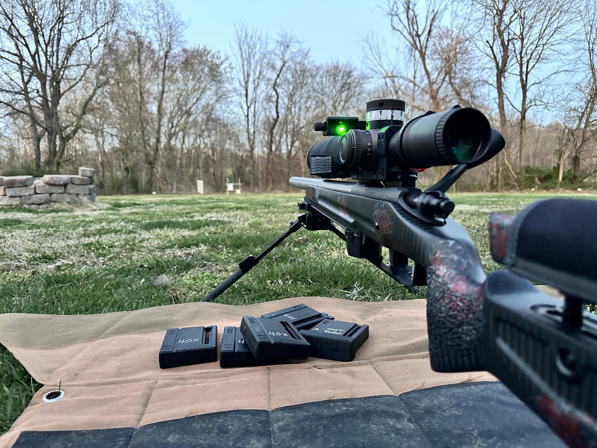

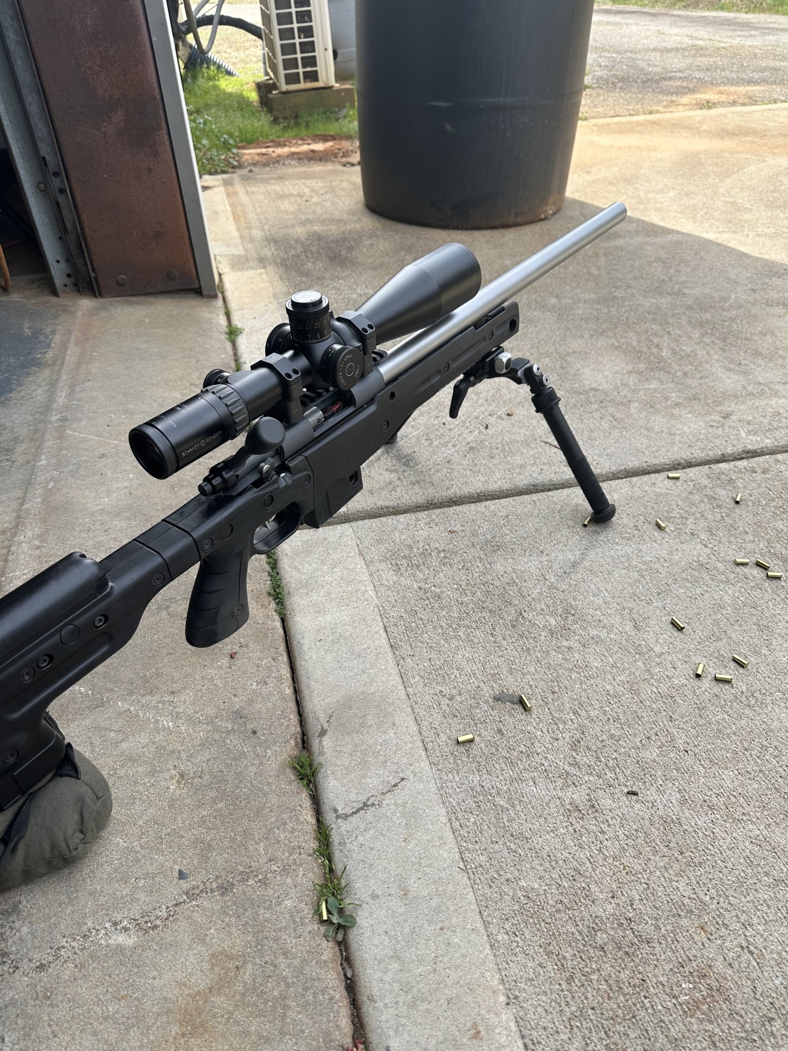

I have had my 40X in 9 different Stocks and chassis. I have a 1.2" barrel on it. Manners is my Stock of choice. MPA Matrix Pro and American Rifle Company XYLO are my 2 chassis of choice.
Pictures of the same rifle in a Manners PRS1 and OLD AI Chassis.

View attachment 8544604View attachment 8544605
