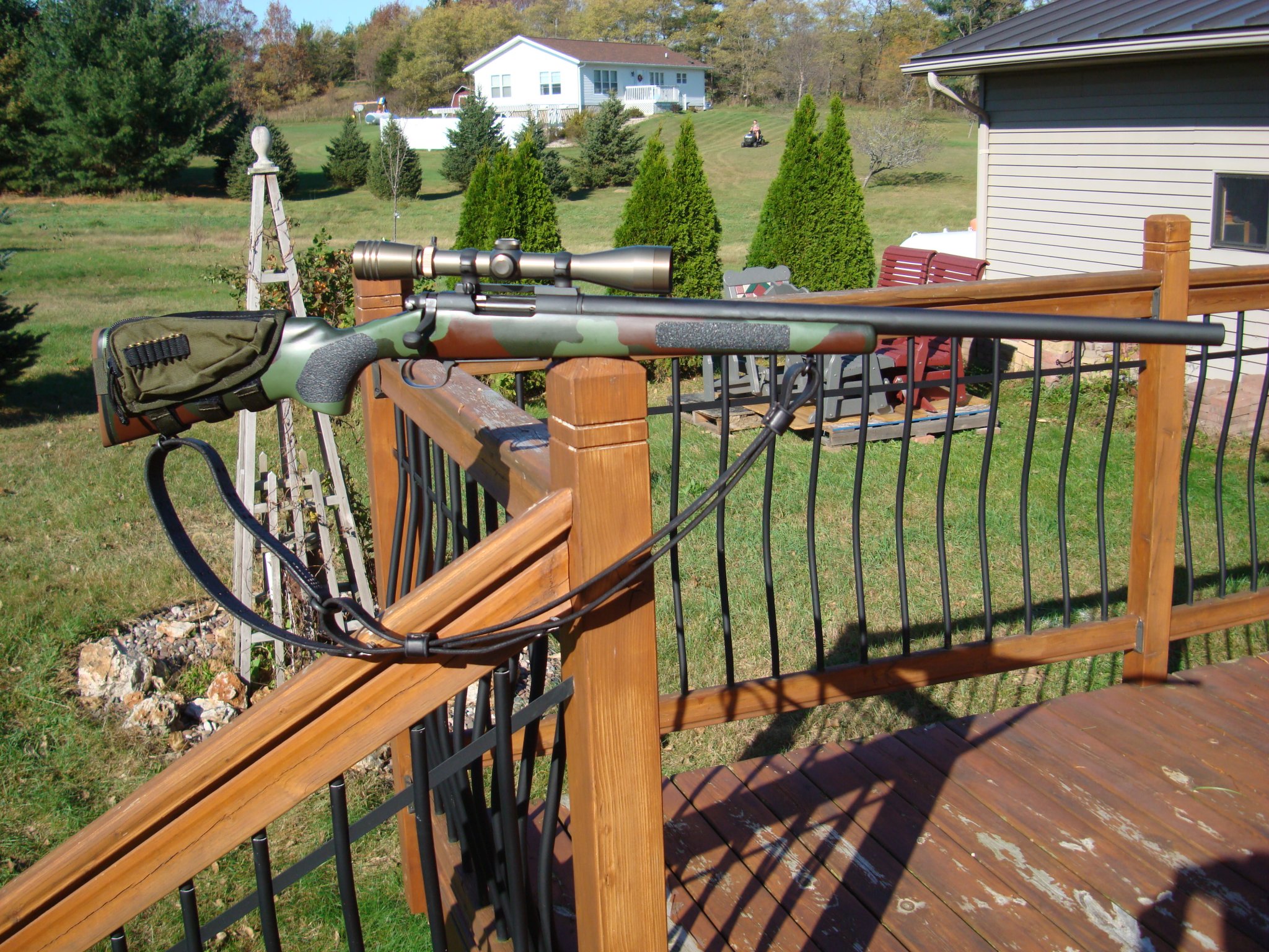

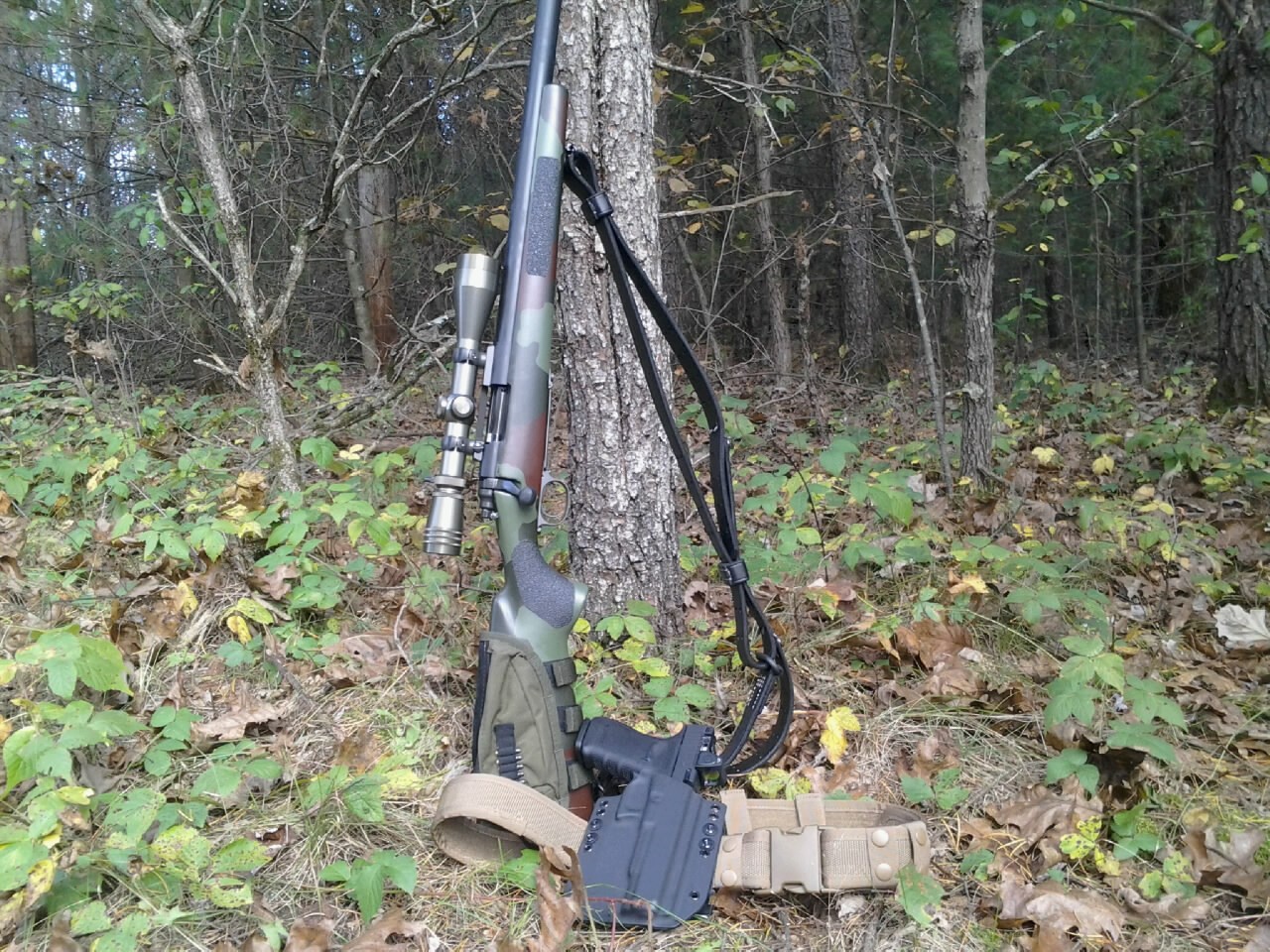

    I didn't convert mine into a repeater, but my 40X M40A1 .22 is my favorite rifle. It being a single shot really doesn't bother me at all... I use it small game hunting and range work on a regular basis. Please post up your completed rifle, I'd love to see it for sure!!

    Dude! That’s badass! I see you left the return stock pretty unaltered (Floorplate) I’m assuming that’s single shot?
    Its not a return stock, haven't been able to get my hands on one of them... I didn't convert mine into a repeater, It being a single shot really doesn't bother me at all. I keep spare rounds on my stock pack and its fairly fast to re-load. It has all the receiver work done to M40A1 specs and sports Winchester modified bottom metal.
