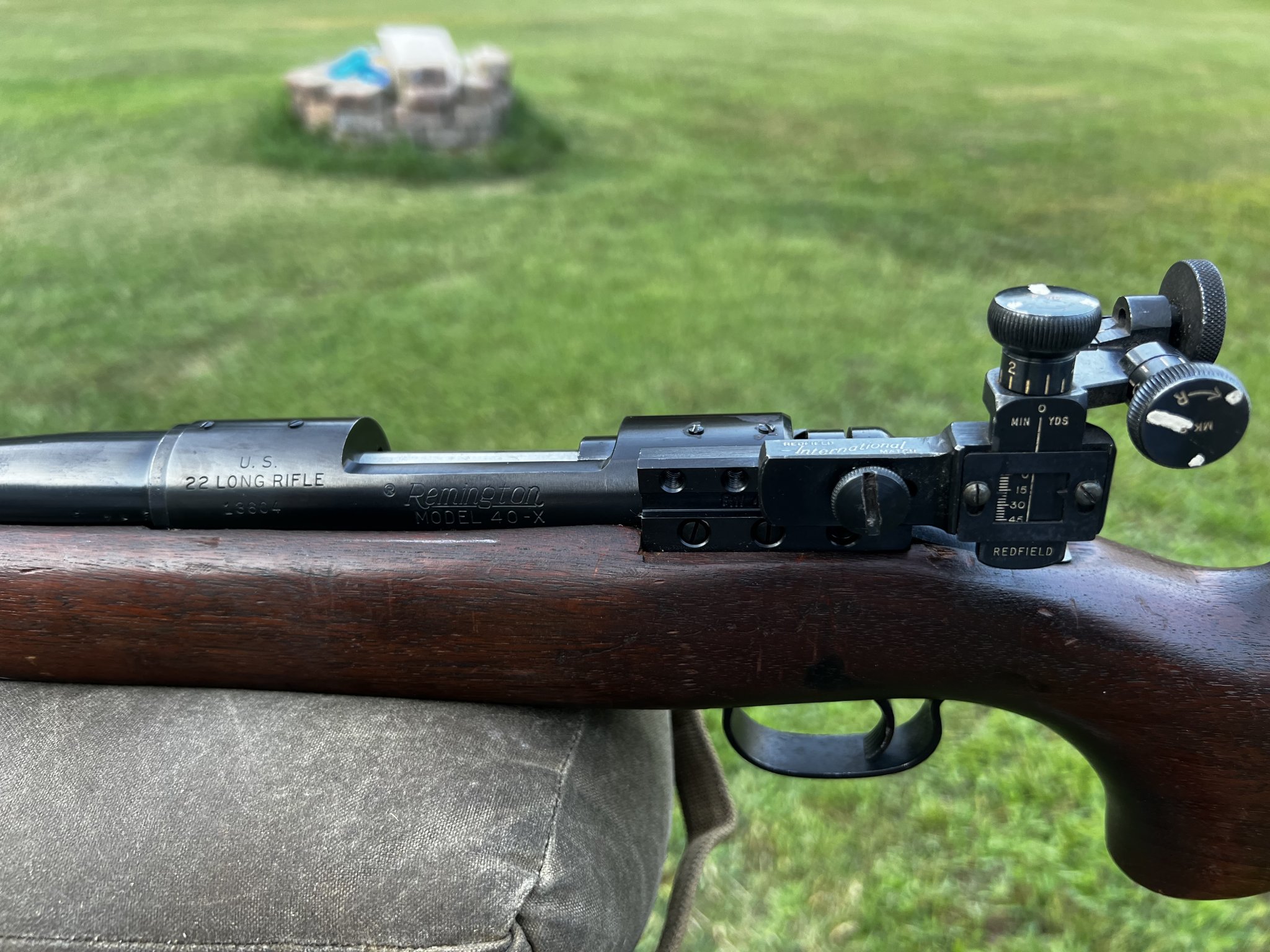

Just a suggestion: I compete in ARA Unlimited with a 1965 factory 40XB. Factory stock and barrel, Jewell trigger. BUT, when I first received the rifle I noticed some small gouges in the bore just inside the muzzle (borescope), probably made from the factory crowning reamer so I had 3/4" of barrel cut off and an 11degree crown lathe cut. It made a significant difference in precision.

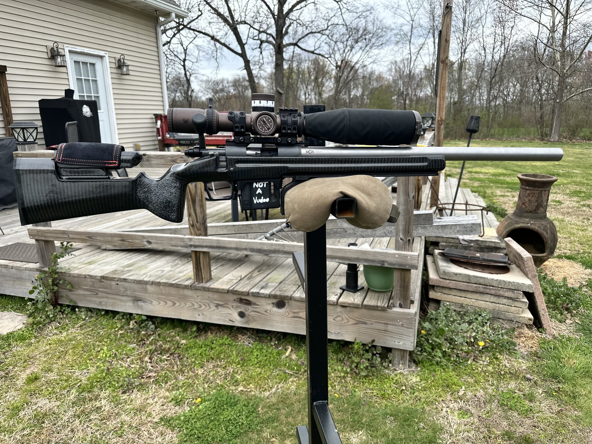

My original barrel shot just OK. I shot it with that for about a year and then finally had it rebarreled with a Lilja. Group sizes went about in half. The Lilja is not quite the equal of my Vudoo, but it's close. At some point, it'll get a Shilen, and I assume it will then outshoot the Vudoo.

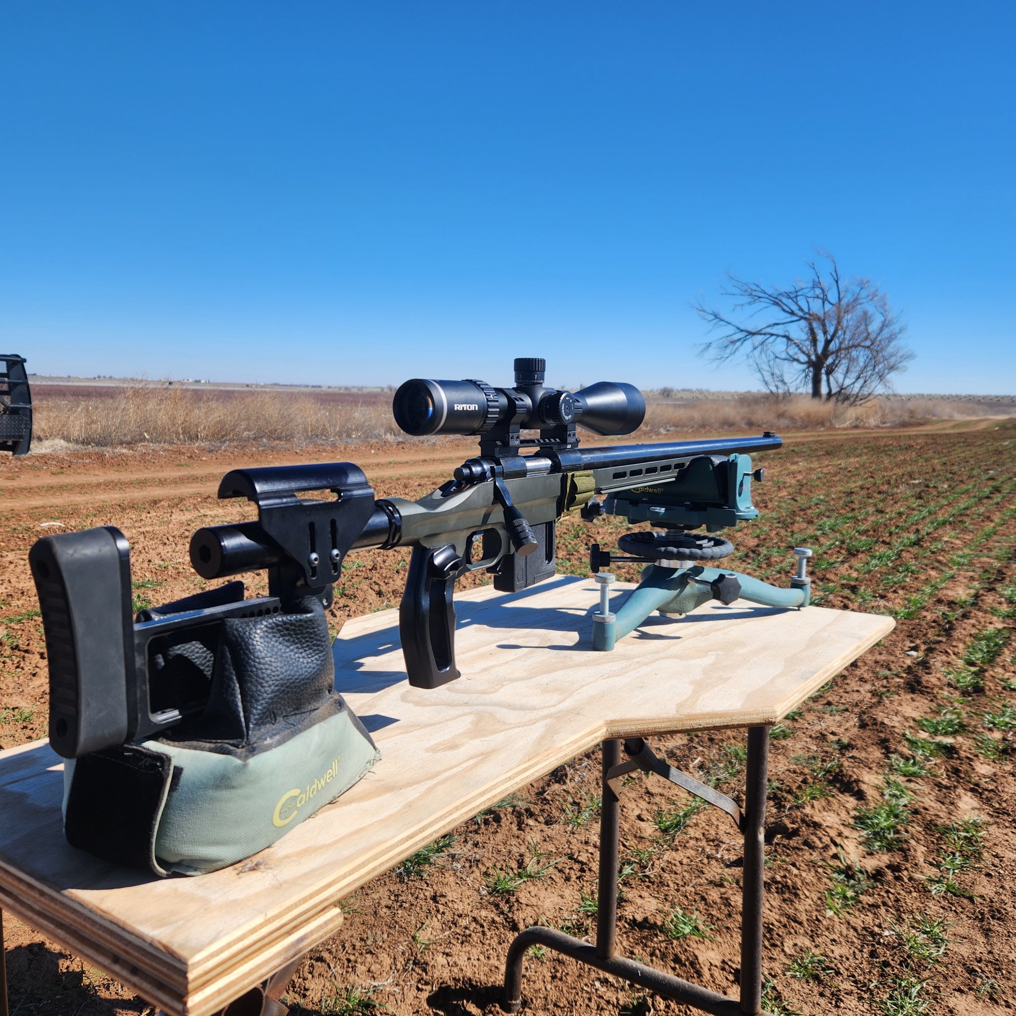

Here it is in a Indian Creek Design chassis. Using vudoo mags. Havent done the whole ammo test at 100 yards. Its just fun
