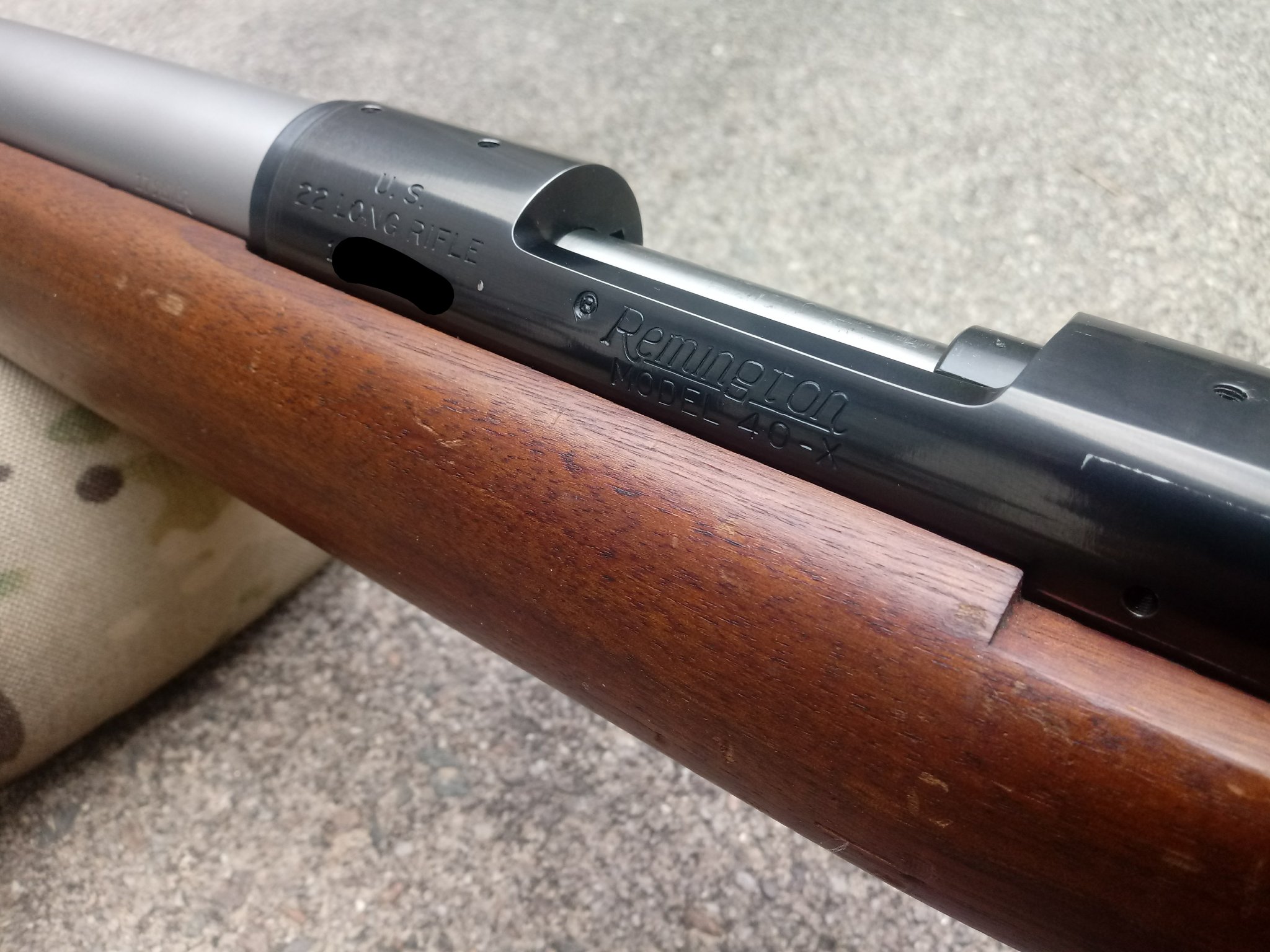

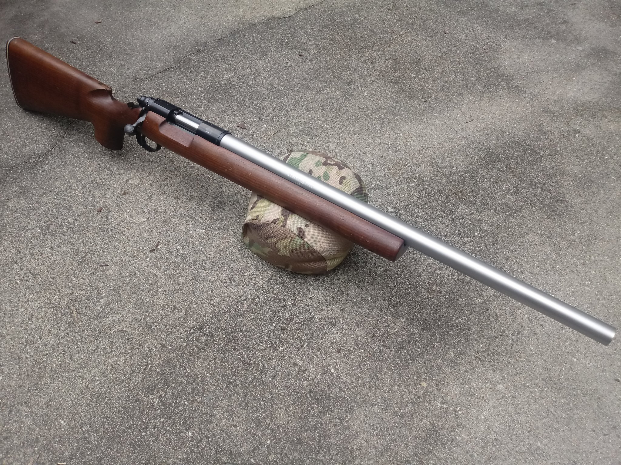

    Just picked up this rebarreled 40XB yesterday.
    It:
    -Is US marked (not USMC or US PROPERTY)
    -Has the original stock

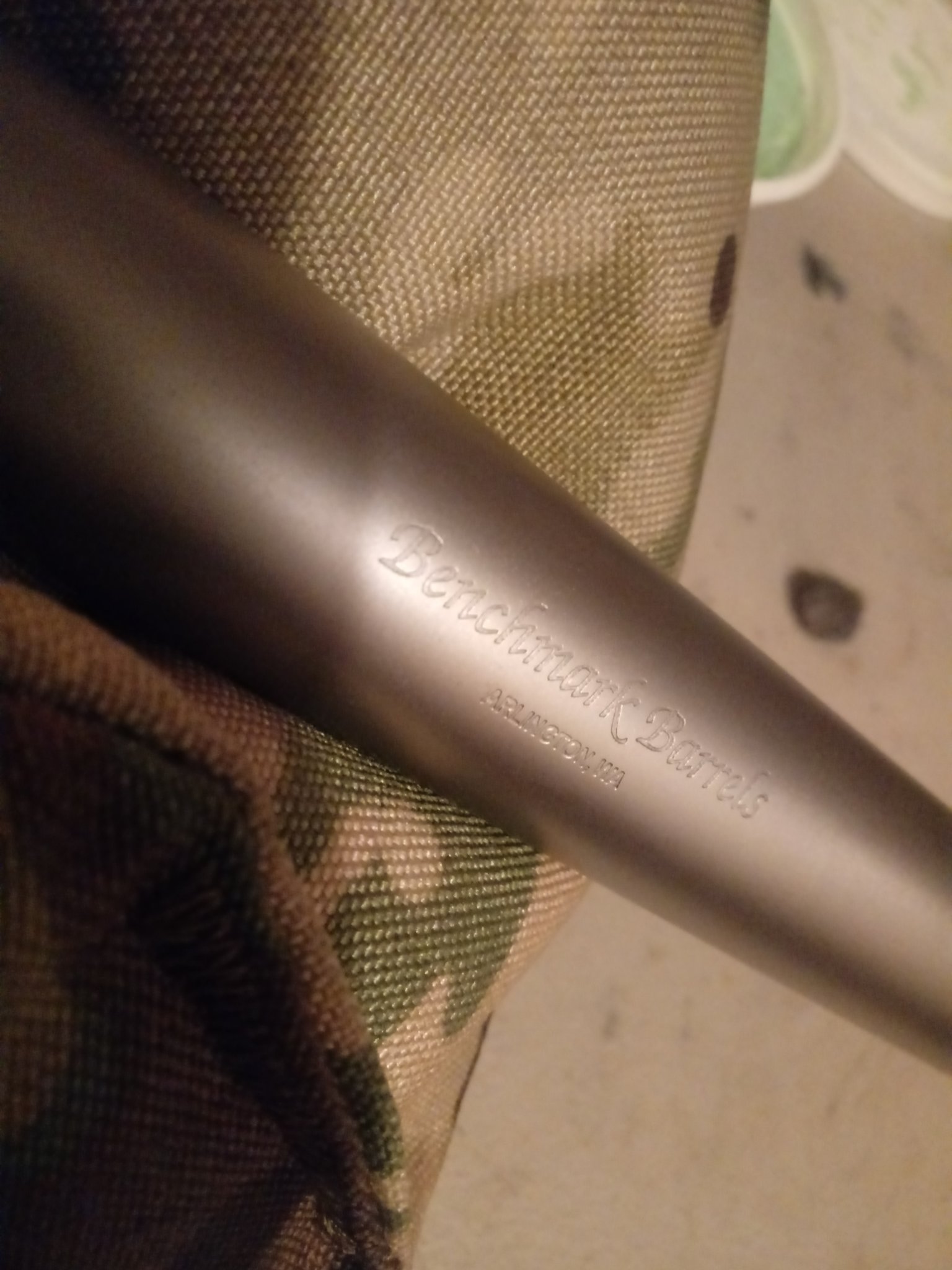

    -Has a Benchmark Barrels .17HMR 24" barrel installed (unsure of contour, didn't measure when I had it out of the stock)
    The action is in fairly good shape; light wear is evident on the side of the action where the rear sight lived. One small ding on the left side unfortunately.

    Quick way to tell the difference between a 40X and a 40XB is the bolt handle. 40X had a straight bolt with a round knob. 40XB has a swept back bolt handle with a 700 style knob.
    First thing to check is if the SN etched on the bolt matches the SN on the receiver. And, if you intend to run it as a 17HMR, it should be GTG. If you want to rebarrel it to .22 RF, the bolt face will be over-size for the HMR head. I converted a 40X .22 RF to .17HMR and had to open up the bolt face and move back the bolt stop and ejector to extract a live round. Extractors worked flawlessly for the 17 HMR.
    Reactions: camocorvette
    700 SA rails and trigger will work on them. I would keep the original trigger and have someone adjust it back to the weight you want.
    Will definitely keep the original trigger.
    This is a 40XB then; it has that 700 style bolt handle. That's actually part of how I IDd it initially.
    I would assume that the considerations for .17 HMR were made for the bolt face/extraction when it was rebarreled. It has definitely been shot since rebarrel...I'm hoping to run some of that info down today.

    I wasn't aware benchmark made .17cal barrels.
    I checked their website before I picked the gun up and noticed the same.
    I never heard back from the original owner (who put it on consignment) to find out who plumbed it all together.
    ETA: maybe it was an offering made previously and discontinued or special request/order?? I'm not as familiar with their brand so I can't speak to it otherwise. Unfortunately have no clue as to the age of the barrel or when the rebarrel was done.

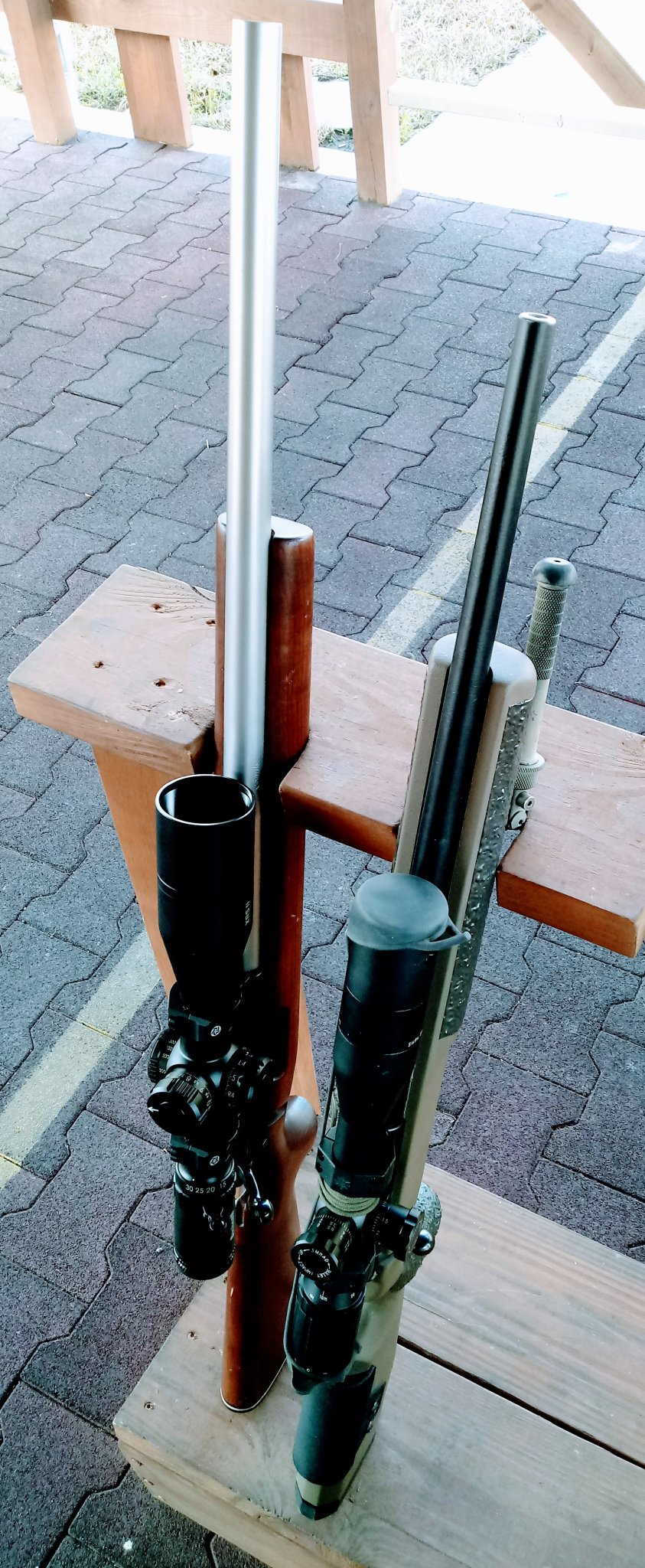

    Finally got to the range yesterday.
    Shot from sitting, 100 yards, 1" dots. 5 rounds per group, using each type of .17HMR I've got on hand. Using a Wiebad bag up front for support. Haven't actually measured them yet.
    The wind wasn't quite a factor here as it was on some other groups I shot with this rifle beforehand, or with the groups out of the 452 shown below.
    What's interesting is how the groups slowly climb over the course of shooting them...the POA was dead center of the dots each time. This was also shown on a 15 round string (3, 5 round groups) of the 20gr FMJ I shot (and ended up rather windblown).
    So, I'd say confidently that the climbing nature isn't based on ammo type to type...it was consistently doing so.
    Also took my CZ 452V (bedded in a Manners T4) and re-zeroed it. Shot some groups in the same manner as a sort of "control" to show same shooter, gun to gun (same conditions). But, shot with an Atlas on the rifle for stability.
    (ETA: these groups in the first image do reflect a little more wind...the second image was a little earlier when it wasn't nearly as strong. POA was on the corner of that orange square. Those are 1" squares.)
