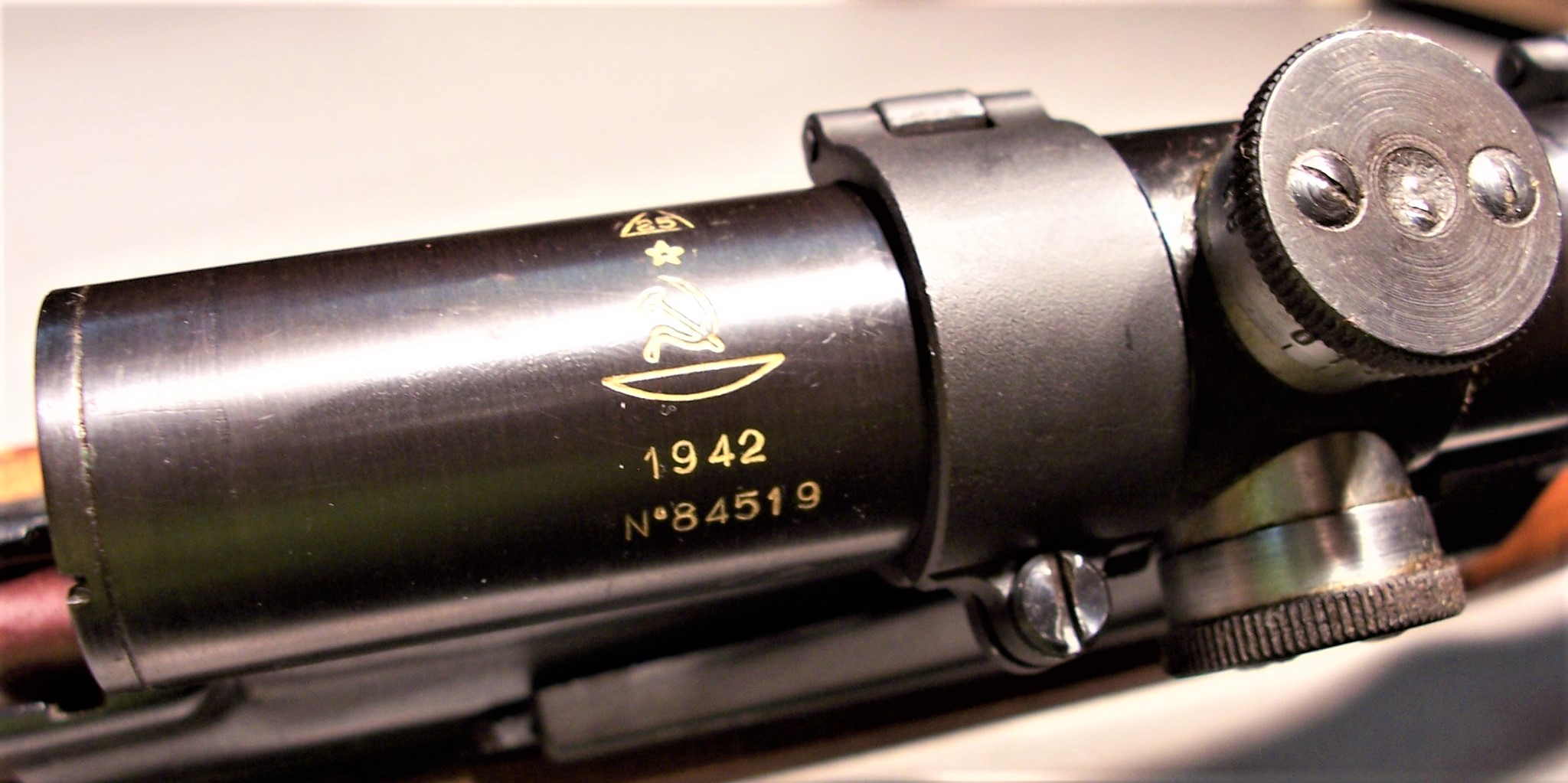

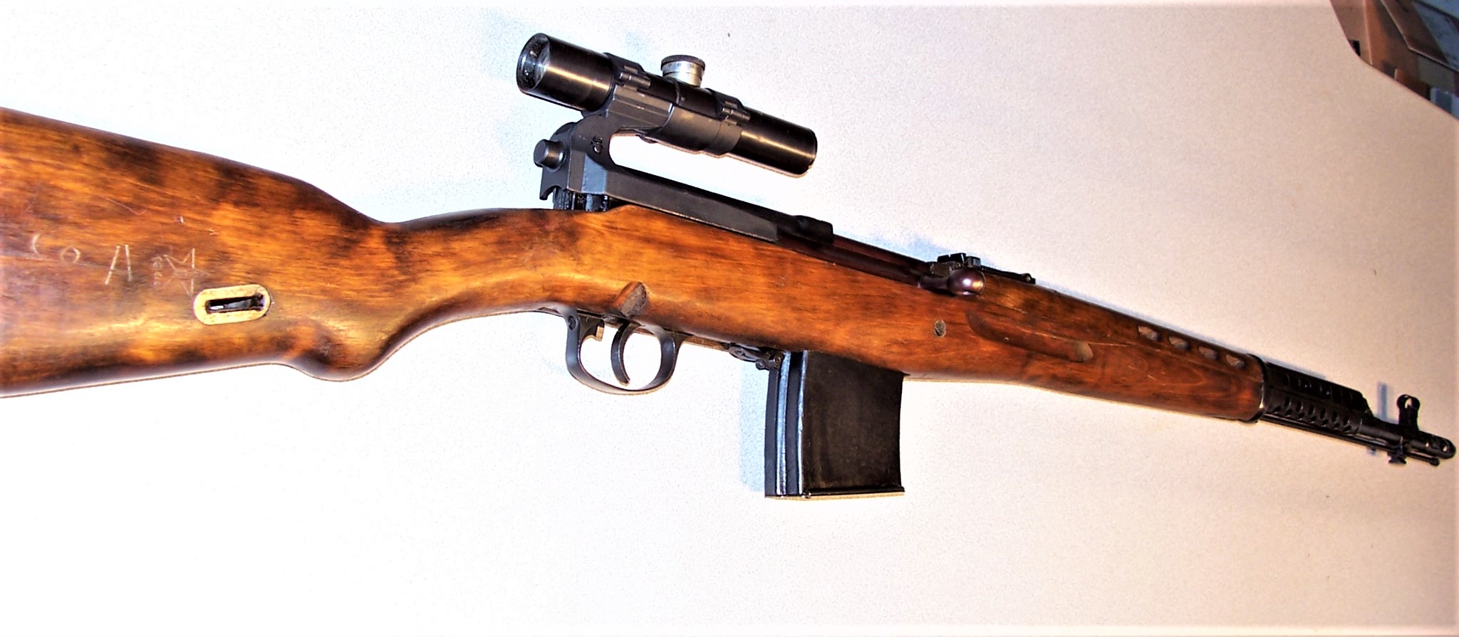

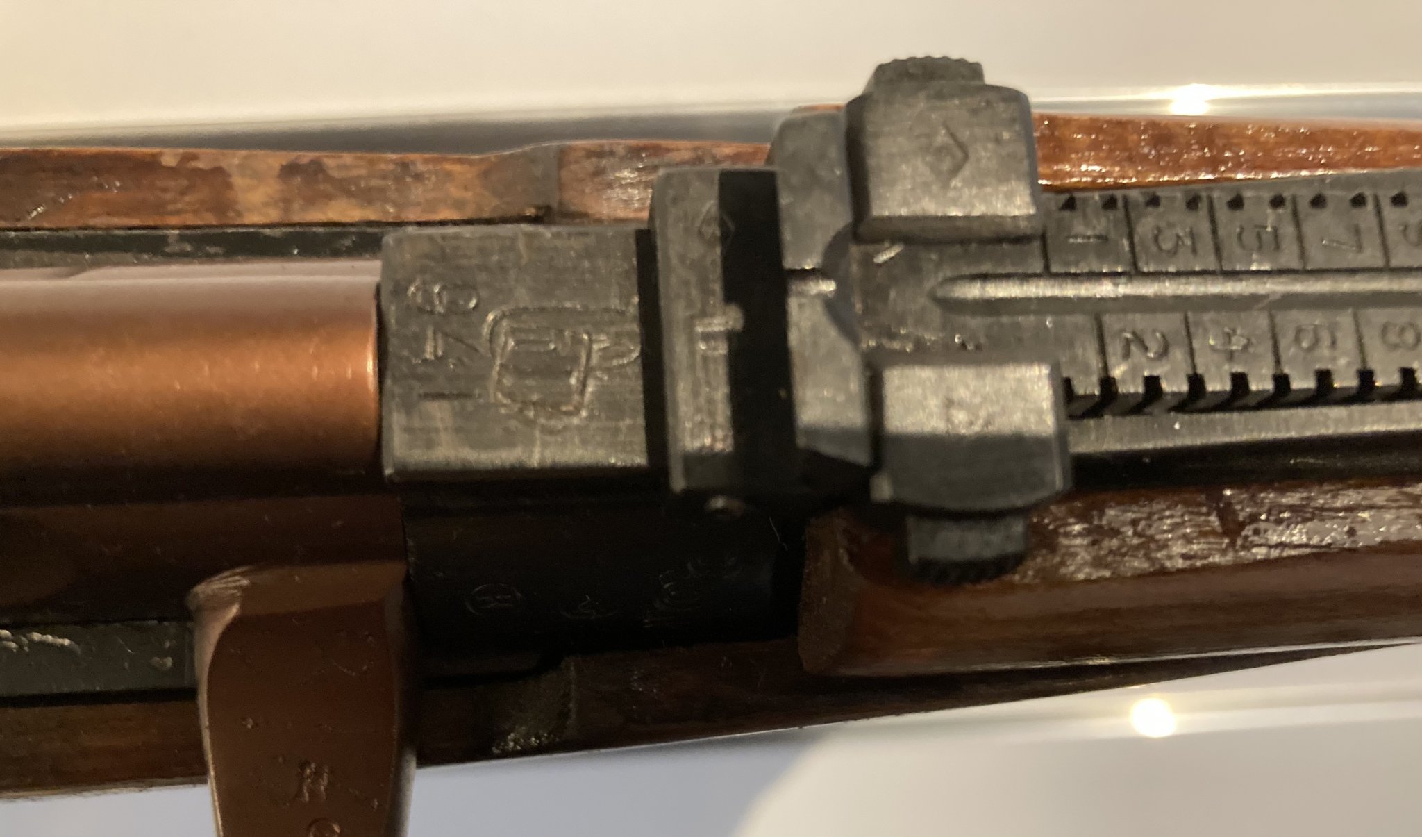

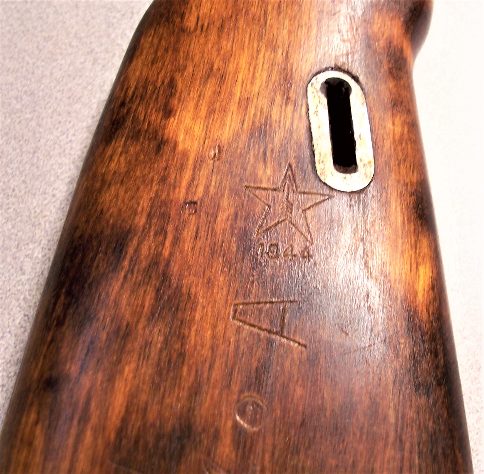

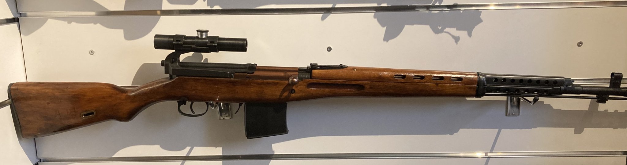

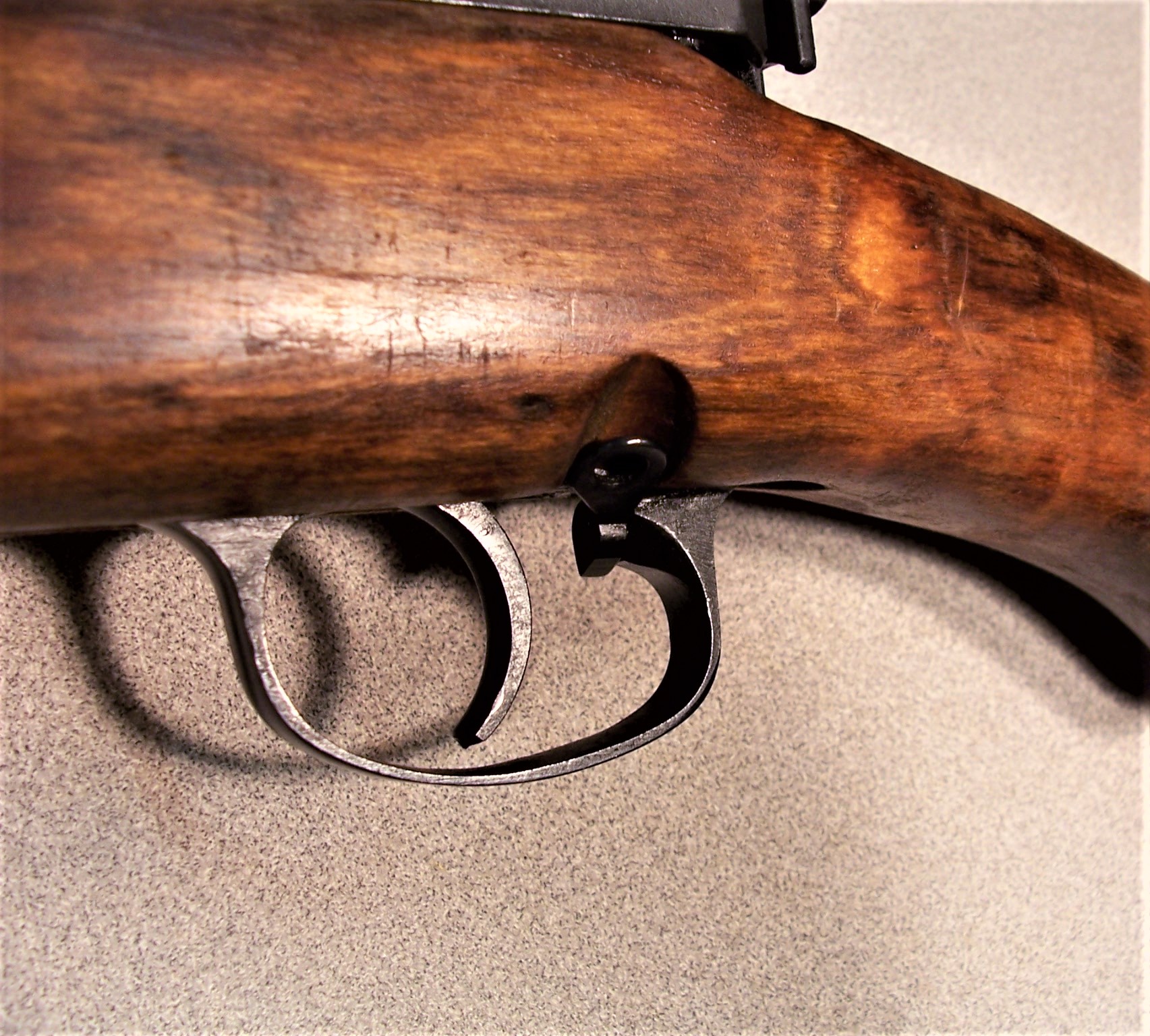

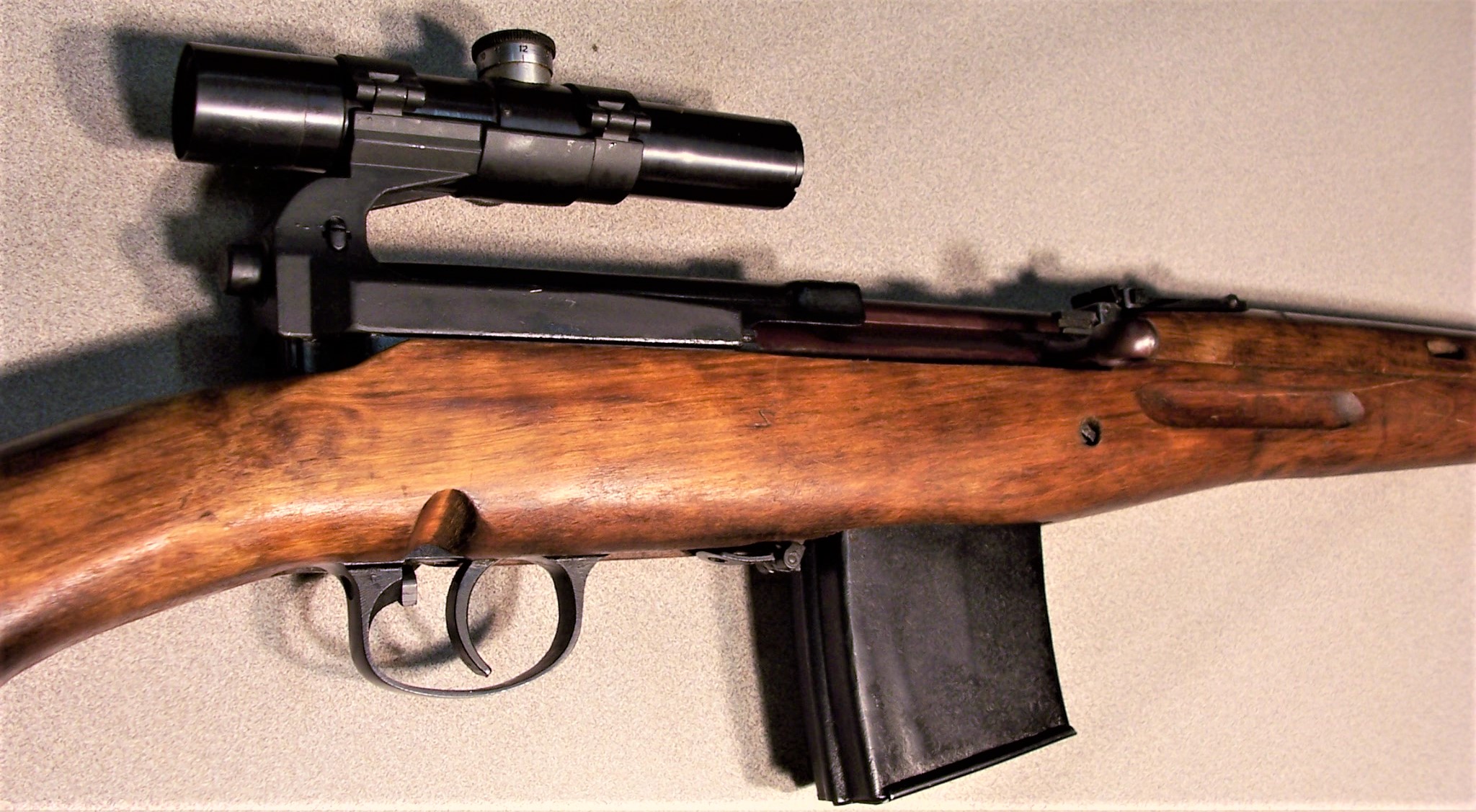

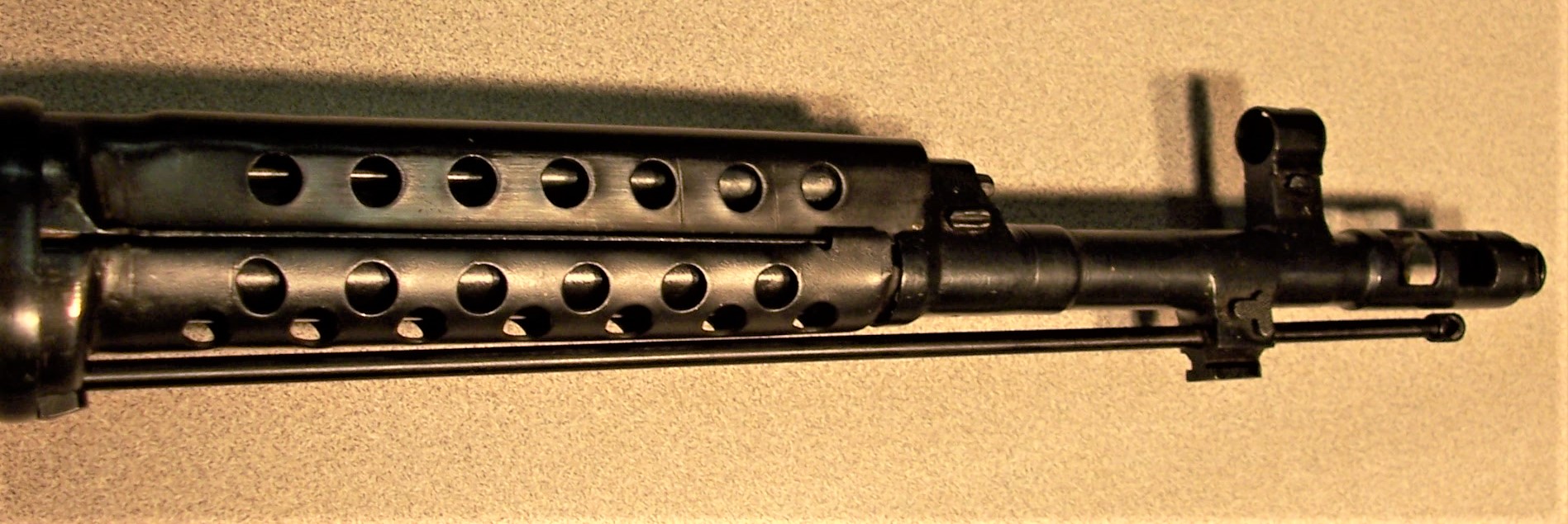

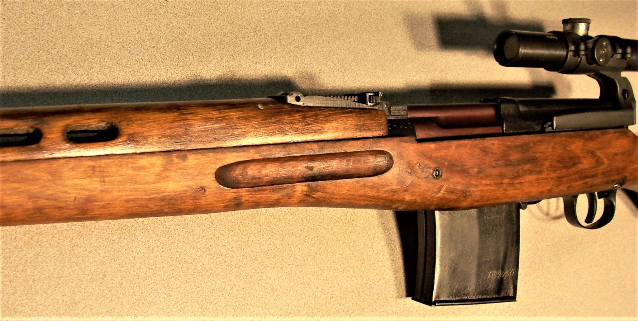

Picked this one up a couple of years ago before the prices went through the roof. During refurb the rifle was put into a 44 Tula AVT "Naval" stock (A) due to SVT stocks being prone to failure at the wrist. Mount is a reproduction, legit mounts are rare and expensive, even the chewed up dug up ones. Have shot it using it irons but have yet to try an dial in the PU scope.

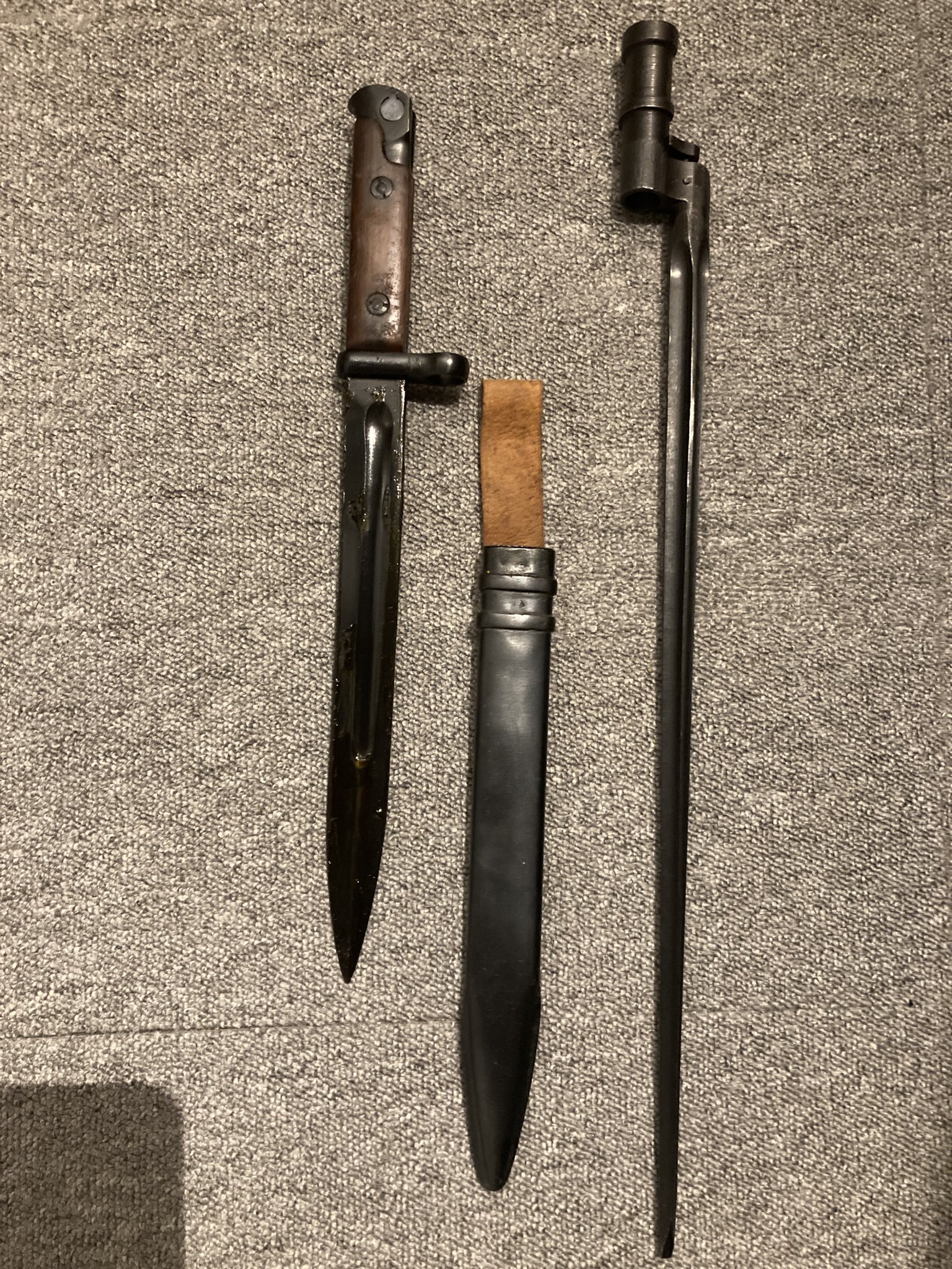

This rifle (and the SVT-38) were called the Russian Garand, but they were considerably less rugged and indestructible than the USGI Garand. Treat it with respect and don't overcharge the loads. It should use the same bayonet as the 91/30, and like all Russian rifles at the time was intended to be used with the bayonet mounted, otherwise POI will likely be off to the left quite a bit. Try to avoid messing around with the front sight, the bayonet belongs there. Contemporary Russian infantry doctrine forbade removing the bayonet except when being transported.
