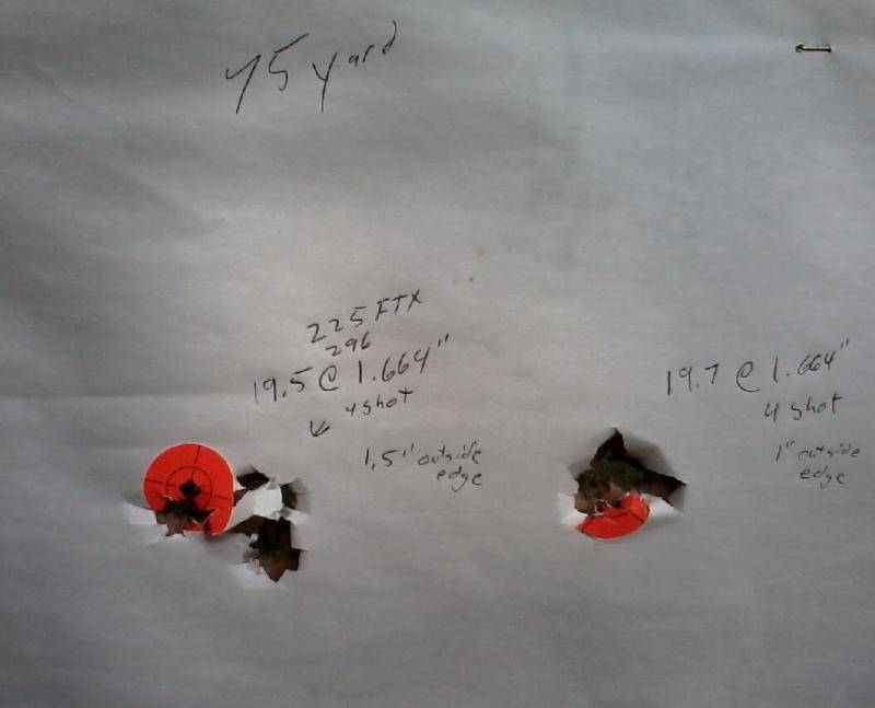

I use either H110 or AA2400 and the 240gr XTP for deer hunting with the 44 out of a rifle. It's an outstanding close range round. I have not shot the 225gr FTX, but I would be a bit concerned that it would get too frangible at rifle velocities. I can say you see a significant difference with the XTP but it still performs.
