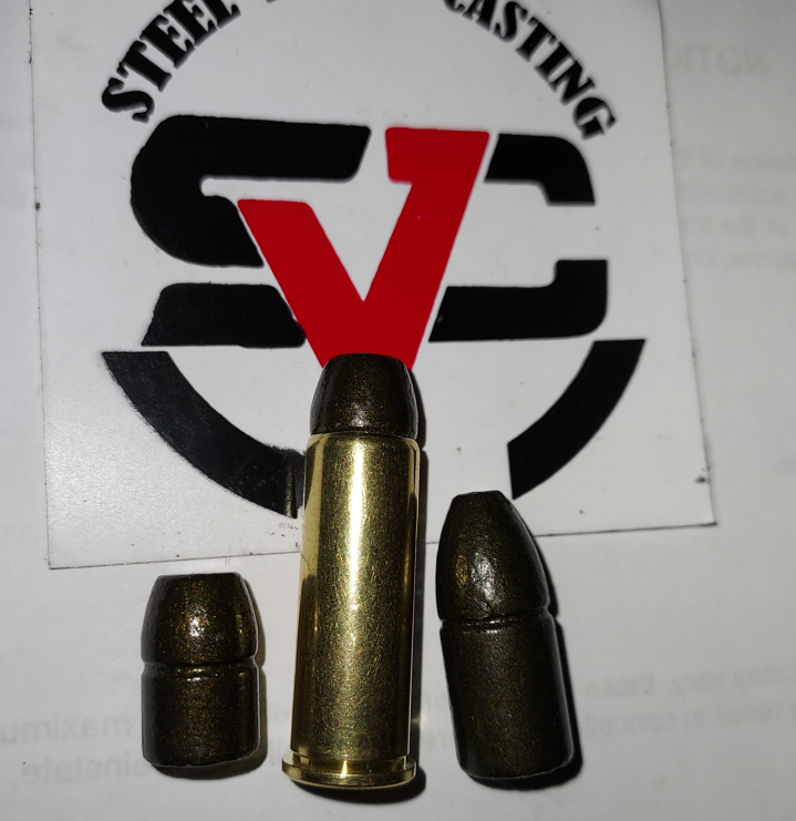

I'm waiting, waiting and still waiting on a new Ruger Marlin 45-70. Based on my results with Steel Valley Castings .358 and .431 Hi-Tek coated bullets, I'll be trying their 405gr bullet in the new rifle. $68.00 shipped for 250 of them. Their 44 Mag 240 gr bullet (pictured left and middle) is my go-to round. Accurate and VERY good velocity. I can send you a few of the 405's to try since sadly I can't do anything with them at the moment.
Reactions: SmithM21
