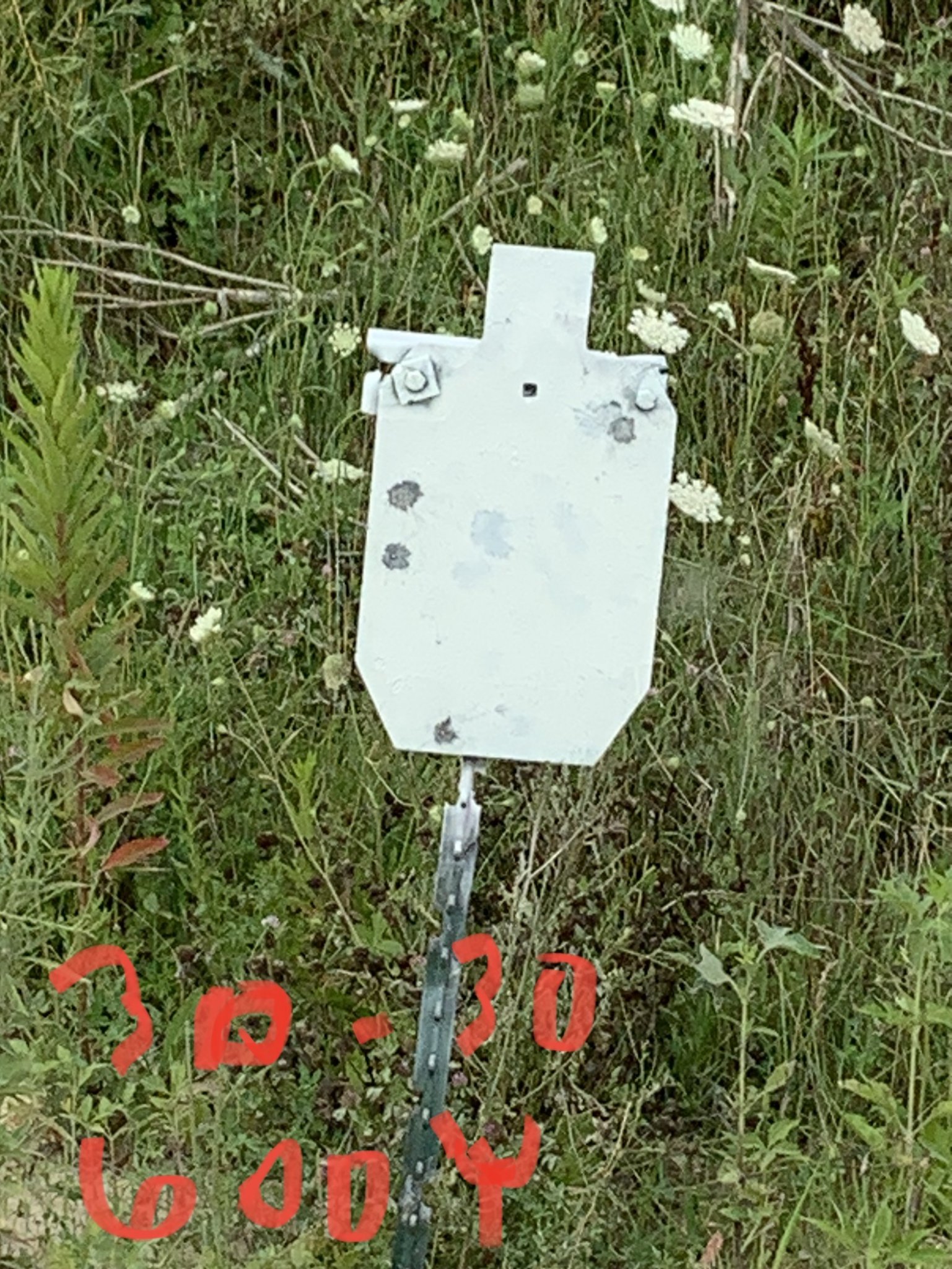

I hope to get my Miroku/Winchester 1886 to 600 yards in the next year. First, I have to figure out how to lighten the very heavy trigger and what peep I want to use. I’m not a fan of tang sights and there’s that stupid safety in the way of all the good veneer sights, so I’m considering the Providence Tool Lyman 21 reproduction. I’m trying to figure out if it even has the elevation for that distance.

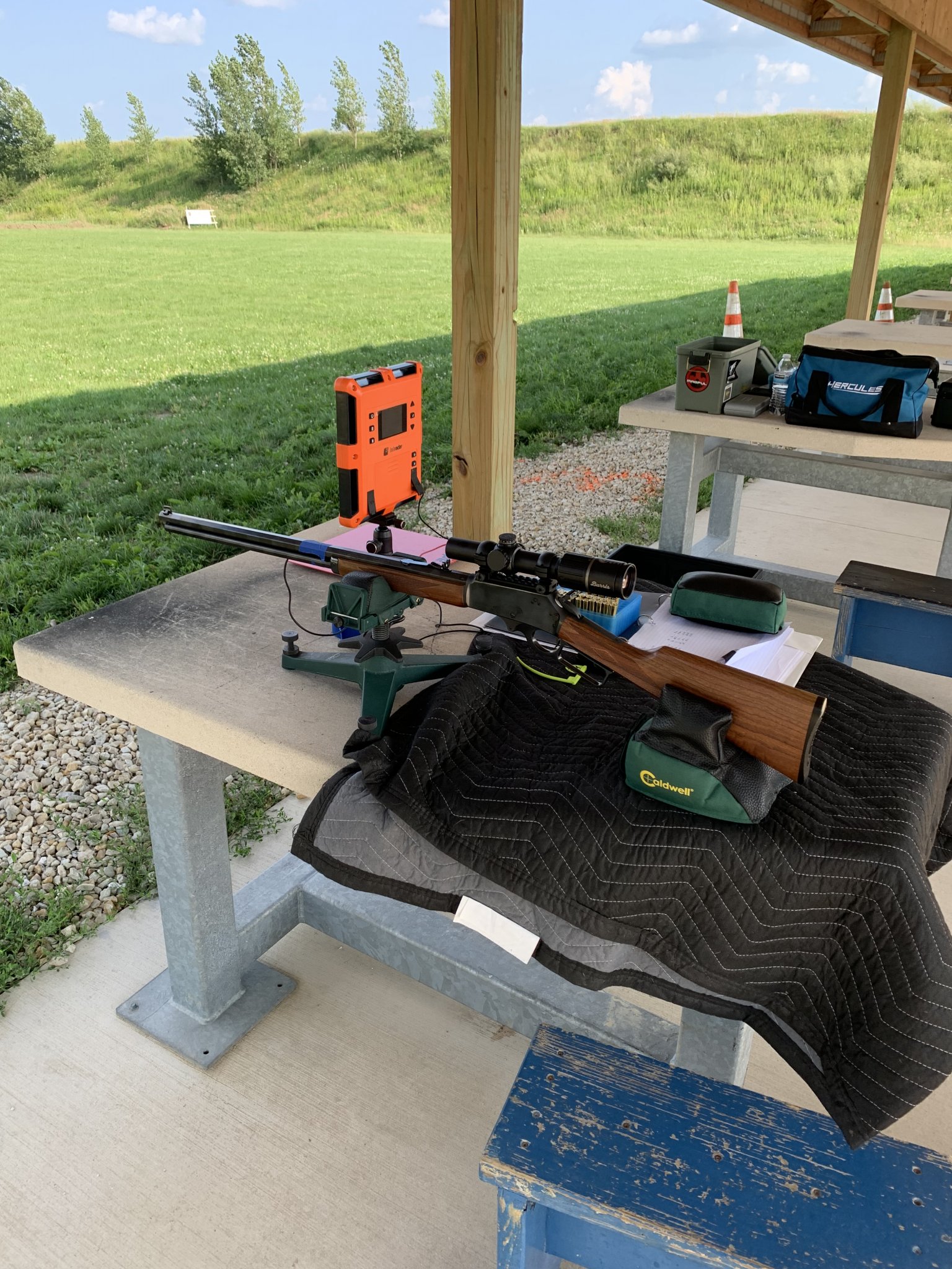

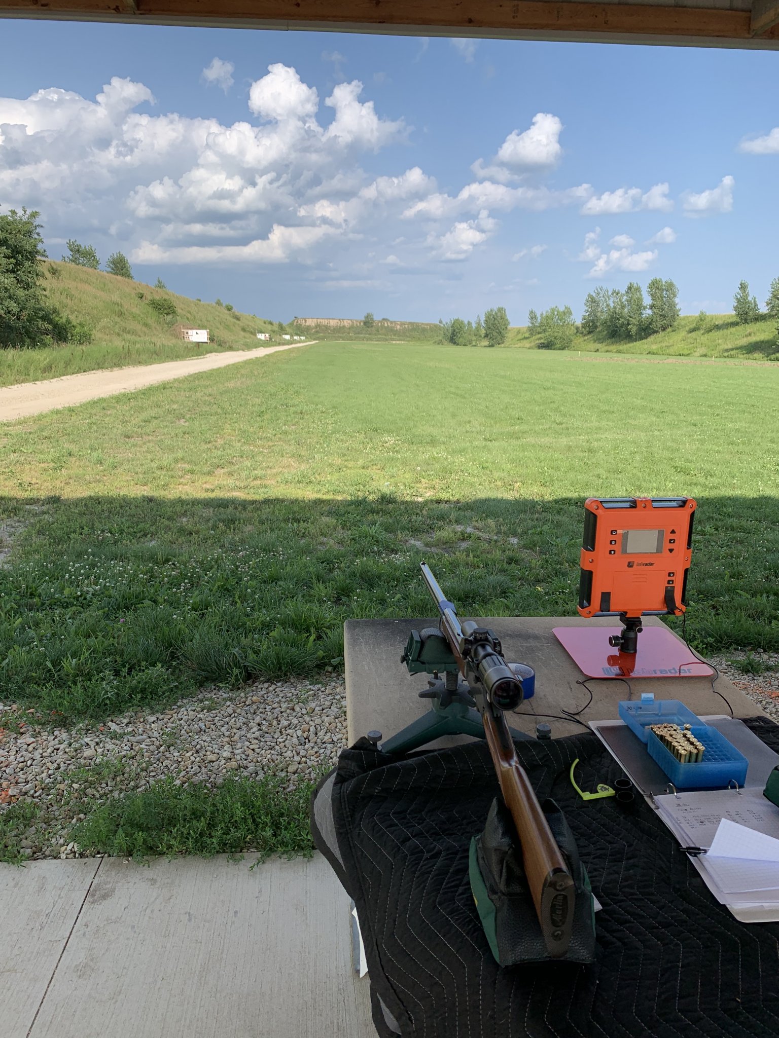

I have no doubt you will get to 400 yards with your 45-70. Earlier this year, I got to 600 yards with my Marlin 336 Cowboy 30-30 with a 1-6 Burris scope. I was using Hornady 160 FTX hand loads. I hit the target in the photo below 4 out of 5 shots. I wish I could put videos on here as I have some cool slow-mo videos taken through my spotting scope of the bullets going down range and impacting the target. Strelok indicated that with a 200 yard zero, I needed to put the scope power on 4x to be able to use the bottom of the vertices post as a aiming point at 600 yards. It was spot on. Now that I know it’s potential, I’m trying to see how far out I can get with open sights. I‘ve sense removed the scope and installed a Williams receiver sight with target knobs and a Skinner Guide Partridge blade front sight. This will give me a some idea of what I can do personally. After that, I plan to see how far I can get with my 1886 and a good old 405. Gotta love this hobby
Reactions: 45-90 and Modoc
View attachment 8235001.
View attachment 8235007 View attachment 8235009

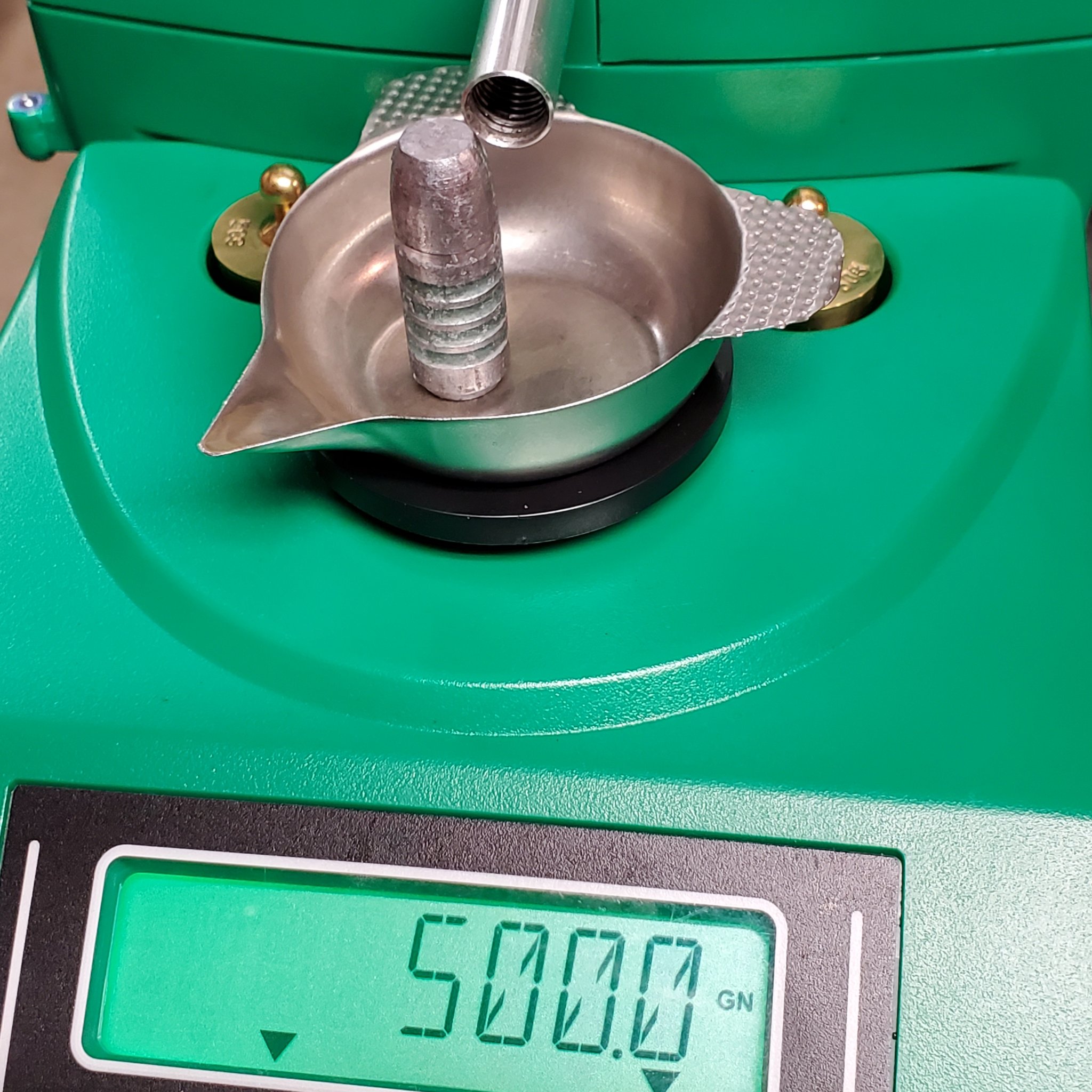

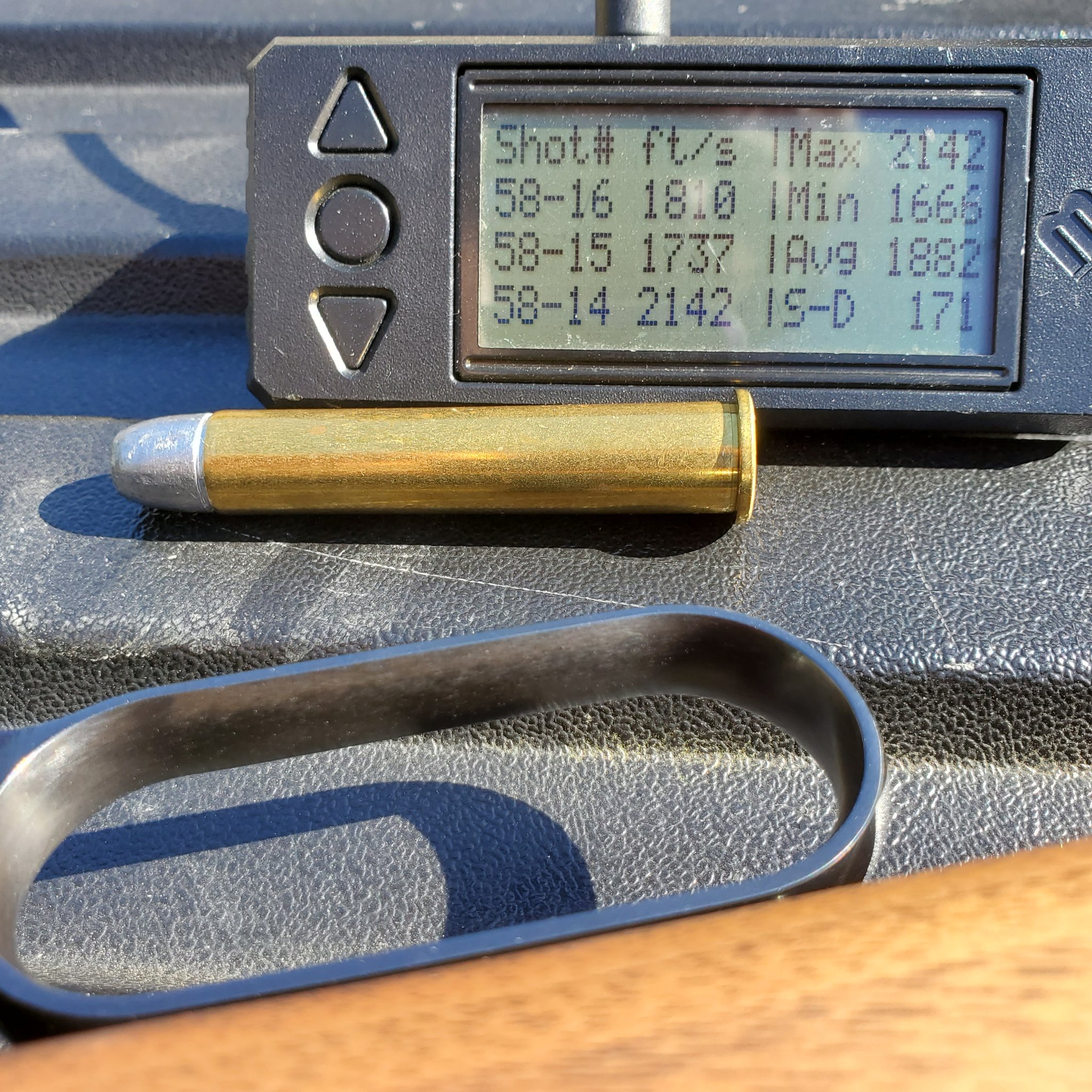

Here is a photo of 1886 45-90 Win chronographing some loads 1810 fps 500 gr cast was fun for awhile...but the recoil is pretty heavy with the steel crescent butt plate...1200 fps is pleasant and all ya for LR target. The 45-90 is great for shot shells and multi ball loads.
Then there is the Rossi 454 16" shoots 240 gr at 2300 fps & 300 gr at 2000 fps from a 16" barrel.
Also fun 400, & 405 gr resized .458 bullets in it...500 gr jacketed did not stabilize...but a fun a experiment. Still enjoying these old lever guns, along with the modern ARs...
