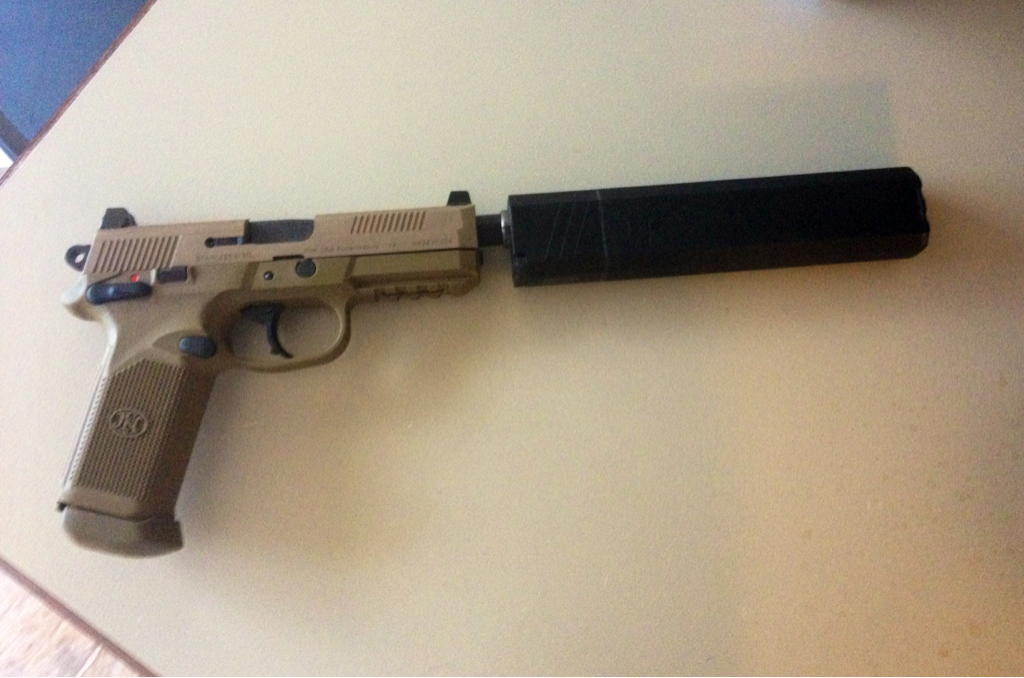

I tried both and bought the TiRant. The Osprey worked fine on my Glock 21 with Heinie straight eights. I don't know if running them on a 9mm platform is the difference or what. I did my research before I bought and am happy with my purchase.
Osprey 45
I have no experience with the TiRant, but I have to say that I am VERY pleased with my Osprey, even in sub-caliber use. So far I have run it on an FNX 45T, and a Glock in sub-caliber (.40 and 9mm). There IS some first round pop, but even in 9mm it's still hearing safe (running 147gr ammo). Really, shooting suppressed sounds like using an air nailer... like you're working on your fence or something.
