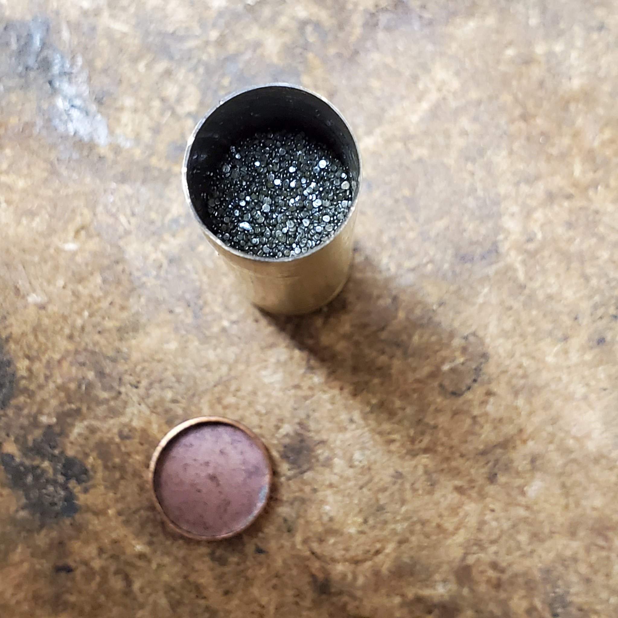

I have tried all maner of low pressure recommended shot shells in pistols and rifles. Melted out lead 147 gr fmi to replace with small shot to increase the effectiveness of 9mm.
But the high pressure loads of 60,000 psi were never tried.
Problem with shot it takes up a lot of case volume, leaving little powder room.
BB especially.
Disclaimer
I do not own a 45 Raptor, and am not really interested in your endeavor as it is fought with problems.

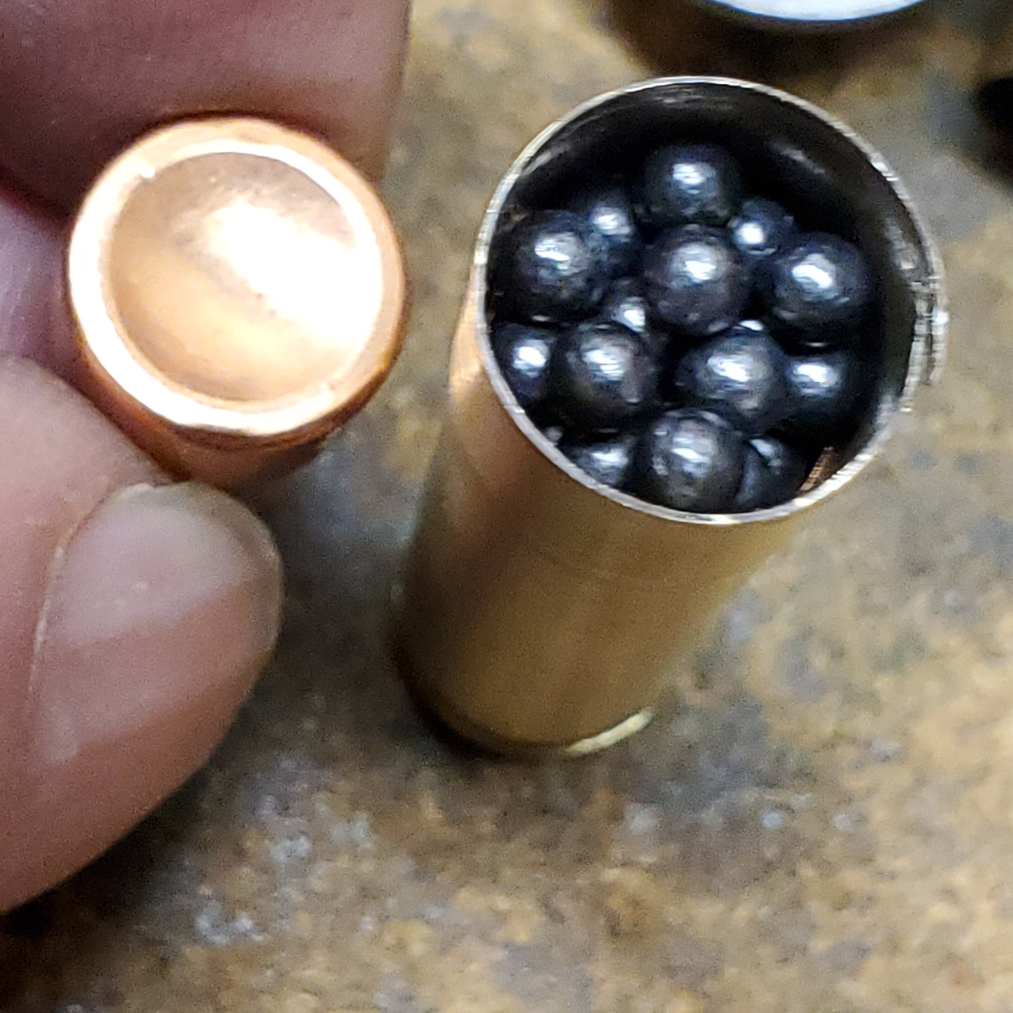

But out of curiosity I did make a 45 Raptor with #4 lead shot topped with a 185 gr hollow base (to get more shot in) bullet.
Here is what I did make a 45 raptor out of 308, cut to 1.8" anneal, straight out neck with expanding mandrels.
Load with 39 gr H110
Seat a 45 caliber gas check, with 40 lbs of pressure over the powder.
Add 20 pcs # 4 LEAD shot 63 grains by weight.
Add 185 gr bullets seat in place... used 454 carbide sizing die which puts a lot of neck tension on the bullet to hold everything in place. 2.170" COAL
It's about 1900 fps in a 16" barrel.
The shot is riding on the rifling bore, spinning wildly with the bullet, it will spread out fast especially at 1900 fps for thin patterns, if any strike the target at 10 yds.
What happens pushing those lead pellets up against the bullet at much higher pressures than designed.
Would the heavy tungsten shot ding the sharp edges of your riflrng the first time out.
I'd only do this project with a scrap barrel, start with normal shotgun pressure, bore scope the barrel, if heavy shot tears up the rifling at 1100 fps... no use for further testing. If not proceed with caution, working up slowly, and bore scoping each time.
If you do not have a lot of experience and common sense I would abandon this idea and just use a shotgun.
But if you must here is one way to proceed.

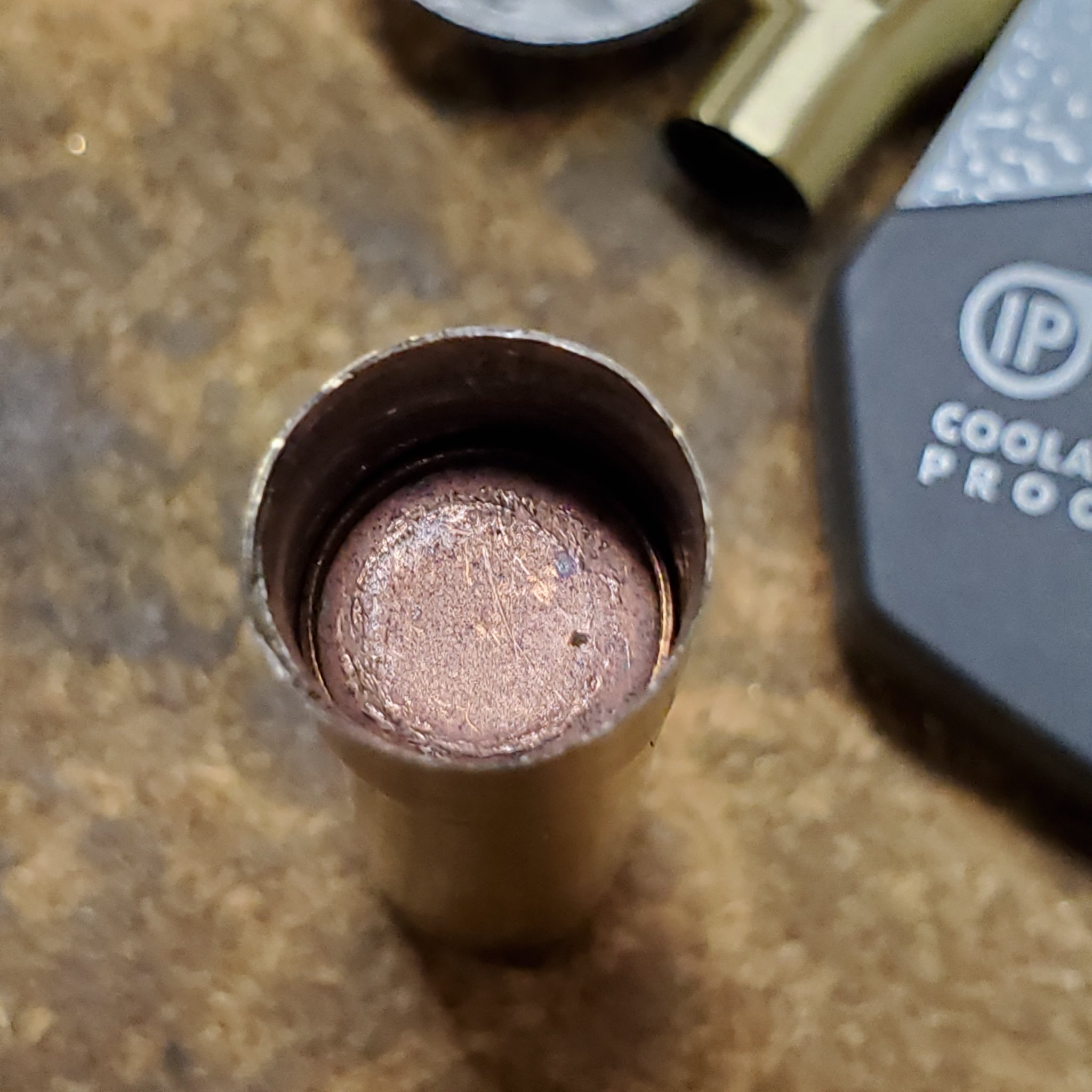

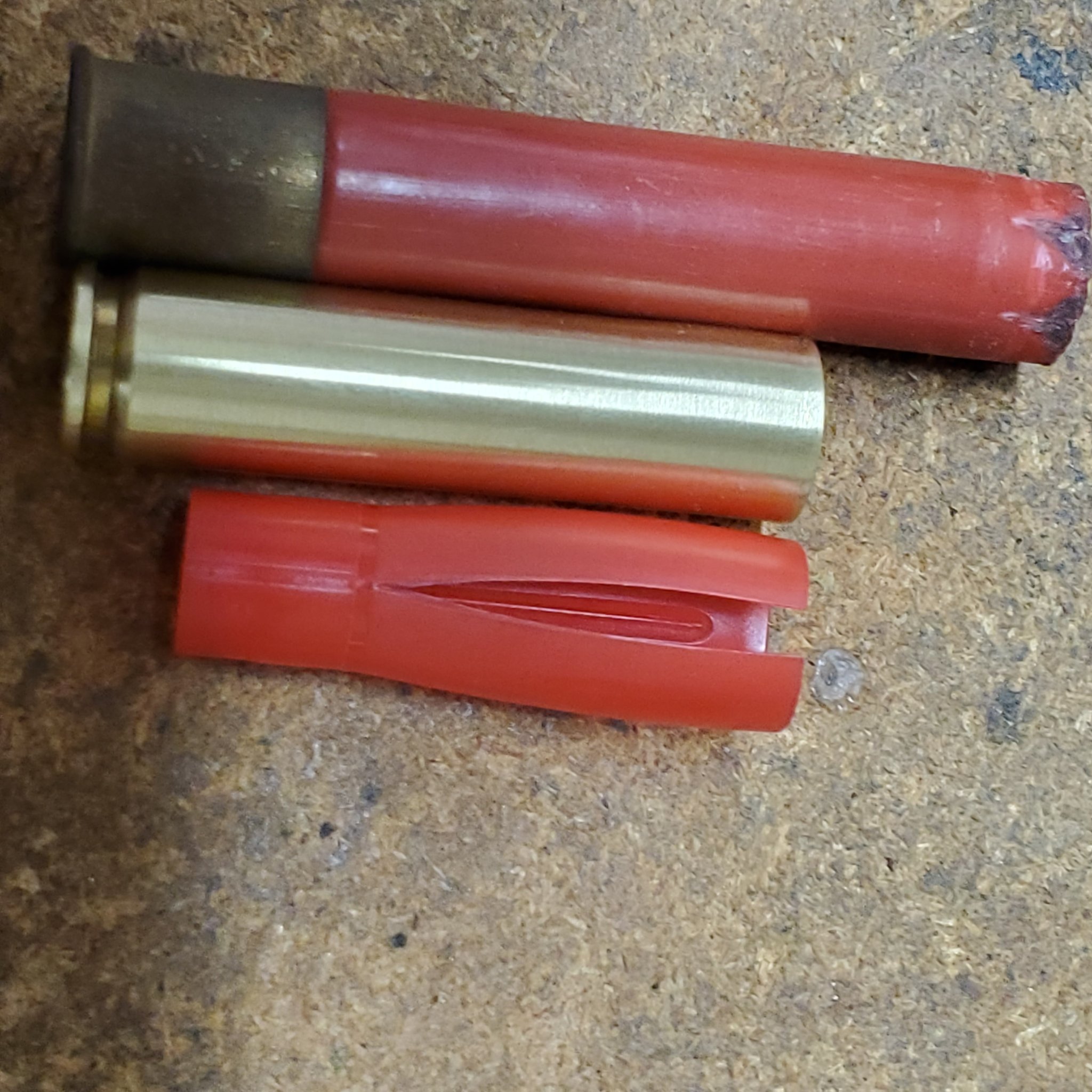

.410 shorgun, for comparison, you can see you have little capacity even compared to a .410.
The powder added takes up 70% of the case, to get to 1900 fps in a 16" barrel.
Added Hornady 45 cal gascheck with pressure.
Then added 20 pellets of #4 Lead, enought shot for a compressed load when bullet is seated...notice the hollow base bullet.

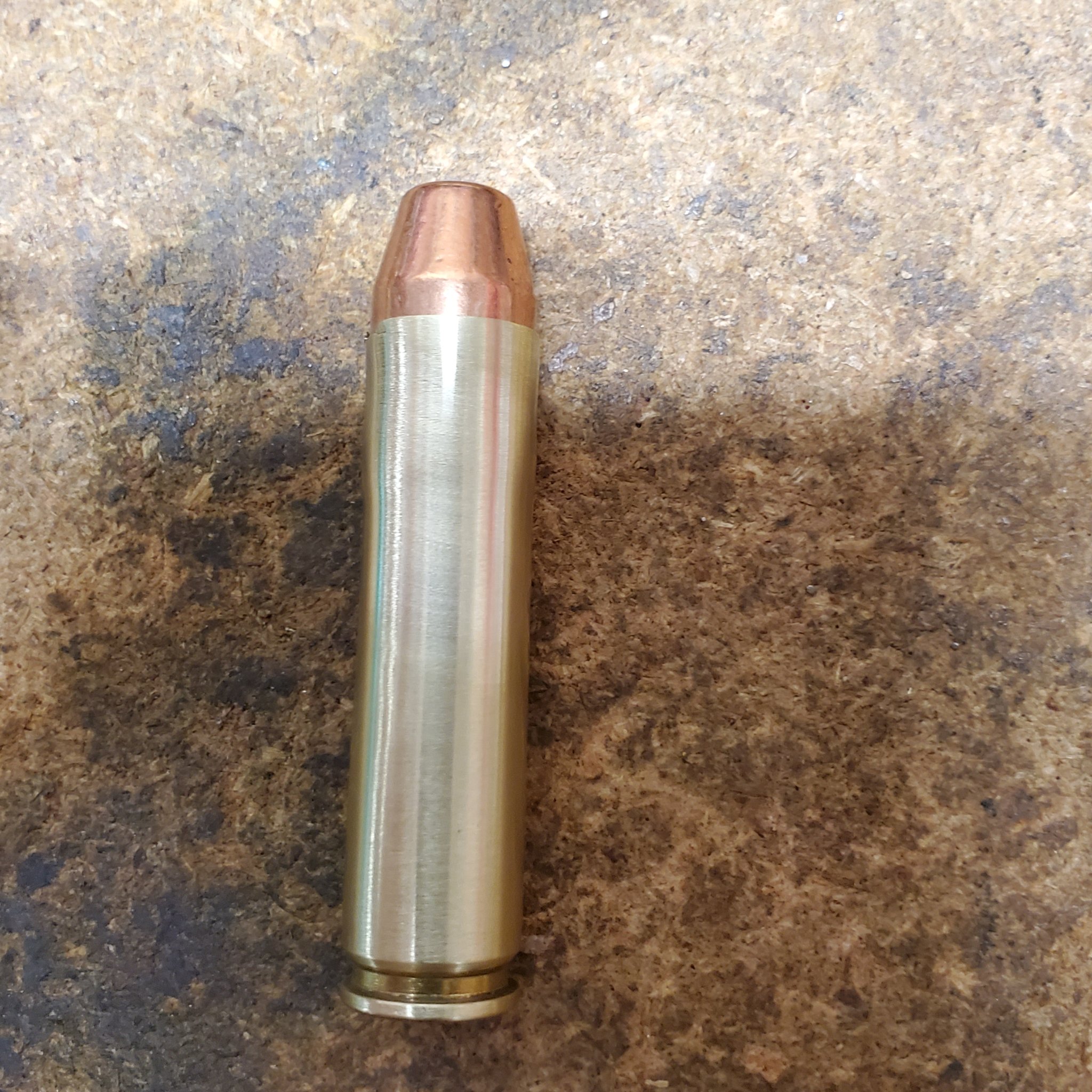

Here is the finished product 45 Raptor shot bullet combination.
I could try it with lead shot and 1100 fps area cause I have loaded this type of ammo in the past.
But Not with tungsten And Not at 1900 plus fps.
If I was gonna do it, I'd try it with lead shot first.
So I caution against doing it.
But I wasted my time showing how it might be accomplished.
But this is better than being in the dark completely, If you insist that your gonna skate on thin ice.

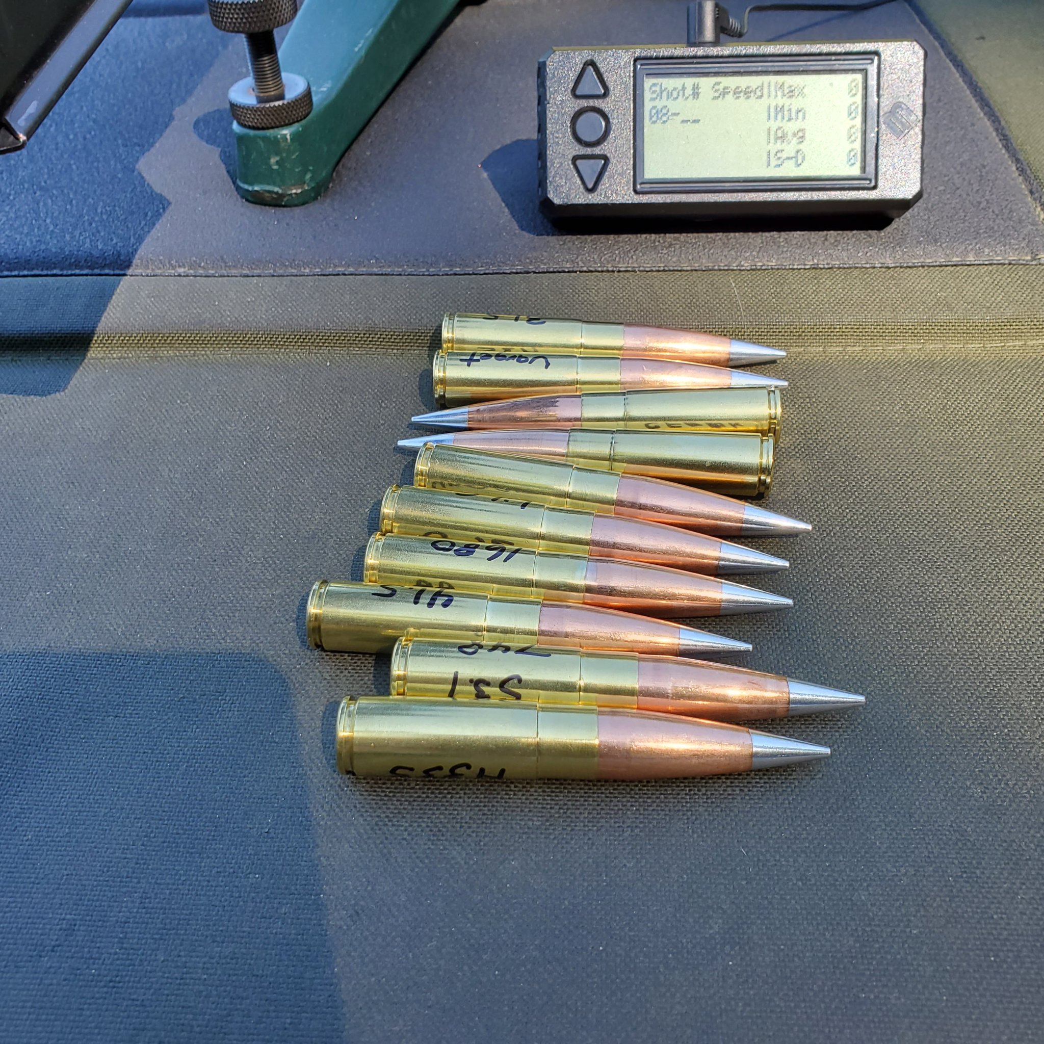

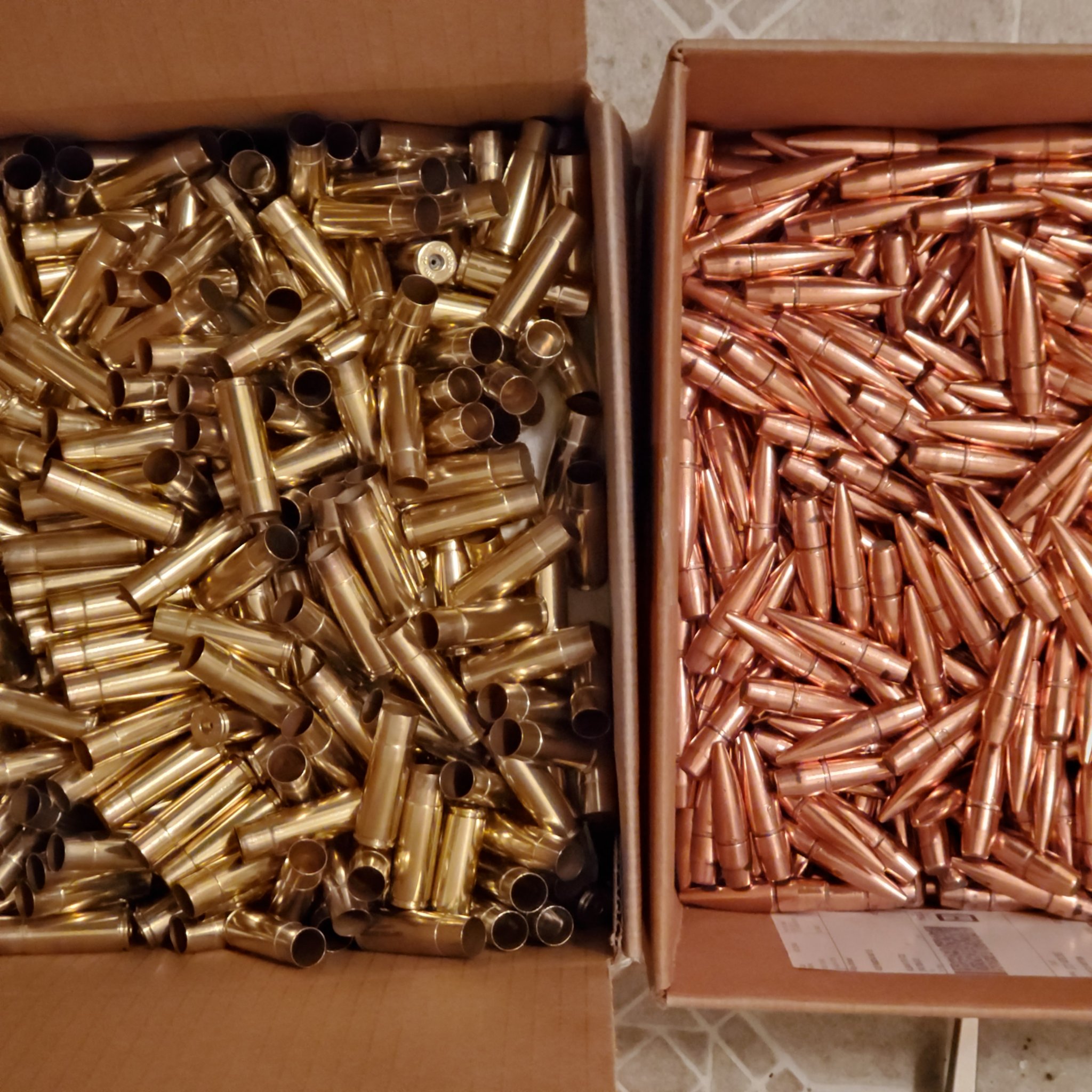

Just got bullets for "my" project, 11 boxes of Barnes .510" bullets.
Yeah, just to see how fast I can push them, then drop back for accuracy if needed.

I'm working with the 510 Whisper. Subs and supers. It really a fun caliber, just finished up making 700 cases for it.
It shoots 620 gr subs that explode on contact driving a hardened penetrator on through, made for 50BMG. Also 650 gr fmj and 750 gr Amax. 1002 gr lathe turned bullets are available with subsonic loads 1100 fps that put 2000 ft/lb of energy on target at 1000 yds.

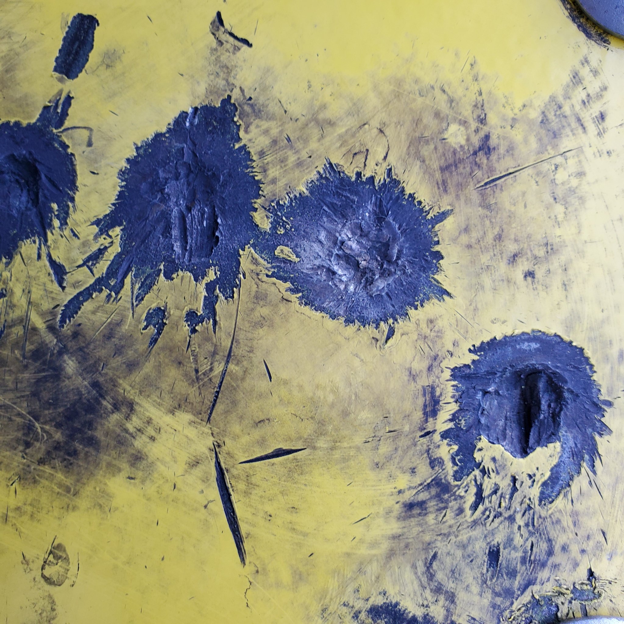

Here is AR 500 plate at 100 yds with velocity about 1200 fps it starts to penetrate the Armor plate at only 1400 to 1450 it gets with the program and really beats up my new armor 500 plate.
These silver points are 750 gr Amax for LR.
And 700 newly machined 510 Whisper cases and 500 bullets.
The new bullets that just arrived are for high velocity testing hoping for over 5500 of energy.
So that's my newest project.

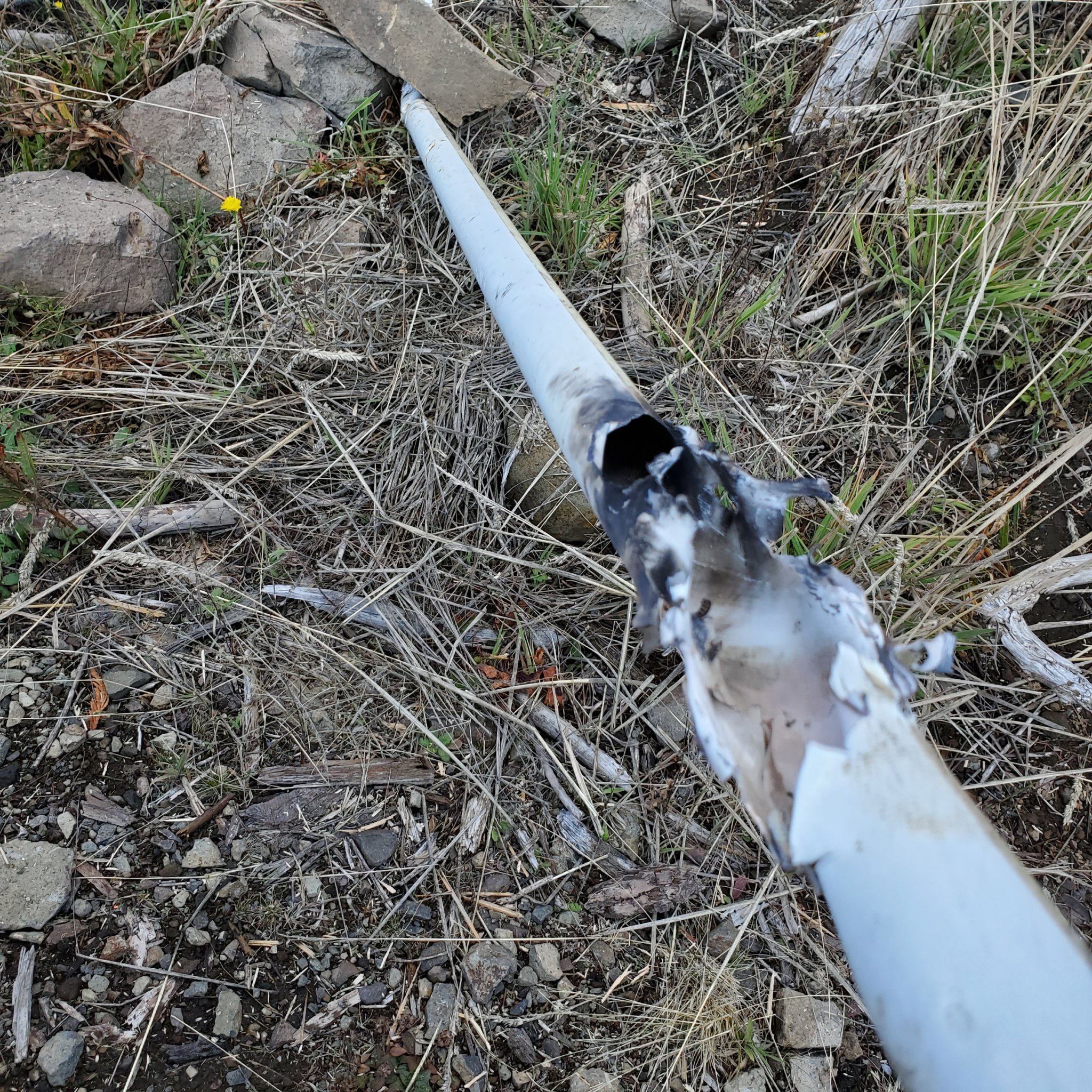

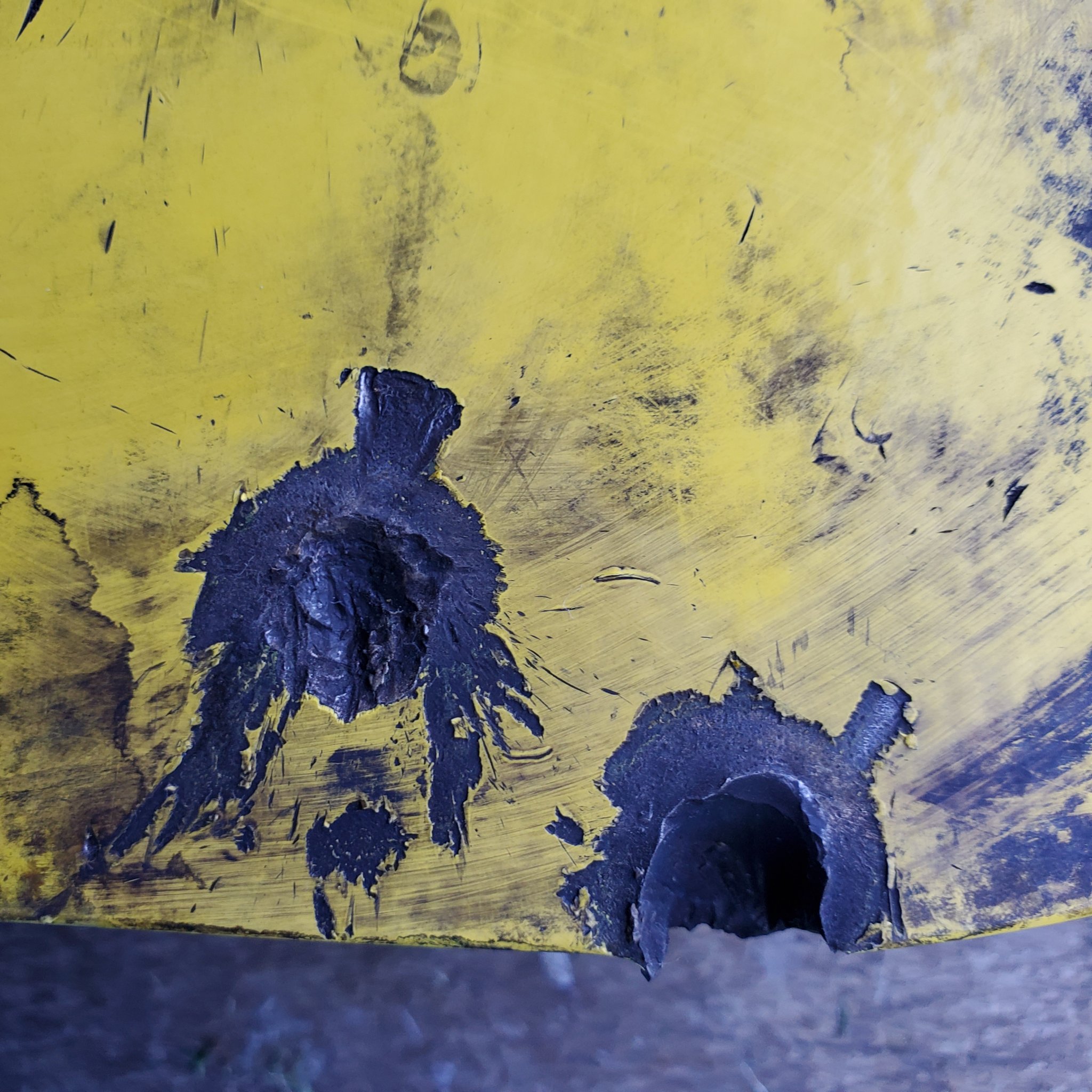

They are military APIT or armor piercing, incendiary, tracers, they explode on impact even at 800 fps muzzle velocity, a blast for plinking in the gravel pit.
This thin metal pipe holding a target was split wide open when hit by a subsonic APIT, as the tip exploded on impact.
Good for elephant hunting?😀
