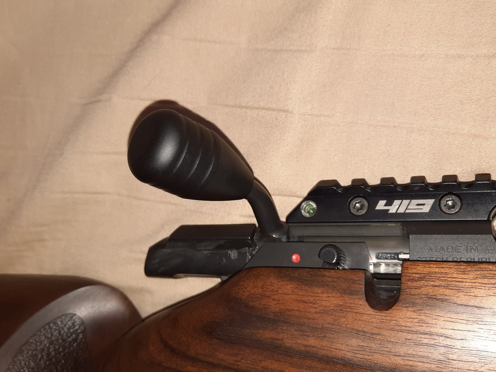

I have an MTR that I have re-sprung and lapped the trigger sear. It breaks crisp at about 7 oz. I like nearly everything about it except
for it's cold bore issue. I used 9 and 3 micron aluminum oxide film to lap the trigger blade only. I also replaced the small round knob
with a Vudoo knob. It is a much better size, weight and length. I would certainly use an ARAE 419 clamp on type scope mount.
Some others that use set screws push into the top of your receiver causing damage. If you go that way, put some #7 lead shot
into the screw hole to prevent damage. Sure you could use a brass tip screw but they often leave brass ghost marks behind.

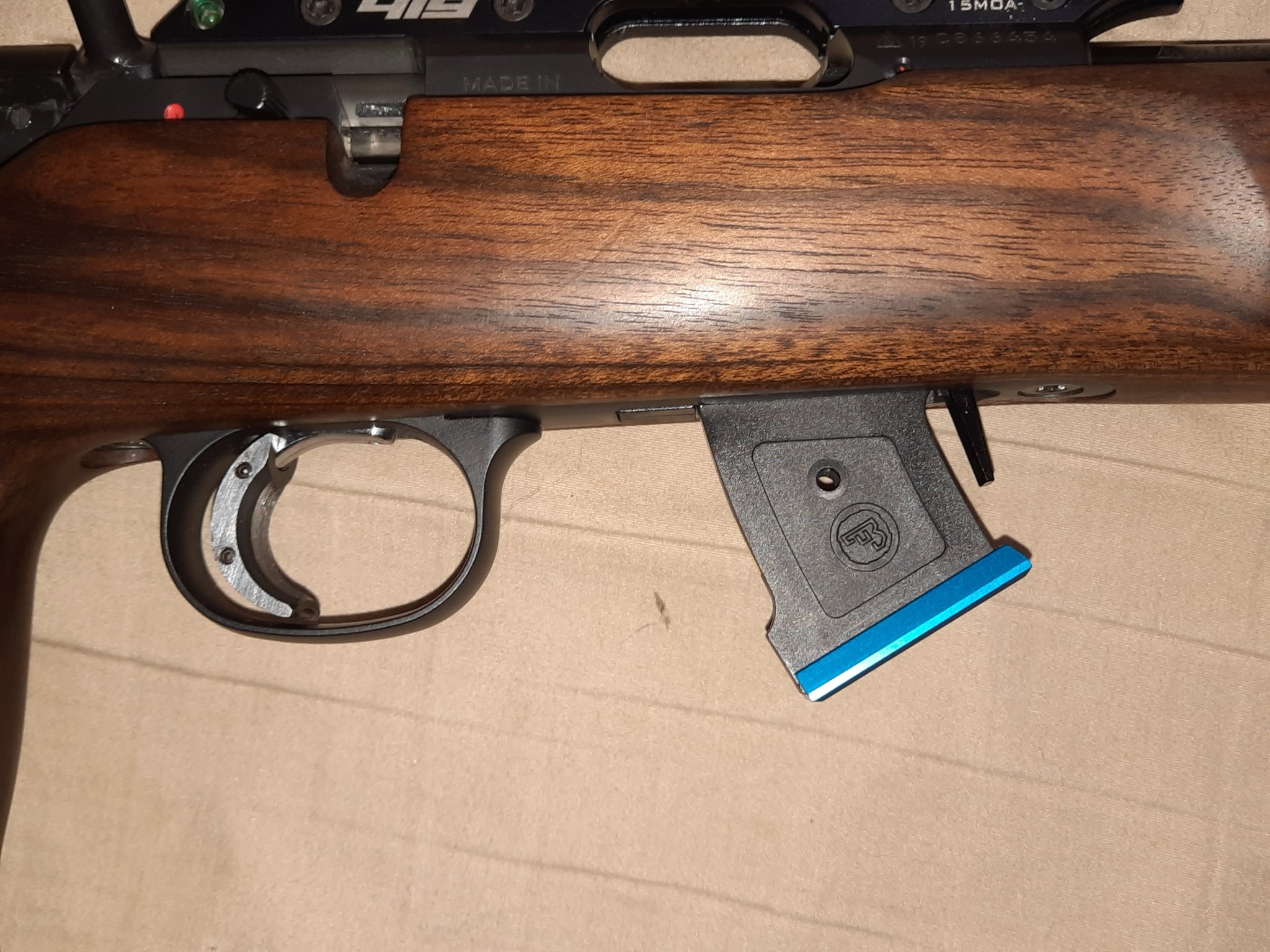

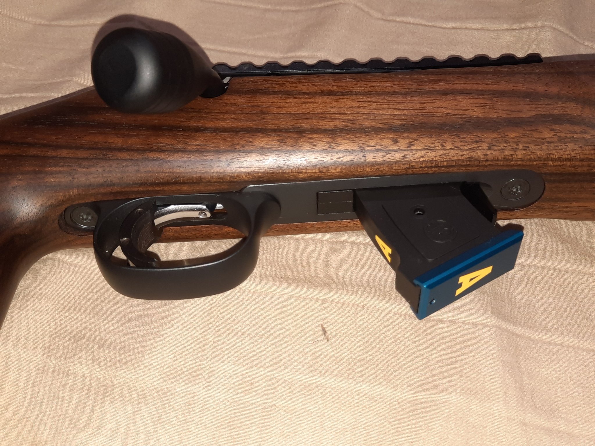

You may also like a trigger shoe. An ACE #21 and #22 both fit the 457 trigger blade. Lastly, I have to suggest you get an extended
magazine release from Anarchy Outdoors. It's aluminum and the longest one on the market. Others are only .080" longer than
the factory release. With it, there is no more searching for the release. I grab the mag and pinch it between my thumb and index
finger and it comes out simply and blazing fast.

If you get the Annie I suggest you get an ACE shoe #24 and the $75.00 extended magazine release. It looks much less refined than the
flush, difficult to find and operate release but it makes mag removal a joy and to me, it's worth every penny. I have have some 1416

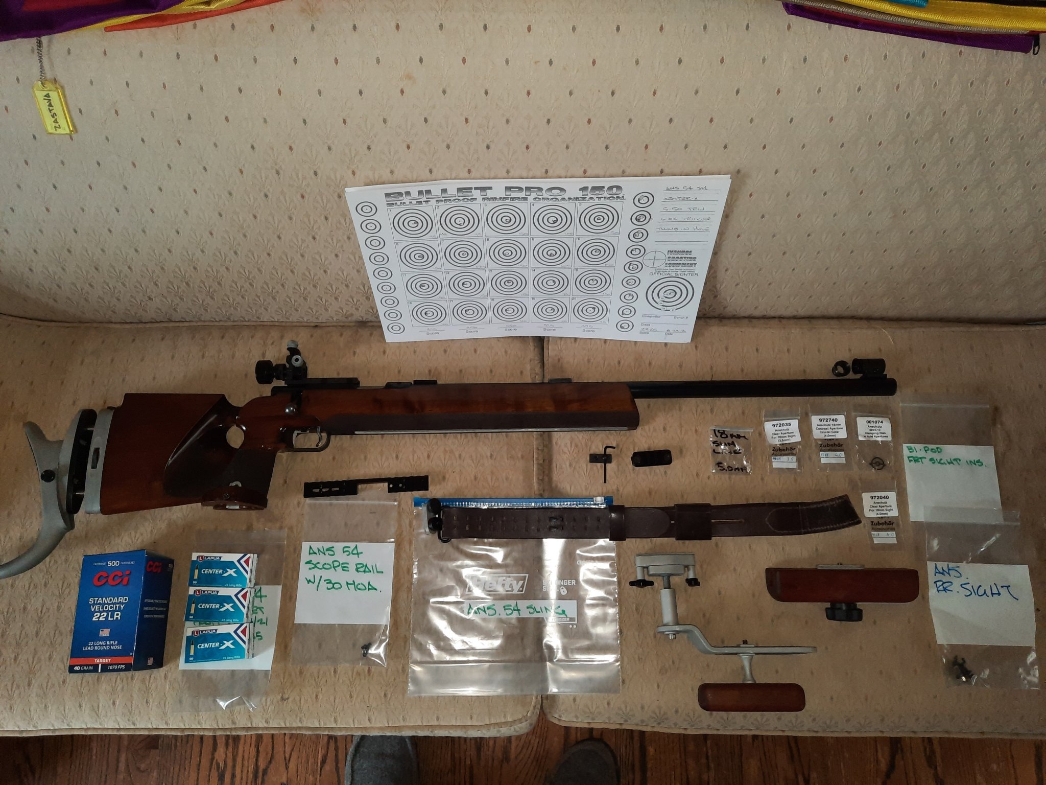

I lean toward the longer old model Annie's like my 1971 Match. But I do all bench style shooting at this point. btw.... the 1971
Super Match is by far my most accurate gun.
