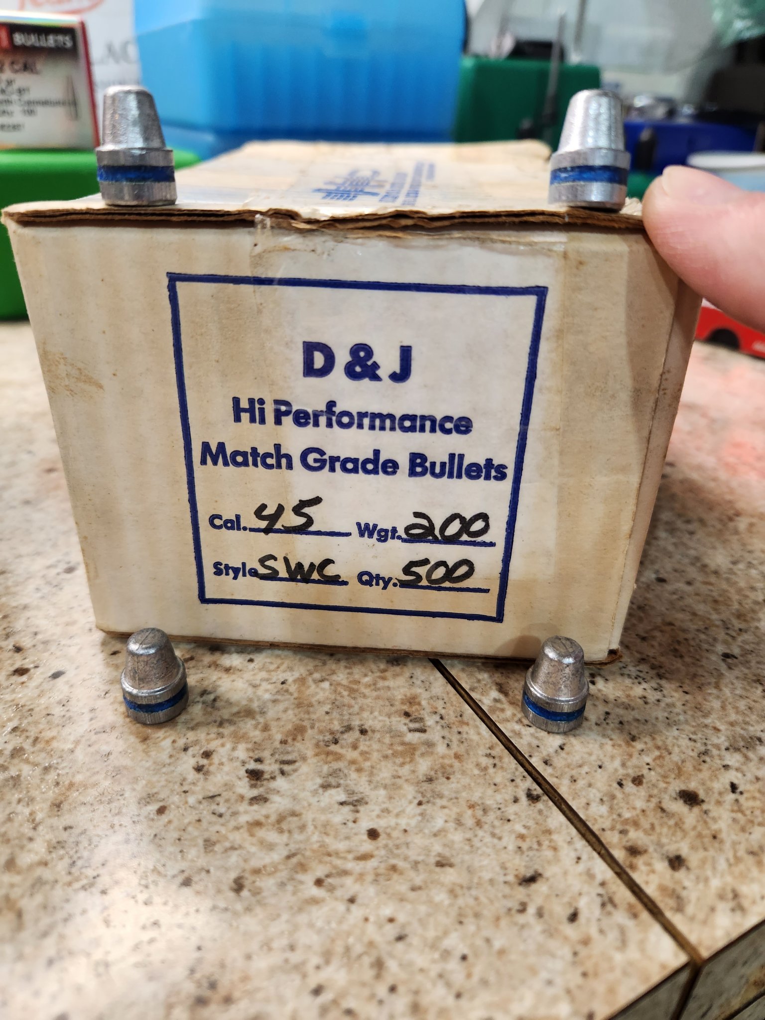

I received these D&J SWC bullets from a friend's stash after his passing.
After a quick Google look, it seems they are no longer around.
Are you using anything that's comparable you like?
Shooting a full size Kimber and HK45 and they both like it.
Are all 200gr SWC created equal? Anything to stay away from?

I had a friend casting for me using the Lee mould which is similar. I would have to look up my notes, but i had a Unique load that was comfortable and accurate. It also was comfortably inside the USPSA power factor for Major.
H&G 68 and its clones have been shot by the literal tons for many, many, many, many years in every type of pistol shooting sport.
It is an extremely popular bullet in .45 ACP for bullseye and other target shooting.
You should find a list of loads for that bullet in every reloading manual made from the bullet’s introduction to today.
4 to 4.5 gr of bullseye seated to where the shoulder is about a thumbnail out of the case (1.245-1.250) and a .472 taper crimp.
H&G 68 and its clones ....

I get ~750 f/s with 4.0-4.2/Bullseye. For short range deer hunting, you'll want another propellant. Consider using Unique or BE-86 in the 6.8-7.2 gr. range. With such a load, it is CRUCIAL that you start low and work up.
