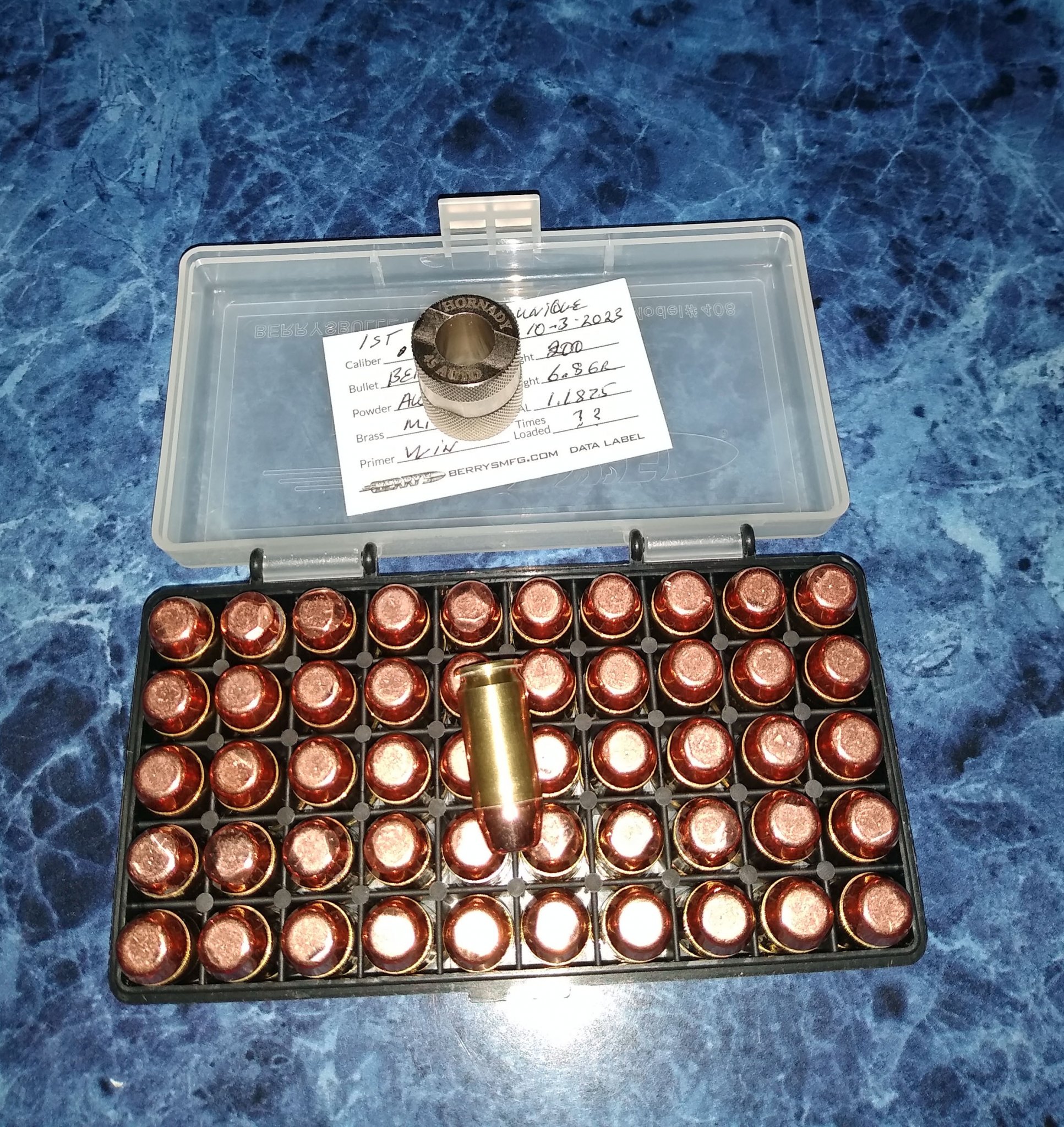

Berry's FN 200 Gr. ,gonna set em at 1.2" OAL ,anybody load those ?. OAL sound about right ? Tried a tad longer but NO GO in one of my Commanders . I'm running 0.02" under Max load with Unique and Bullseye .
I stopped using Berry's years ago after too many blown matches due to malfunctions. Malfunctions I couldn't track down for about two years. Finally figured out that the occasional undersized bullet was hitting the feed ramp and slowing things down just enough for a stoppage. I switched to the double struck ones and it still happened. Then I swore them off.

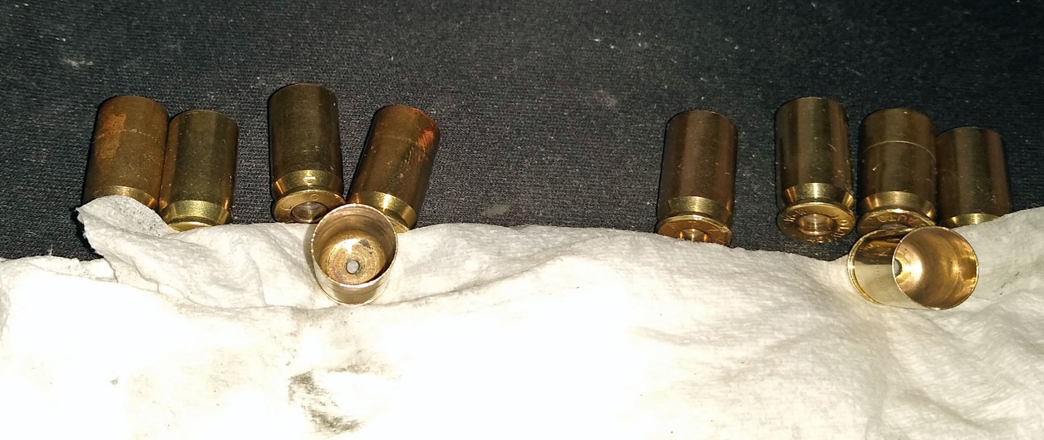

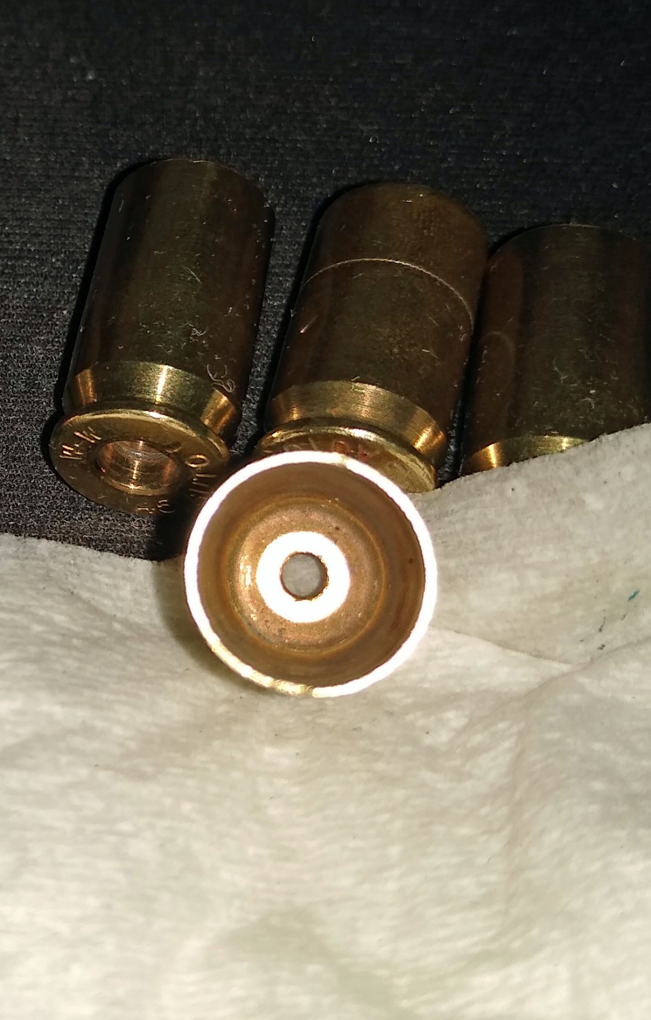

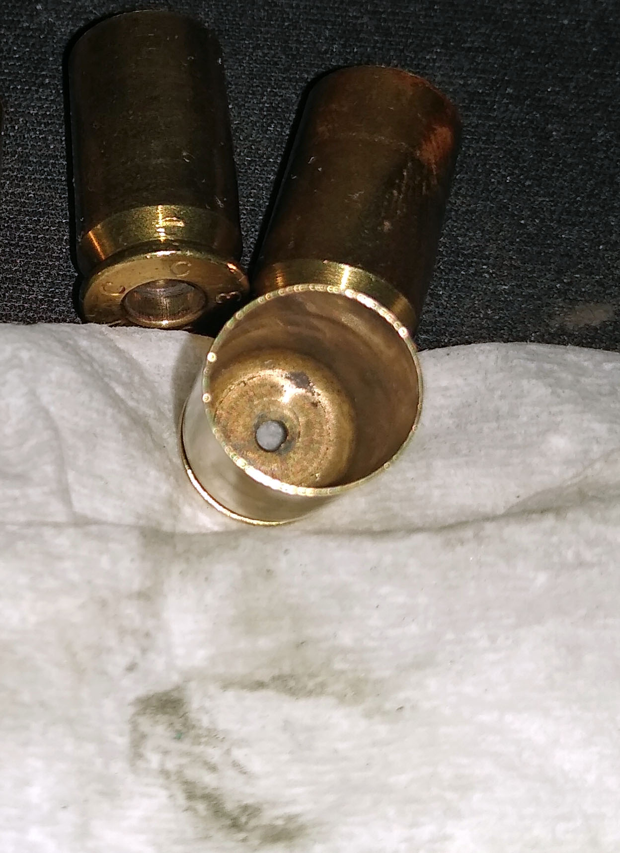

Has anybody seen small primer .45ACP brass? I was going through a coffee can of brass the other day and came across some of these. They're just range pickups so I have no idea how they shot. Does anyone have load data for small pistol primer .45?

Yep. Pretty sure S&B is all SPP. Found that out the hard way. Went cross-eyed sorting through a 5 gal bucket of cleaned range pickup .45.

For spp increase powder by about 0.1 or 0.2 gr to get same velocity as your lpp load.

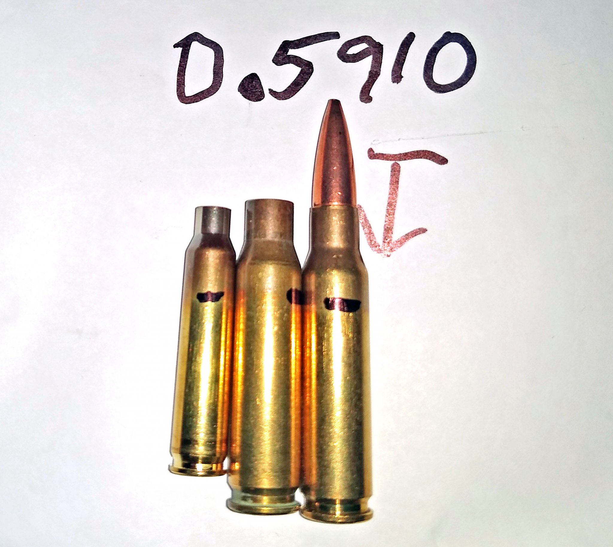

I recently cleaned around 2500 .45 cases ,found no less than #22 different head stamps and not a single small primer pocket . All including Foreign cases LPP . Years 50's-2016 . Not a single aluminum or steel case either , normally something odd shows up but in this series, only #2 , 9mm's were mixed in . I've ceased to use SS pin tumbling any longer ,as MY Ultrasonic cleaner with My solution recipe is far superior and so much faster . Example .45 Cal , 3.5 minutes in Ultrasonic verses 2+ hr. pin tumbling ,with less than desired results .

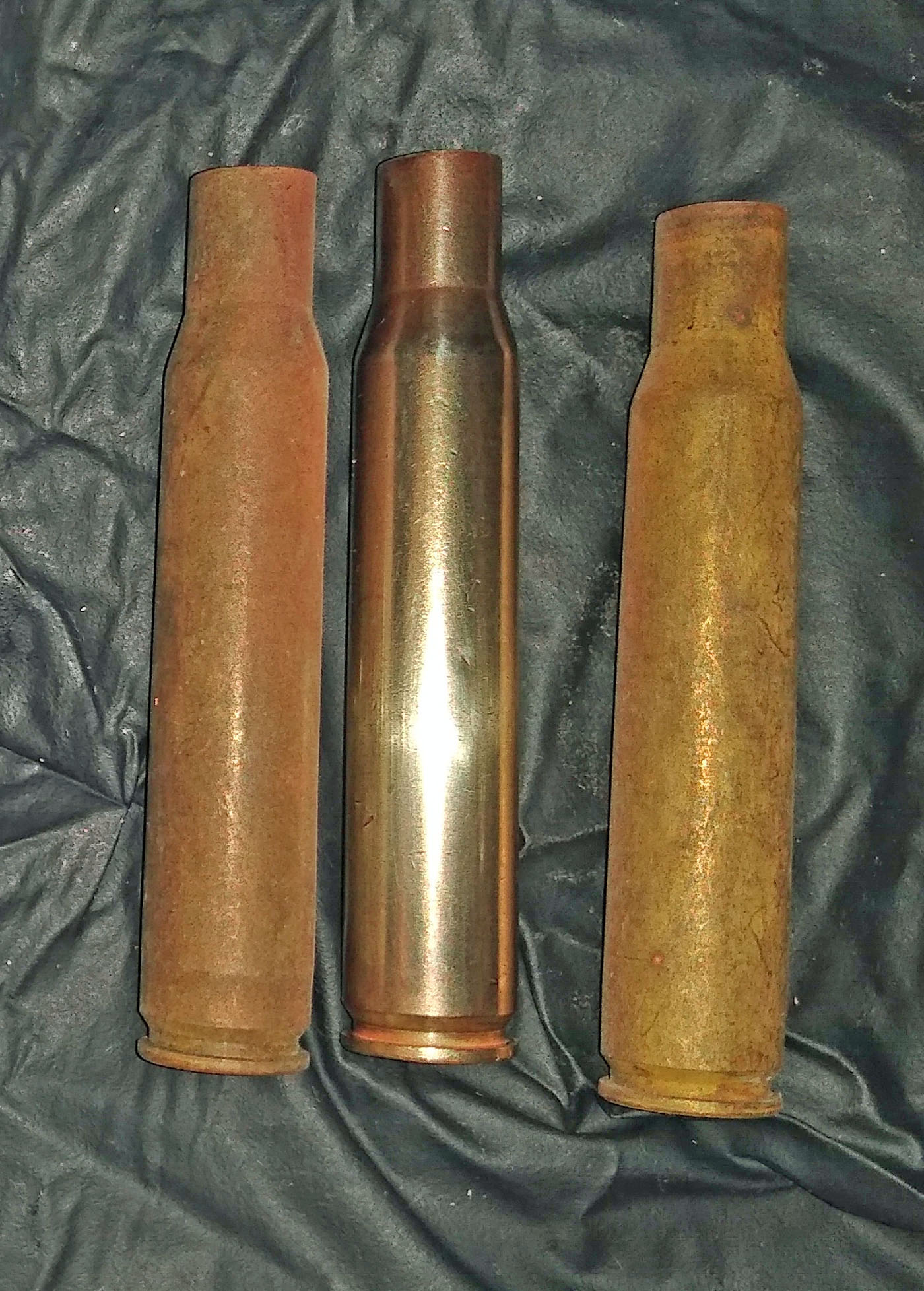

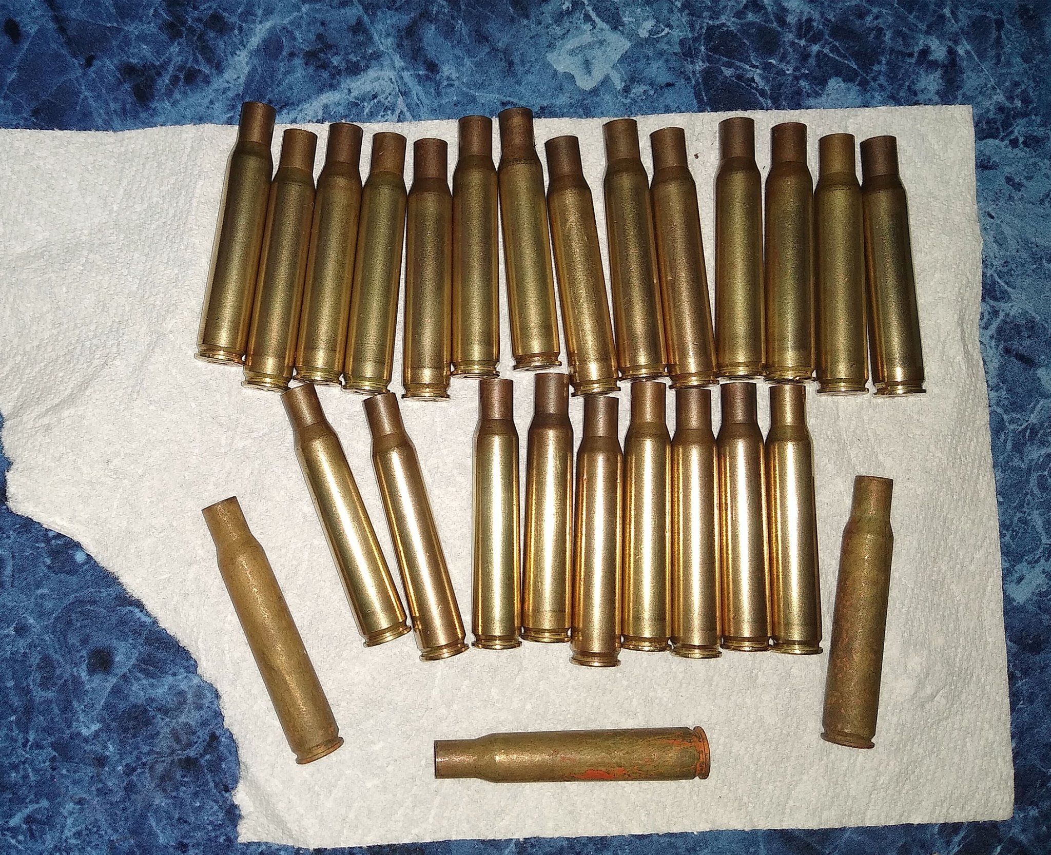

I introduce ductility ( what many refer to as annealing ) after every #3 firing on bottle neck cases .
I'm happy to report I've as of Yesterday gotten #29 firings on 1942-68 LC .30 Cal. cases and I load near top end . Haven't lost a single case nor tore any rims and if anyone has Garands they know that's remarkable in itself . As we all know Gas Guns aren't the most forgiving extractors .
Those original once fired cases had set too the weather for 45-50 + years before I got hold of them and were UGLY ,as in triple bagger UGLY !.
I must have measured perhaps #250 New Lapua cases in various calibers and found something interesting ,from the case mouth south the witness mark is 0.591 down the shoulder towards the body . Once I started duplicating that heat signature , MY cases began sealing as well as lasting longer . Restoring the neck & shoulder ductility most certainly lessons carbon neck shoulder ring as well as gives pretty consistent velocity . So knowing a little more than the average person ,due in large part to Norma . I believe the secret is NOW revealed as to Lapua's Case success .

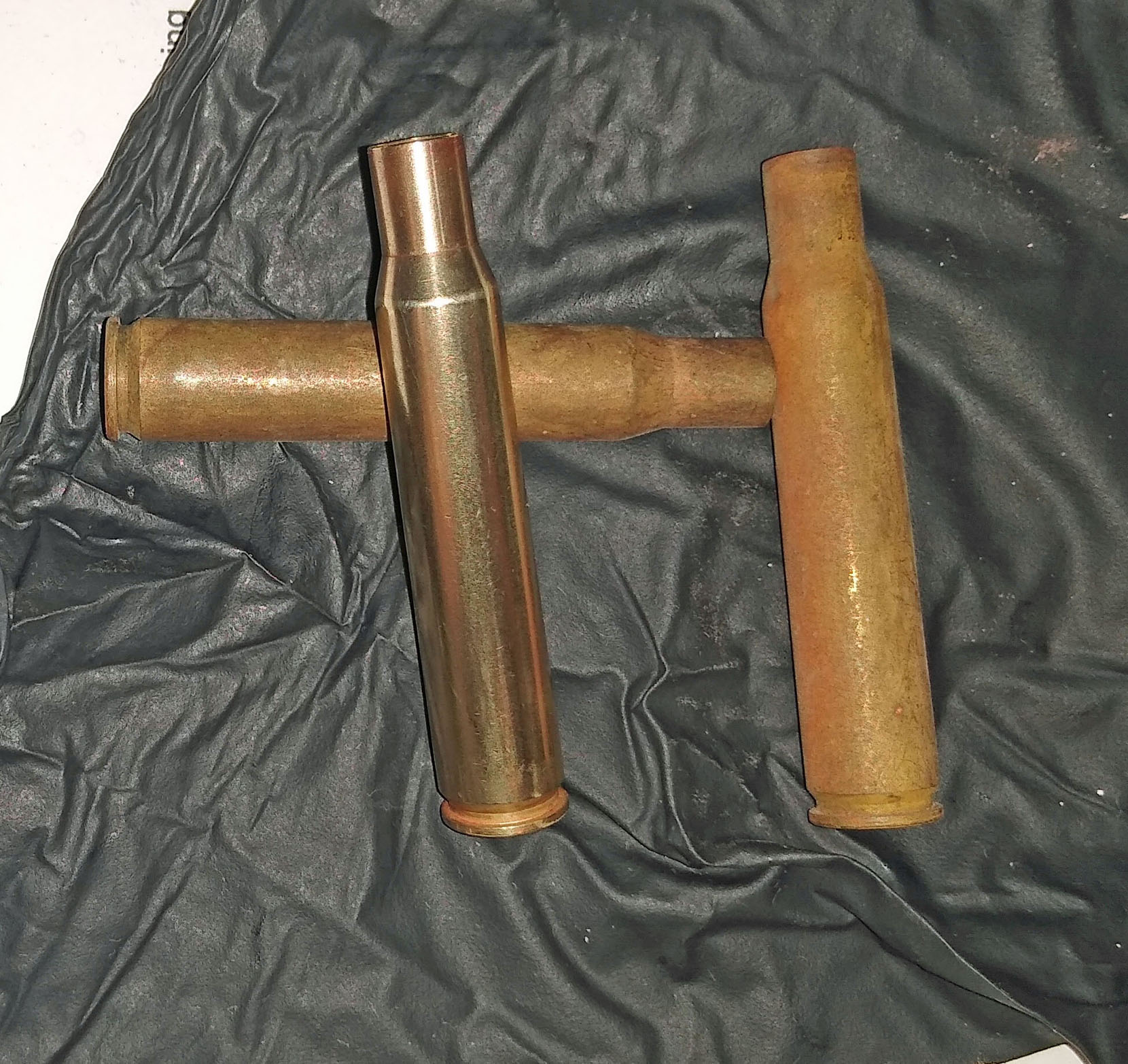

Fyi: I found by changing frequency of the ultrasonic ,I was able to clean even the rebated rim groove substantially better ,thus giving desired quick cleaning results .
