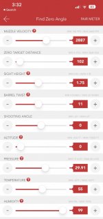

New to long range and trying my best to learn my 4DOF kestrel and APP.
If I understand right, I am always suing my station pressure when shooting and my altitude won't really matter if I have my station pressure adjusted right.
To adjust my barometer pressure properly, I input my altitude in the altitude ref under Baro pressure. Note the pressure and reset back to 0 Altitude.
In the altitude setting set my Baro ref to the noted pressure.
This should adjust my altitude numbers based off pressure.
When figuring my ZA, would it be better to just use 0 Altitude and just use station pressure? and use this when raining targets as well? This whole pressure altitude thing is really starting to bug. I plan on using the Kestrel in The Frank in Idaho. Huge elevation and weather changes.
Reactions: Downtown
You do not need to adjust anything in the weather side of the meter. The ballistic app knows what info it needs and gets it directly from the sensors. It wants to know the pressure where you are standing, baro and altitude are not used, so no entry is needed.
So when calculating my zero angle, I should set the altitude to zero and the pressure to the station pressure? Essentially always ignore altitude and always use station pressure?
Does altitude and baro pressure essentially try to estimate station pressure and that’s why we don’t use them?
I thought I read something about atmospheric pressure not being on a linear curve.
On the zero angle there is no entry for altitude or pressure because it is not needed. You don't need to enter anything about that. That info is only needed if you want to use the weather side of the meter for purposes other than shooting. For ballistics you enter nothing except target and wind info, the meter uses its sensors for everything else it needs without your input.
Reactions: Chukwithak

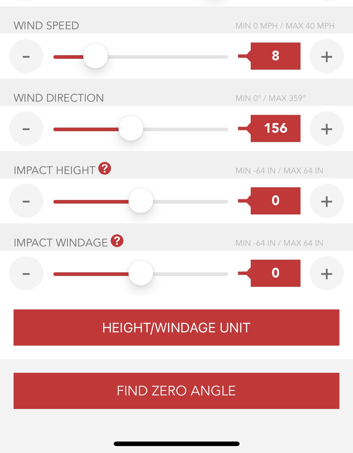

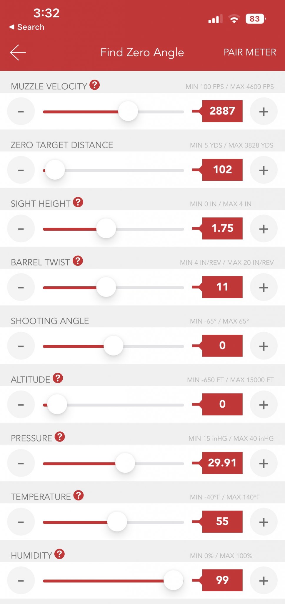

Sorry, this is referring to using the IOS app when paired with the Hornady Kestrel. The app asks for both altitude and pressure when finding the ZA.
That’s correct. This is the information the IOS 4DOF asks for. Gets confusing as it wants different information as the Link app and different information as the Kestrel it’s self.

You not only need to fill out all of the fields, the information has to be as exact as you can. Use the IOS app and then transfer it to the Kestrel.
Once you have really good environment data for your zero angle the app takes care of the rest. Whenever and wherever you shoot afterwards you just enter current environment data and the app does the rest. That's the beauty of zero angle.
For altitude data you can use the Google Earth app on you phone.
That said, after setting your zero angle you will also need to set up your axial form factor - this is for ranges greater than 5-600 yards. That's basically a bullet drag calculation for your particular rifle at long range (all rifles are slightly different). It's included in the video below.
