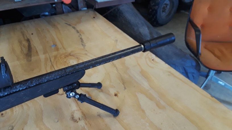

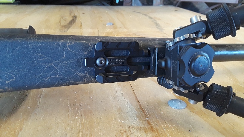

So I’m having trouble finding what I’m looking for and maybe it’s because I’m not imaging this correctly... I currently have a 2 stud EH1 4in apart. I’d like to run an atlas bipod with acra attachment as well run the plate on my acra ball head on my tripod. Which rail and which atlas do I need to buy.... I have a krg bravo on my other rifle and it fits perfect in my ball head. I’d like to add the atlas and have my hunting rifle compatible. Thanks for the suggestions.
What does your hunting rifle look like? Will it accommodate an arca rail without drilling?
If you are getting the arca attachment on your bipod, I’d definitely get the full length 10-14” arca rail. You‘ll already have the expensive parts, you might as well get the most use out of it by getting a full rail.
as far as which atlas, if you get on the area 419 website, you will see that they offer their arca mounts on atlas bipods. Pick which bipod you want, and choose the arca option.
I have a 4” arca rail on one of my rifles (tacA1) because i don’t have a arca mount for the bipod yet. So I can still use my tripod until I get my atlas with the arca mount. On another rifle, I have a full length krg rail with a Harris bipod and area 419 arca mount.

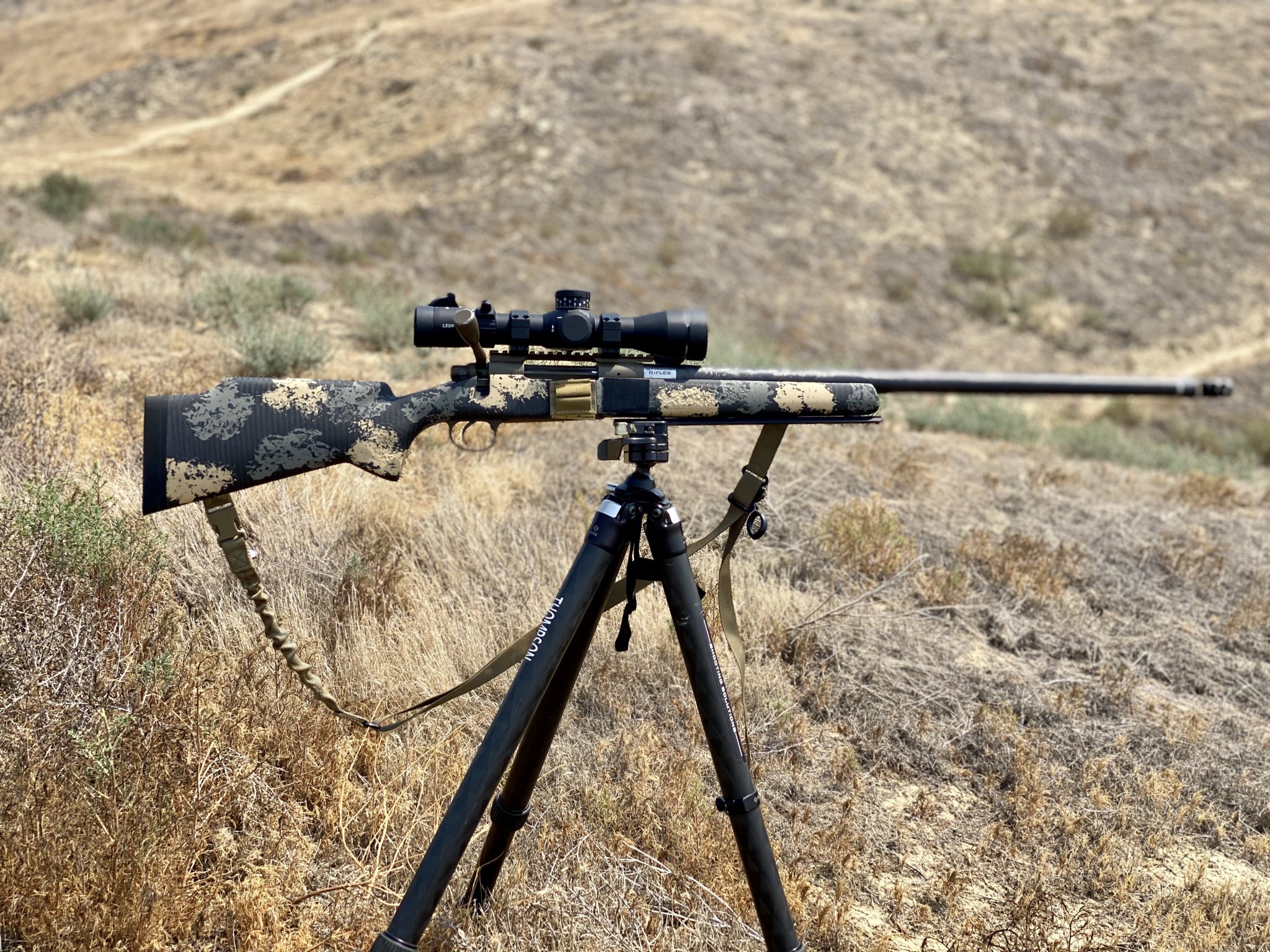

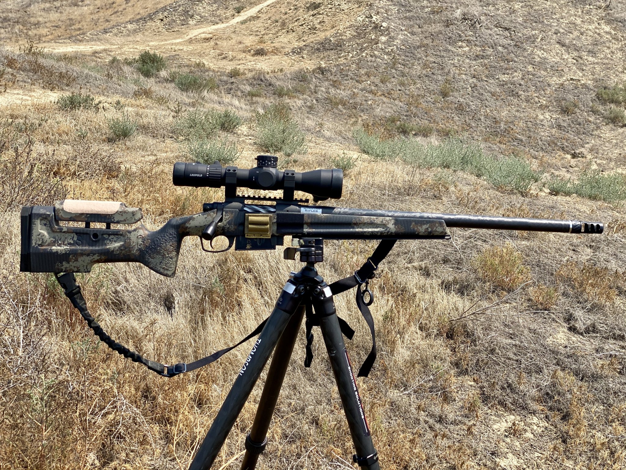

Here are my main 2 hunting rifles, a very light magnum in the Manners hunter carbon Elite came in at 26oz for Elk (just under 10lbs with a fully functioning scope MK5) as it sits on my scale) and my 6.5 for pigs in an carbon but a a bit heavier with the adjustable comb.
the rails hold on fine and feel natural. I also have them on 2 stock tikka ultra lites; and of course my match gun.
