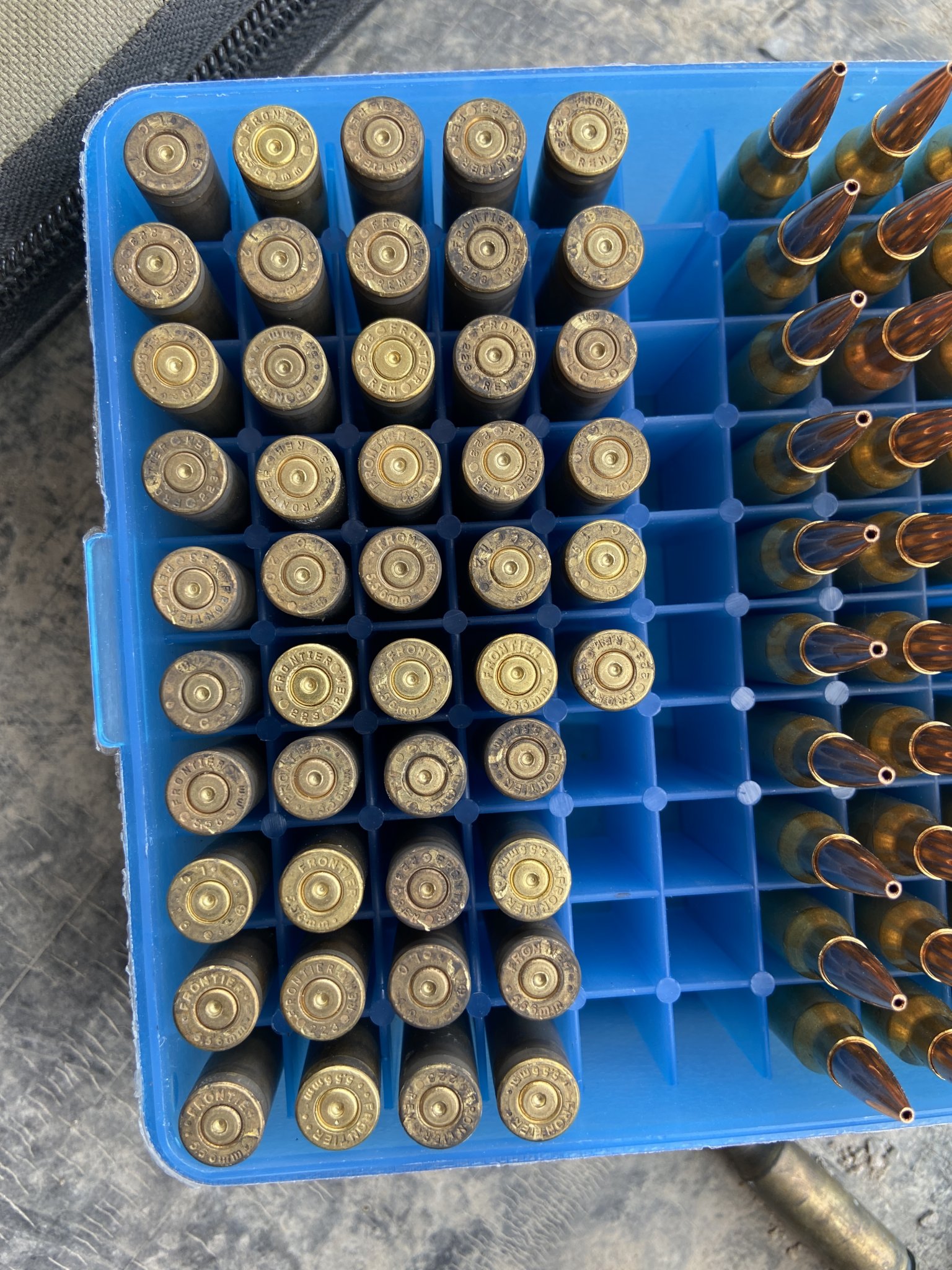

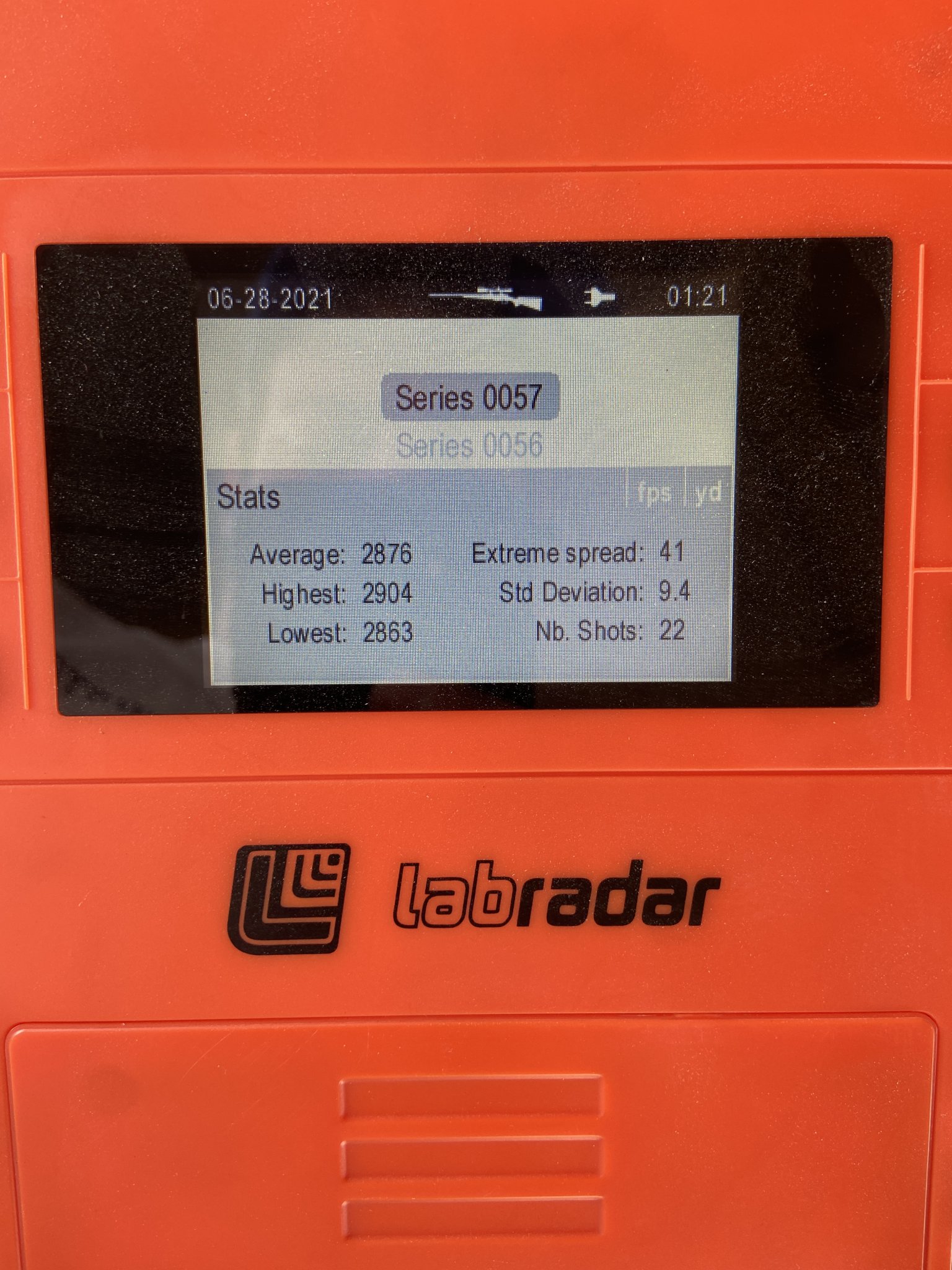

I have great results with TAC with 55gr FMJ and 26.8 gr TAC
Very consistent and capable of impressive velocities.....
