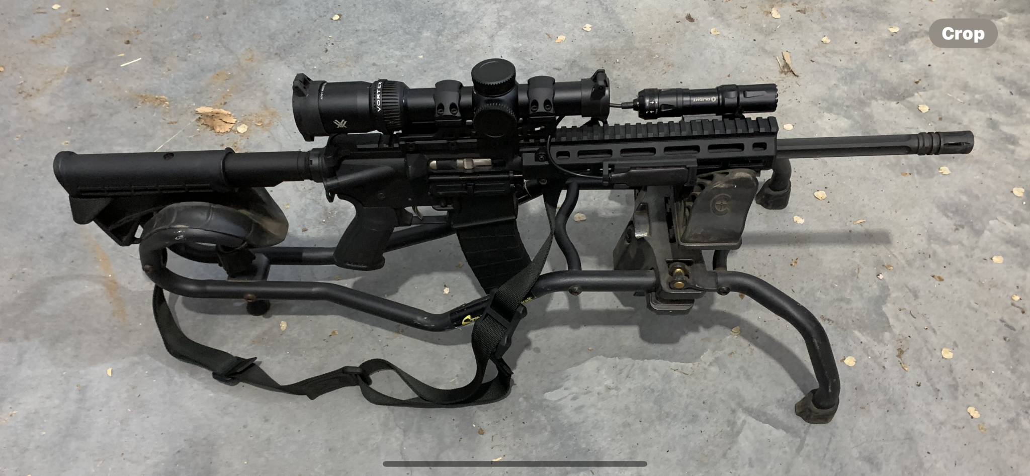

What trigger did the gunshop drop in the lower?
Also, from my perspective the set up could use a little tuning like turning your bipod around the right way so that you can load the bipod a bit and actually take advantage of it. You could also try a cantilever mount to raise the optic a bit and push forward and adding a bag rider to the CTR stock can help it be more stable off a bag.

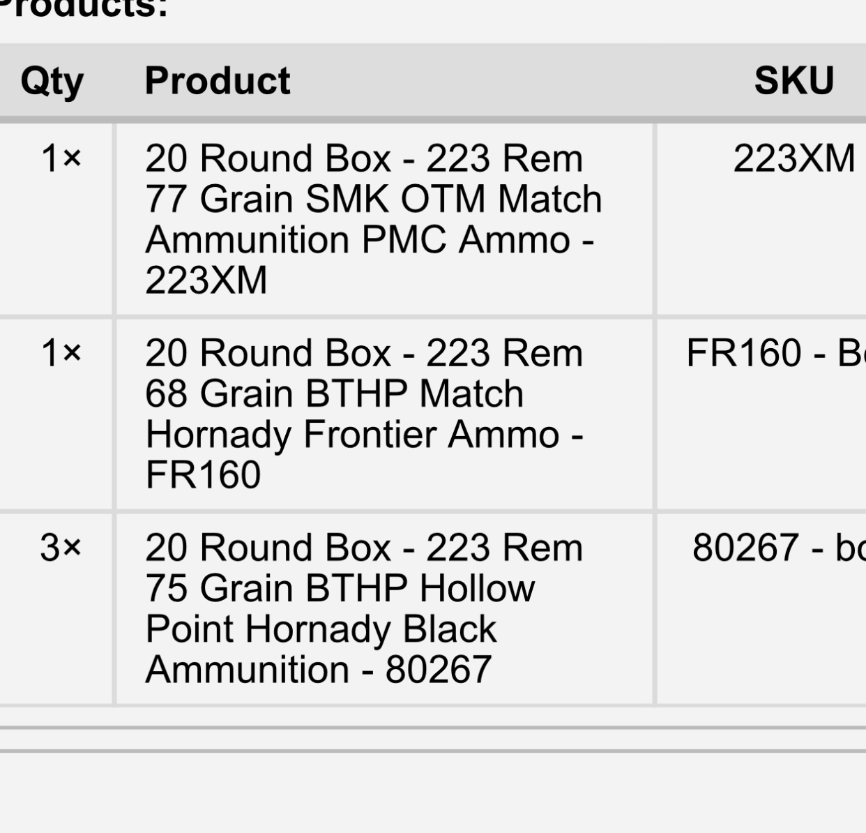

I have pretty good luck shooting off the vise pictured and the other pic of ammo order the Hornady black was the best.
I have tried several other over time. Winchester 64 grain extreme point, and federal 55 fmj, Winchester green tips. All the lighter stuff is shot gun group

It's not surprising that the Winchester and Fed ammo shot larger groups, 64gr XP is a hunting round and the other two are ball ammo varieties with an acceptable group size in the 3-4 MOA range. I have experience with 68 gr BTHP Frontier, it's never shot well in three guns, damn near ball ammo levels of accuracy and from past experience the 75gr Hornady Black is pretty good but still in that 1-1.5 MOA arena. I don't have any experience with the PMC 77 OTM but at the end of the day it is PMC, who are mostly known for making plinking ammo so...there's that. Personally, I think you have an ammo problem and before swapping barrels out, I'd give some Fed Gold Medal Match a try or some Black Hills to see what they do.

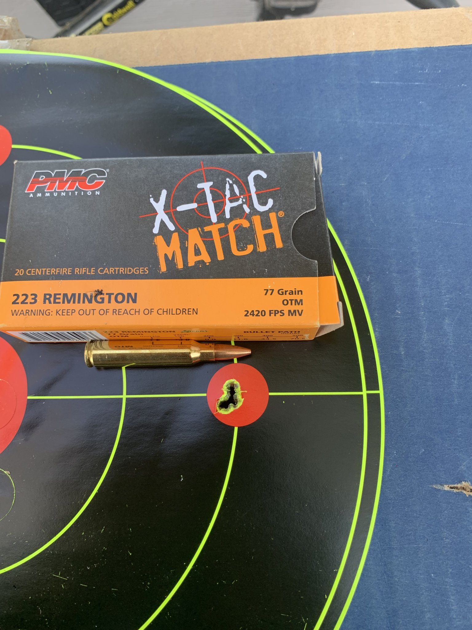

My WOA SPR barrel has been a very consistant shooter. It shoots good or better with several different kinds of factory ammo. Which is great since I gave up handloading this year (lack of available components and high prices).
The WOA barrel really seems to like PMC X-tac 77 grain, and the best group so far is about .8 MOA.
It also gave me a pretty amazing 20 shot group measuring just above 2 MOA, and if you scratch two "flyers" it measured 1.3 MOA, and this was with regular factory Fiocchi 55 grain FMJ.
I am very happy with it.

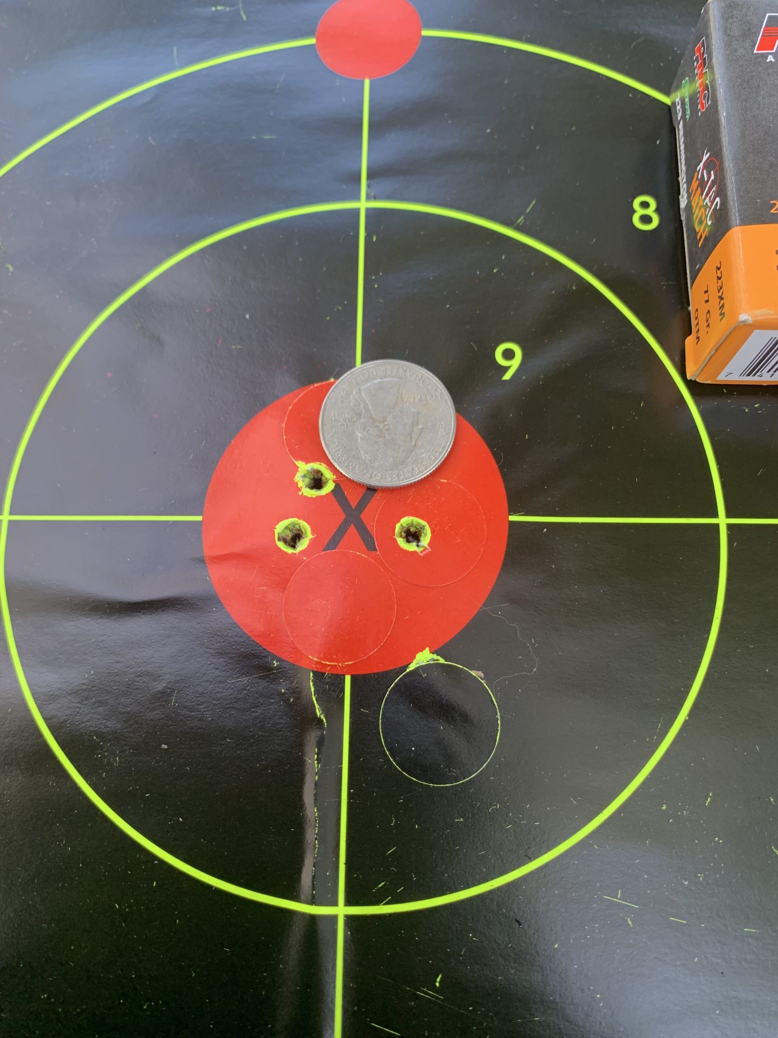

Not bad, also try some federal gold medal match either (or both) the 69 and 77 grain. They are sort of the "if this doesn't work you are in trouble" loads. But regardless you are moving in the right direction, I could live with those.
Reactions: fedupflyer
If that’s 100 yards then it’s still a .91 moa group. That’s sub moa by a little bit for sure.
No, that’s just 50. It’s always windy here but I have a spot down in the woods that is blocked from wind, but only 50. Those 1.5-2 moa groups is what I was fighting until today with the xtac 77s. That’s why I was considering a different barrel. Back in the spring I had my thermal on it for awhile and missed 2 different coyotes at 100-125 yards So I put the thermal back on my 308 but might try it back on the ar15 since it’s lighter.

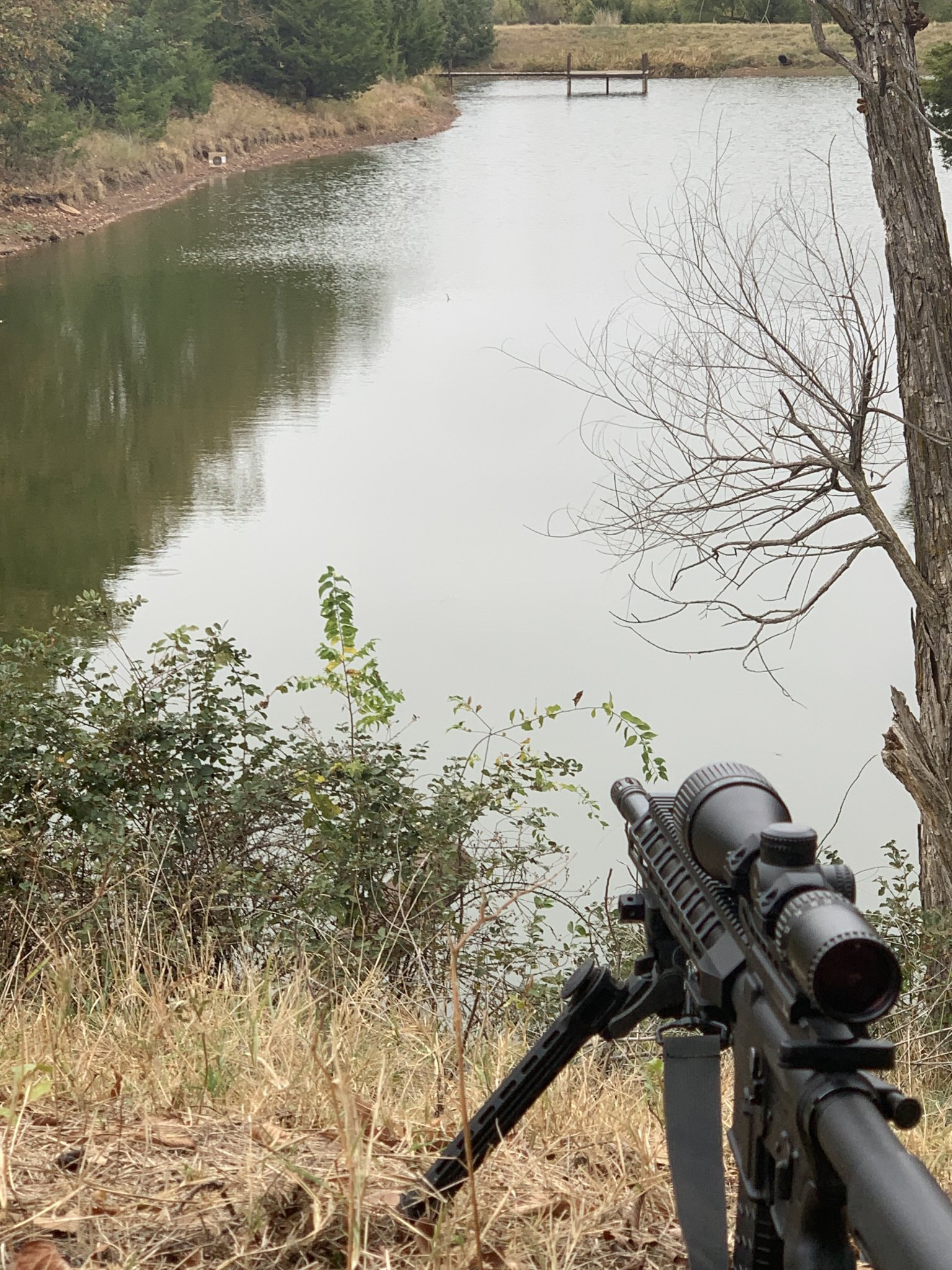

When you shoot your groups, is it usually in the type of setting in the picture? Are you holding consistenly on target for every shot or are you accounting for environmental variables? Are you judging the performance of 5.56 based on your experience with .308?
I'm asking because you may have found the right ammunition and don't know it. You really can't compare results you get from an accurate .308 to the results you get with a 5.56. Although .308 and 5.56 share similar trajectories, good .308 ammo has a higher ballistic coefficient and isn't nearly as affected by the wind as 5.56.
If you are shooting your groups holding in the same place everytime, without accounting for environmental variables, it would be no wonder that you're getting the results that you are.

Thanks for the reply.
That photo of the pond was the most sheltered place I had to shoot 100 yds that day. And there was a 10 mph wind at my back. I shot xtac 77 and was grouping 1” about 1” high at 100 yds. I feel pretty good about that. Just for grins I tried 3 adi 55 and was 3” group at 100. The xtac is the most consistent that I have found. Hornady black 75 bthp are next best. Anything 55 gr groups like a shotgun.
I have very few calm days where I live but I have a sheltered 50 yd spot with lots of trees on both sides that block most of the mind especially on calm days.
I like the 50 yds zero and have done that for years. I can hold point blank out to 200 with trajectory about 1.5” high at 100 with second zero 190-200yds. Works for coyote or bigger sized targets.
I am not ready to take the thermal off the 308 ar yet and this 223/556 isn’t a long range predator/varmint rig for me in this configuration.
I have a sub moa 22-250 also, but it and the 308 are both heavy.
That’s why I wanted to play with the ar15 again.

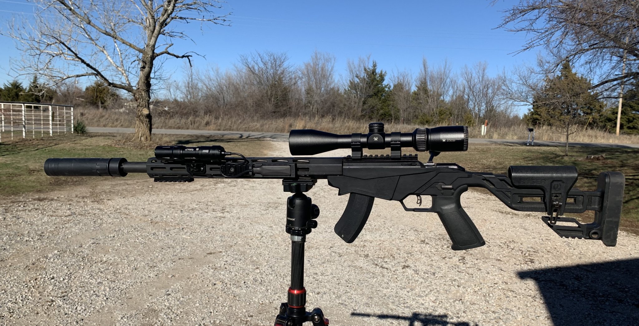

I usually use a ball head tripod to help hold still. Recently beavers came back and started cutting trees around our pond. I was able to headshot 2 of them swimming across the pond with my precision 17hmr with a weapon light. It was pitch black midnight and I used a thermal monocular to spot them at 50-60 yds and flipped on the light on and shot. Worked great.
For coyotes, when the wind is the right direction, I sit at the back of the wife’s goat pens in a chair with my tripod and watch an opening between some woods on the back part of the 80 acres. I scan with the thermal monocular and look through the rifle thermal scope if I see something. The tripod helps cancel the weight of the 308.

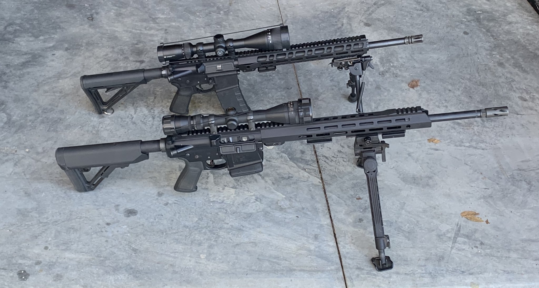

It kind of spoils me to shoot the 308 or the 17 because they are very accurate. I just found that the xtac 77 shoots good from the ar15. Before, I was struggling. I will know more after I use it a bit more.
Pic of 17 hmr

Man, im envious. It's nice when what you like to do actually serves a purpose. Although I do practice shooting at small targets, most pest control that I take part in is getting rid of hogs, maybe coyotes and wild cats.
I see that you have a .308 and a rimfire, but have you played around at all with 300BO? When I first put one together, I thought of it as a short range cartridge and did a 10". Now that Ive played around with it some, im finding it to be a pretty accurate round, showing typical .30 cal accuracy. Funny thing is that finding ammo that shoots MOA or better has been a lot easier than it is with 5.56. I'm considering tearing down one of my 5.56 uppers and throwing a 16" 300BO barrel on it to see what it will do.
As of now, I'm only running a 3.5x ACOG on my 10", but center punching a 2" target isn't too hard at 100. I'm gonna throw some big glass on it soon, just to see what It'll do.
