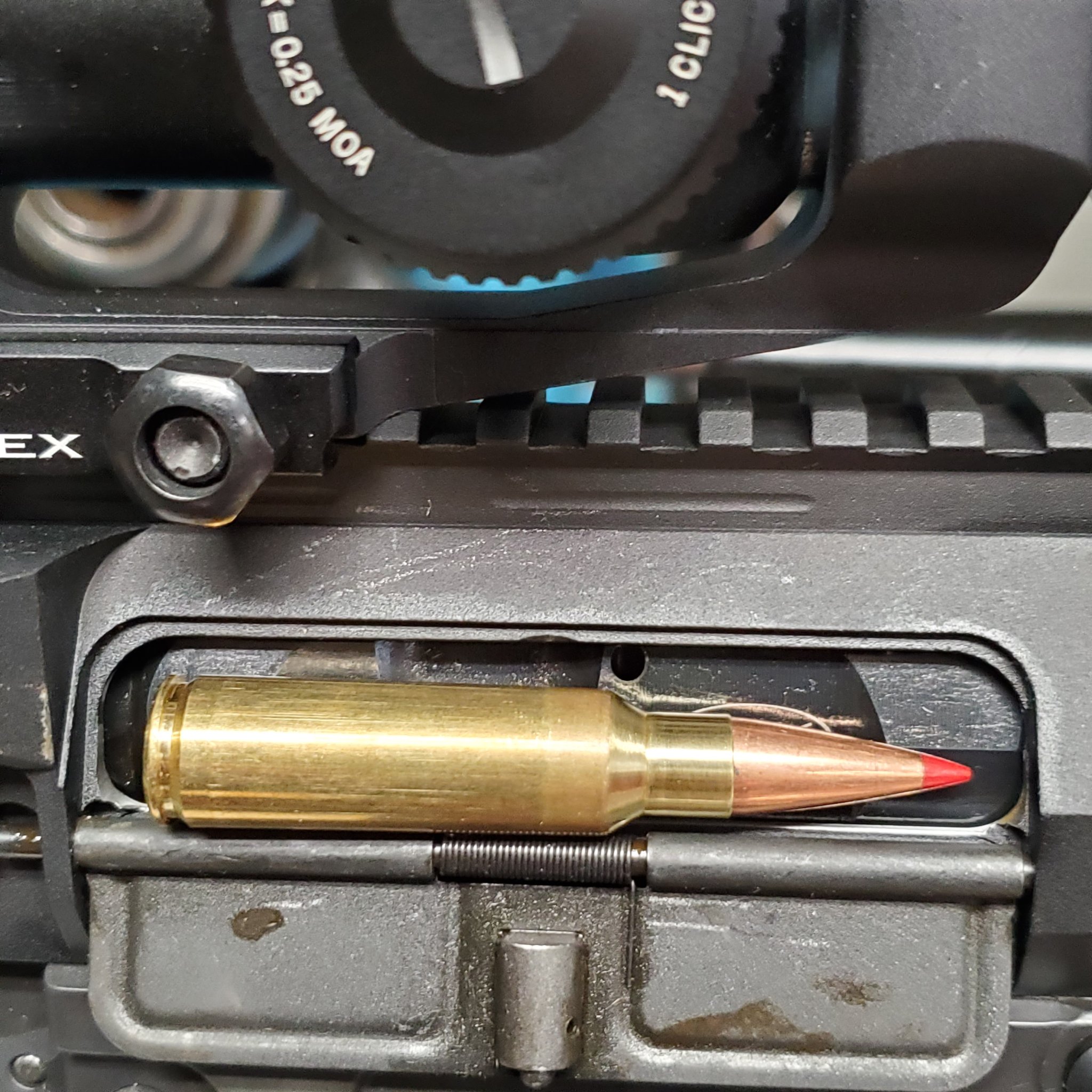

But do they feed and extract properly?
6.5 Grendal doesn't. Why would .22 ARC or .22 Valk?
Who told you 6.5 Grendel doesn’t feed and extract properly?
I’ve been shooting it in pretty high volume since 2009, and I don’t like looking like a fool in front of DM course attendees or my kids, so I would ditch something pretty quick if it behaved like that.
You will never reach the velocities of 6.5 Grendel though with any of the .224” cartridges shooting similar weight bullets. Even the 6mm variants are bottle-necked to where you have to be careful on the back end due to bore volume.

The OP sounds a little out there, with the 5.56 hybrid cases, for which there are none, (but I can cut the heads down and add an extractor groove....so it would have a 308 body dia. and more capacity than the 22 Creedmoor, but too long for the AR15...)
Then combine it with a AR 10 length, with AR 10 barrel extension.... ??? What do you want to do? Comes to mind.
A 22 caliber at high velocity, can be done.
The easy button is 22 Creedmoor with a hybrid case of cosrse, in AR10, but 80,000 psi is a bit much, for the standard AR 10 platform, but 65,000 is okay, with quality parts.
A 22/6.5 PRC can be done in an AR 10, with 95 gr SMK...might run up against RPM limits in a 6.5 twist.
I run the 338 RCM same case, at 62kPSI to 65kPSI in AR 10 18" barrel.
Don't want a 10" AR barrel and 64 grains of RL 26 powder behind a 95 gr .224" bullets, but it might get 33 to 3400 fps in an 18"
AR 10. Ya lose a lot of velocity in short barrels, with high capacity cases like 300 fps in the really big cases, going from 24" to 18".
The 458 SOCOM could be shortened and necked down, (that would be weird looking duck and take a while to get a reamer) but its really a low pressure round in the AR 15. The 30RAR case allows more pressure and at .500" body dia is larger than .473," of the 308...but all this won't get ya there in an AR 15 platform, and an 18" barrel, or worse a 10" barrel.
Dream on... sometimes ya gotta alter things to make it work. But it's usually time consuming and costly...and no one is gonna do it for ya.
Here is a magnum case in an 18" AR 10 necked to 338", but it could be necked to .224"
The largest case to fit in the AR 10 has its case head machined down to .535" to fit the magnum KAK bolt head, holds 91 grs of powder...it would be a bit of work to neck it to .224" but it could be done.
Maybe this will answer your questions or inspire your dreams...😁

I forgot a few companies, used to sell AR 15 uppers in 223 WSSM, and others, but they may not have been fast twist barrels.
Probably for varmints....plus WSSM cases have disappeared from the market.
