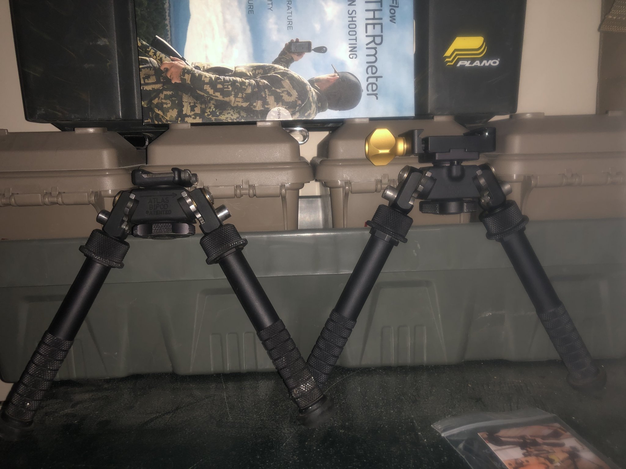

    Hey all, need some bipod input. Wanting to grab a dedicated bipod for my .338LM (Just long range stuff, no PRS, etc.) and have been looking at the 5-H and the Super Cal. I'm running a MDT ACC chassis so I need an ARCA clamp (adding a pic rail seems like it would defeat the purpose) so which is a better option? I know if I go 5-H I'll need something like the Area 419 Spigot mount adapter so I'm leaning towards the Super CAL as it doesn't pan but I wanted to ask if I was missing something. Thanks in advance!

    Had s-cal on my 338. Purchased 5H, and found the 5H to tame 338 a little better.
    The 5H is fundamentally more stable because the axis of revolution is above the center of mass. That makes it self centering. Go with that or the Elite Iron.
    So here’s my question about the 5-H. With an ARCA clamp (Area 419) I will need a spigot adapter (also would be Area 419) so I add the adapter which adds height and bolt the ARCA clamp to that. At this point have I elevated that barrel out of the stability triangle or gotten close to the same position as the Super CAL defeating the purpose of the 5-H all the while adding another variable (aka pan) to the system? My question certainly lends itself to grabbing the elite iron unit but I didn’t see an ARCA option available.

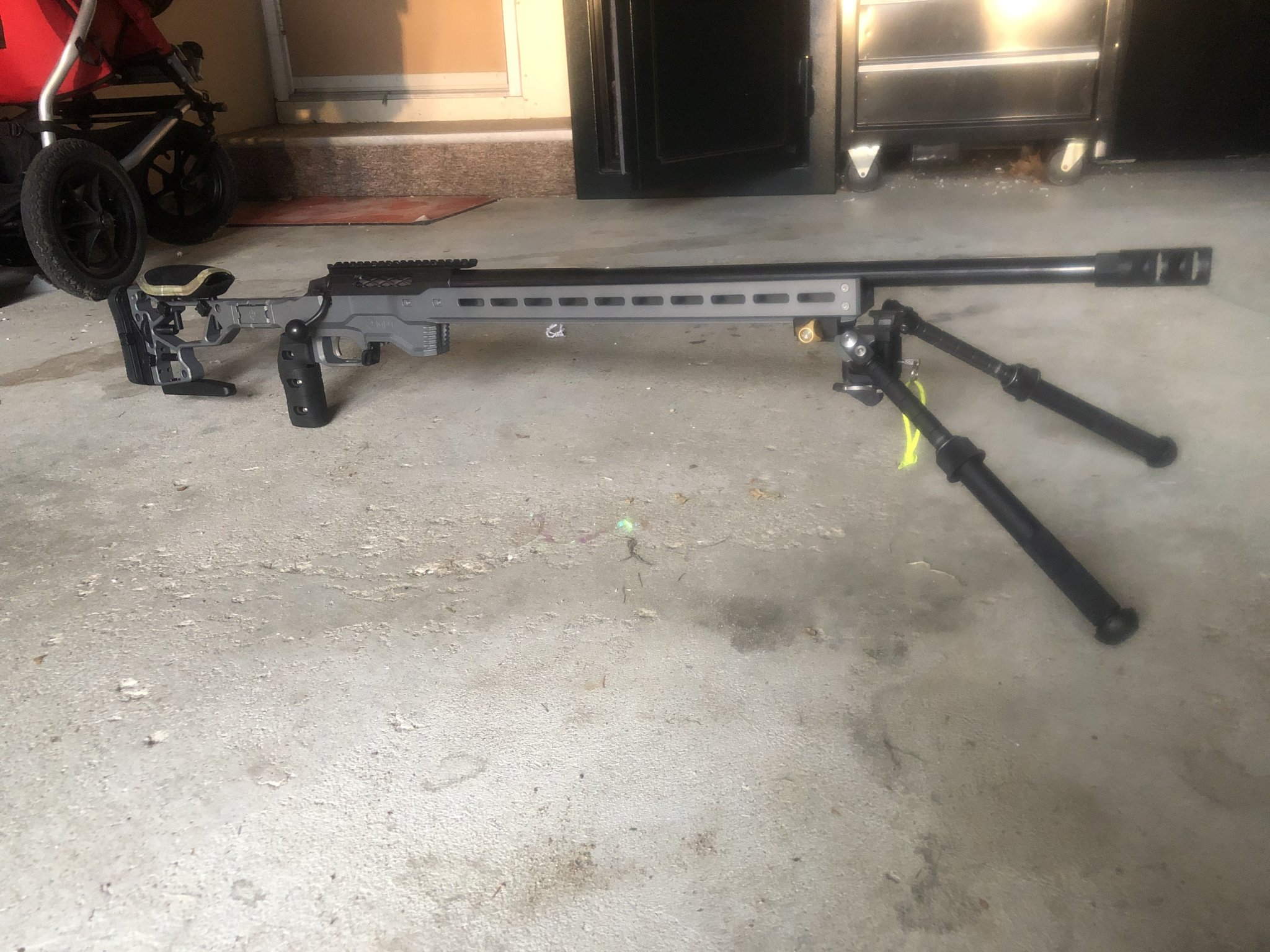

    To give you a visual, here’s what my 5H looks like on the ACC. I did need the Area 419 spigot extension. The scope hadn’t arrived before I deployed, so was unable to shoot it and give any real feedback. Also, don’t have any of the other bipods discussed to compare it to. Cheers!

    Very nice! So how do you like the spigot extension? To my eye it looks like the spigot adapter/ARCA clamp sits lower that a QD/pic rail set-up. Also, it is pretty stiff? No worries about breaking the spigot adapter loading the bipod?
    Spigot adapter is a solid piece of steel, I can’t see ever having any issues. With the milled out slots on the spigot adapter it sits about as close to the forearm as you could want without rubbing while you slide it. This is due to the milled out offset slots for the bipod and clamp. Overall I was very pleased with the extension, clamp, and bipod combo. They work together very well. If you install a pic rail instead of the spigot your bipod would be farther away from rail due to not being offset like the spigot adapter is (I’m assuming as I didn’t try this). The extra 1.25” length also seems nice. That’s a 25” barrel for comparison, look how close the bipod can come to the muzzle. It’s much more stable than when I put this BT-46 on there.
    Spigot adapter is a solid piece of steel, I can’t see ever having any issues. With the milled out slots on the spigot adapter it sits about as close to the forearm as you could want without rubbing while you slide it. This is due to the milled out offset slots for the bipod and clamp. Overall I was very pleased with the extension, clamp, and bipod combo. They work together very well. If you install a pic rail instead of the spigot your bipod would be farther away from rail due to not being offset like the spigot adapter is (I’m assuming as I didn’t try this). The extra 1.25” length also seems nice. That’s a 25” barrel for comparison, look how close the bipod can come to the muzzle. It’s much more stable than when I put this BT-46 on there.View attachment 7386453

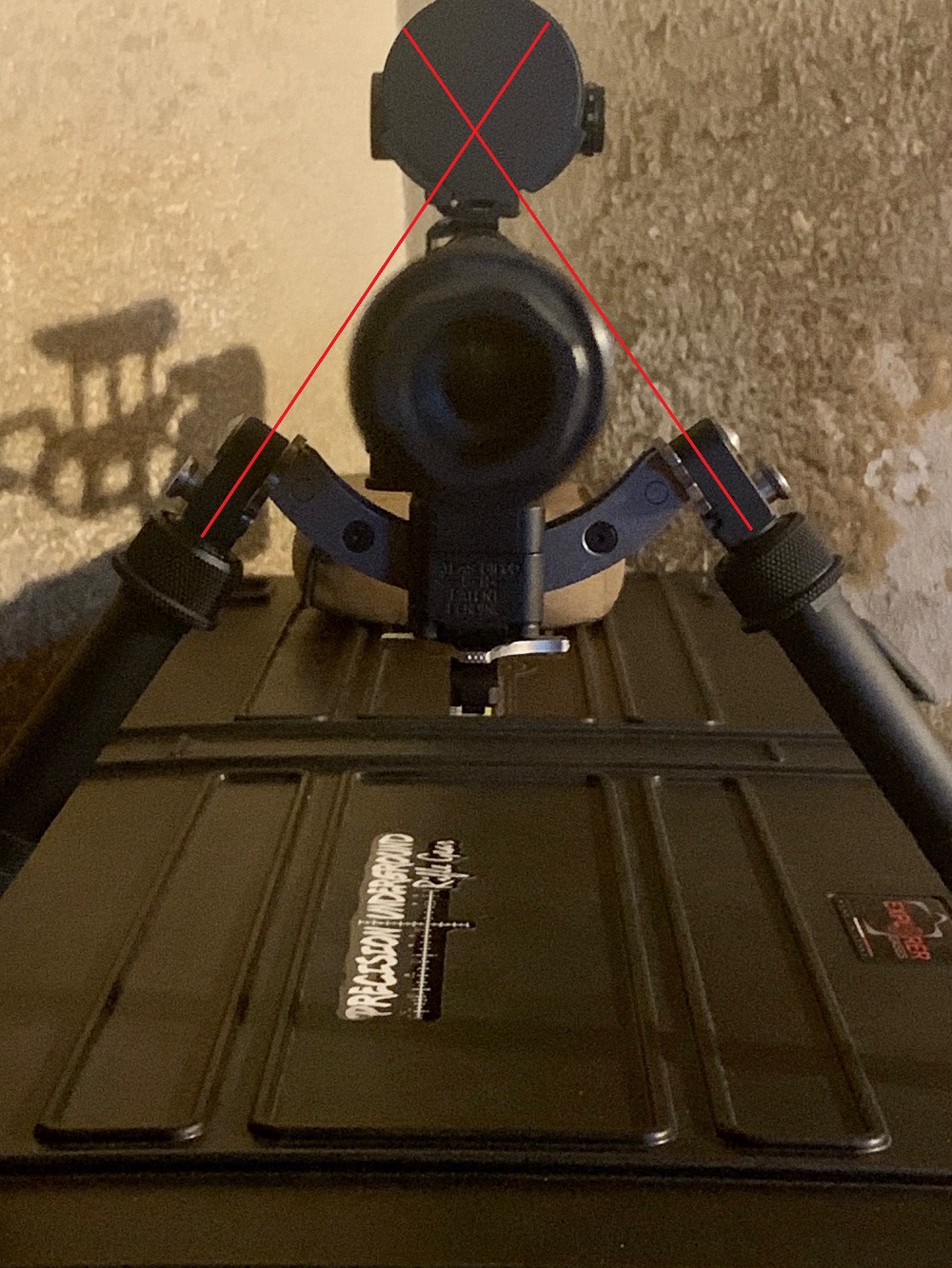

    So you inspired me to experiment! The 5-H was waiting on me when I got home (Gotta love free overnight) so I grabbed a pic rail adapter, slapped it on the MDT and drew. If the spigot adapter drops the rifle into the cradle more then wow! If not I think I'm still golden!
    And yes, my drawing sucks! :lol:

    That looks pretty good! Let us know how it compares once you get the spigot adapter. I think you’ll be pleasantly surprised. If I was home I’d take a similar pic for you.

    I might prefer a 5-H a bit because of pivot point of cant is a bit higher than SCAL. That point has nothing to do with leg angle but the radius of round rail where the mount sits.

    I went with the 5-H in the end. The rifle bore sits much lower in the stability triangle than it does sitting on the Super CAL.
