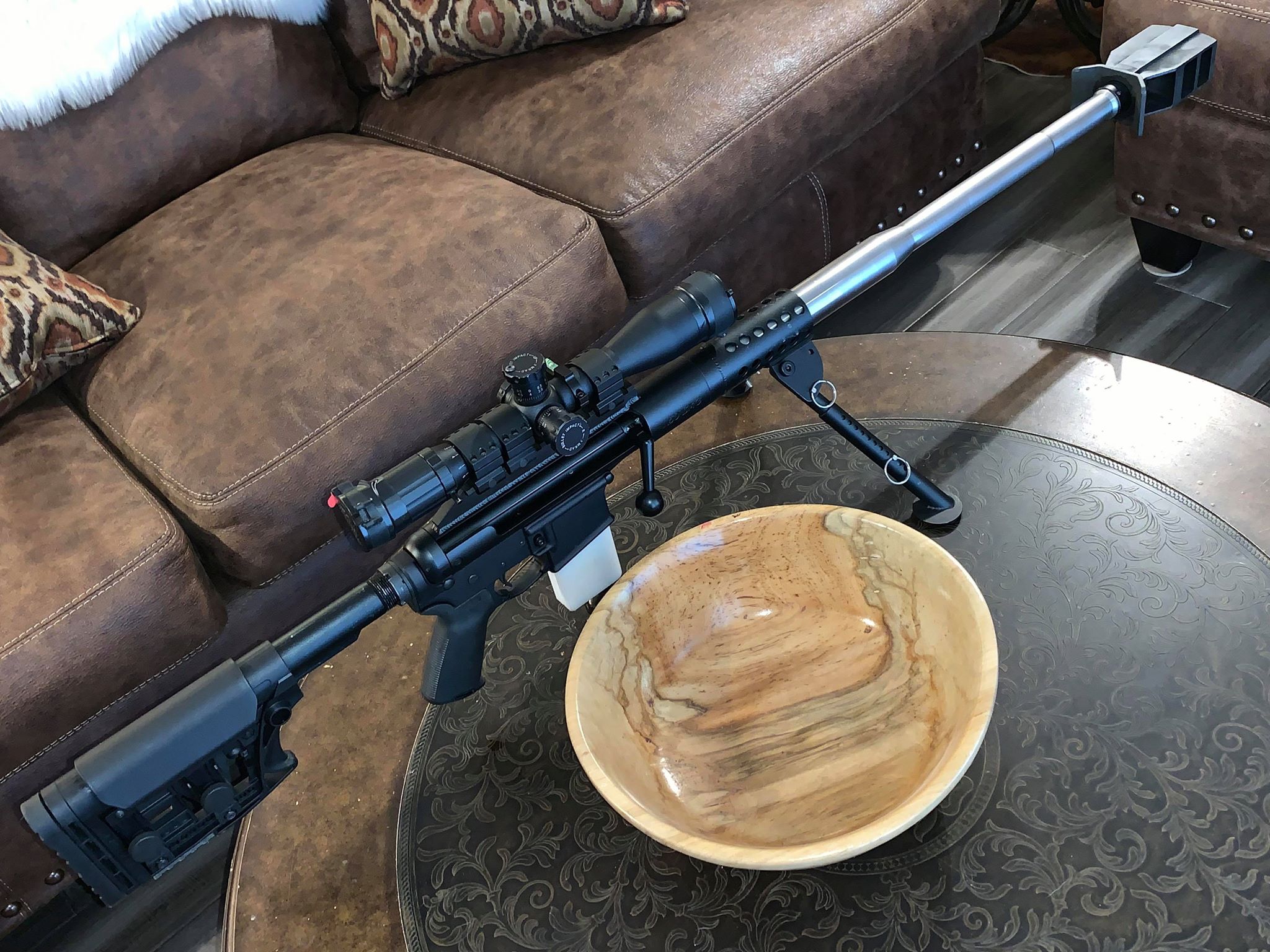

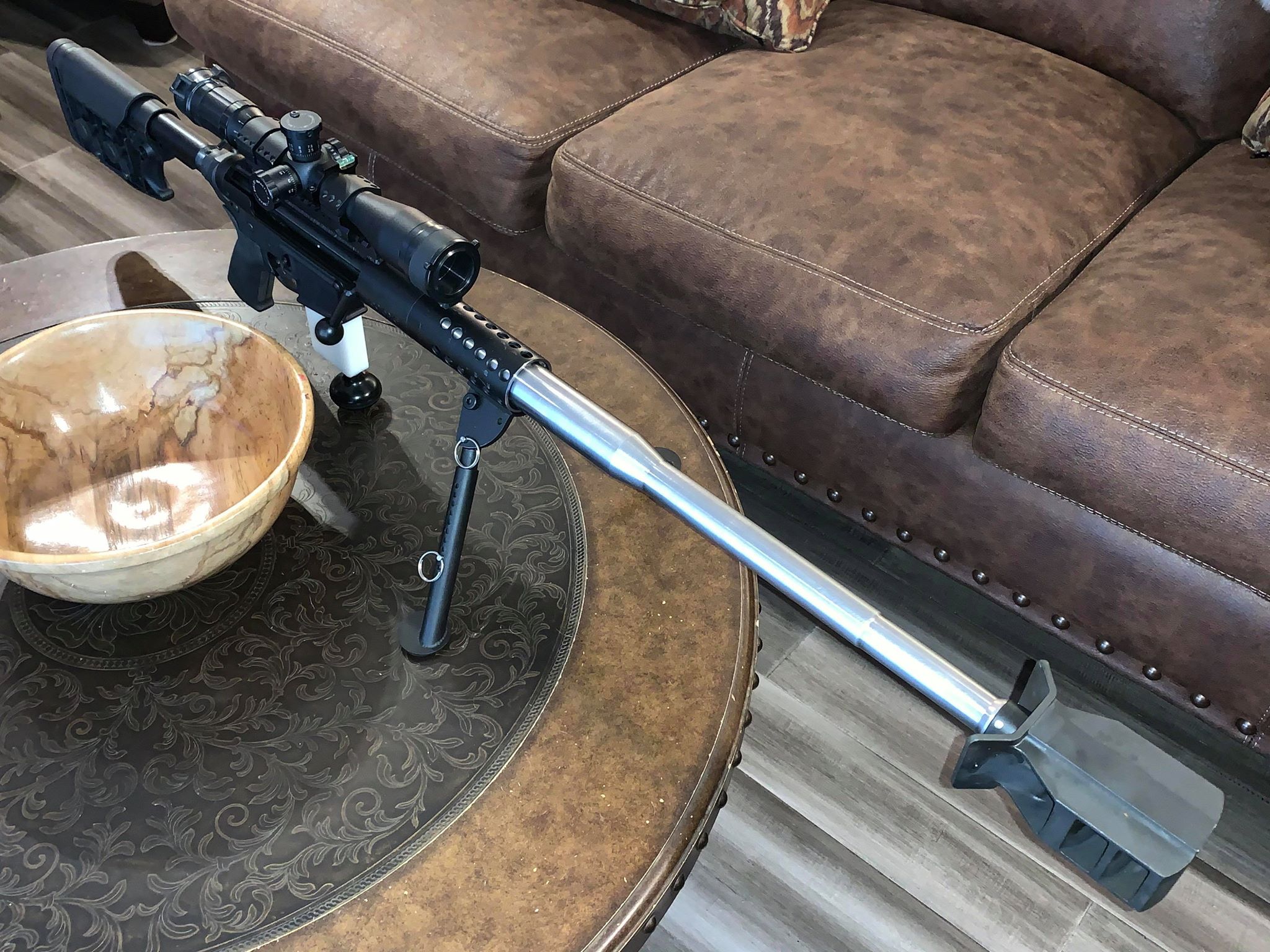

With a 24" barrel I am getting an average of 2,580 using Lake City API.
My gun weighs 21 pounds ready to go. It was a LOT heavier so I machined a lot of weight off the barrel to make it lighter. With an Armalite brake the recoil is less than a standard 308 hunting rifle.
72396560_796345447465943_7507691528777629696_n.jpg72868984_580490395824138_4607626342324764672_n.jpg
The recoil can be managed with a good break and weight; it’s the pressure wave that becomes obnoxious. Exponentially obnoxious the shorter the barrel. As others have indicated, the 50 bmg is not a walk around gun, it’s more like a crew served weapon.

Depends on the weight. 21 pounds is heavy but I know quite a few people with heavier guns shooting smaller calibers. My 6 BR will be over 19 pounds when everything bolted on.
Would I want to carry a 21 pound gun through the woods to hunt deer, probably not. Could I, absolutely. And considering the energy per pound it is hard to beat a 50 at almost any weigh
My goal was to have a sub 20 pound 50 BMG. It is 21 pounds now but the next time I have it apart I will meet that goal. I am thinking I could probably get below 19 pounds. A quality muzzle brake does more to reduce recoil than weight. Like I said mine has less recoil than a 308. The blast can be rough but that can be mitigated as well.
