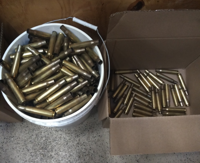

I get all my used brass from Barrett. They sell their once fired stuff used to test new guns. None listed on their website at the moment. I would call them and ask to be put on their email distribution list for notification. You really don't want ma Deuce unless you don't have another choice. Think I got 300 last time around:

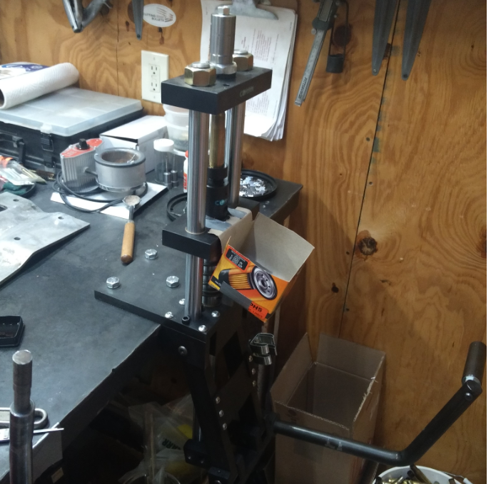

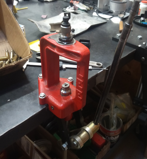

You use to be able to get brand new CBC (Brazilian) brass at a good price. Little bit softer than the Winchester which I liked. But that dried up years ago. I use plain old Lee dies. I found the selection of the right press more important than the dies. Started out with the Lee press and then move to a Corbins H series press.
Add a heavy steel table to the mix. Its a must IMHO.
