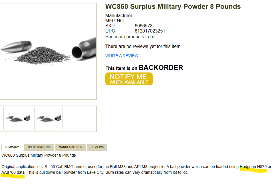

WC860 pull down is a bulk grade powder and must be adjusted on loading.
You will be able to use start data, but will have to do your own work-up to determine your batch's final levels.
In the past, we just used the H870 or AA8700 start data as suggested by the resellers.

That means starting data from manuals showing H870 or AA8700.
I haven't run the Hornady bullet but would not hesitate to ask them if they have start data for their bullet.
Failing this, I would suggest being careful and use a Dacron filler if you download since ignition can become erratic with a low case fill.
In QL, we used H870 data to get rolling and went from there, but you will expect to see slower results till you get rolling with your batch.

Found this in my notes. Should get you started. Please remember that WC860 is best used for the lighter range of 50BMG projo's. Be careful!
"Recommended start charges with either WC860 or IMR5010 with 647-650 grain bullets is 210 grains. 690-700 grain start at 205 and 750 grain start at 200 grains. You can work up in larger 3-5 grain increments. Surplus powders can vary in burn rate and require working up with each different lot number of powder. "
I was loading 205 grains of WC867 which is a surplus pull down power as well across 750s. This guidance and help came from a very reputable source of 50bmg info. USE ANY OF IT AT YOUR OWN DISCRETION
As stated adjust 10% or so lot to lot just to keep it from tearing your face off.
