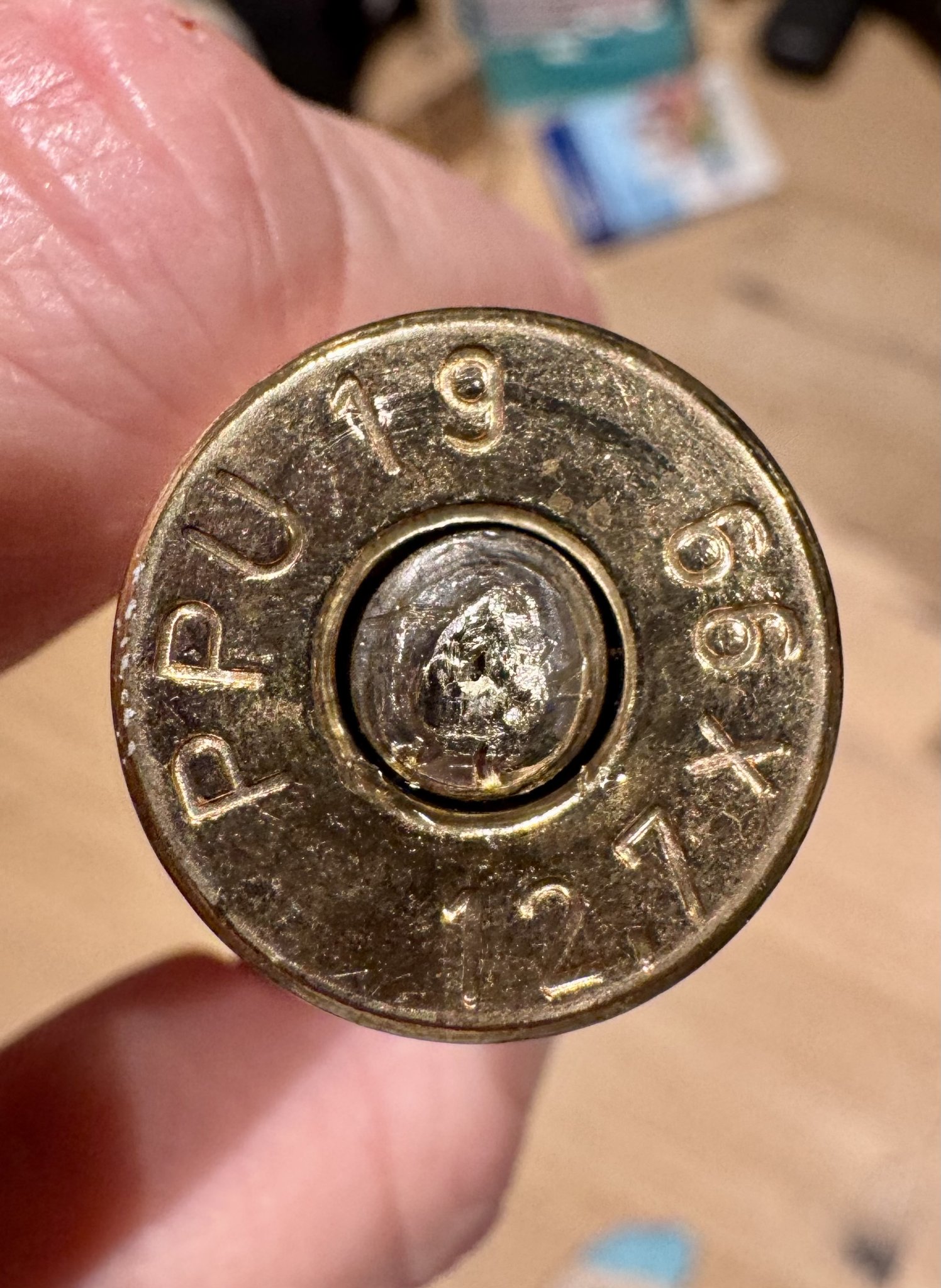

Hello guys,
I have a big problem with depriming my .50 BMG brass. I am using Hornady brass or PPU brass and RUAG or RWS or Ginex Primers. For depriming I use the Mighty amory Big Boy for the .50 BMG with the right pin but everytime the pin breaks through the primer and keeps stucking in the brass so that I must throw the brass away. Has anyone made the same experience or knows what I am done wrong?

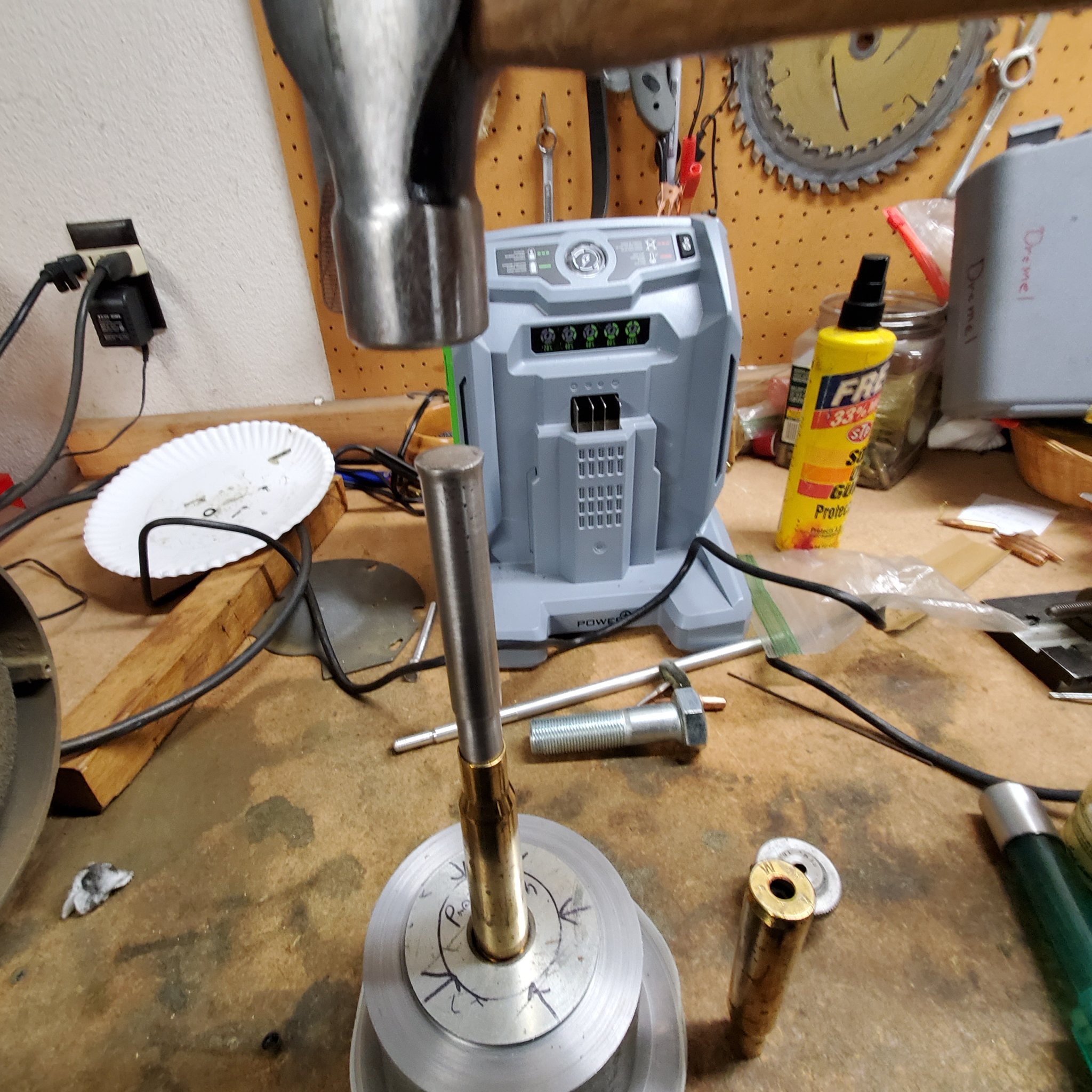

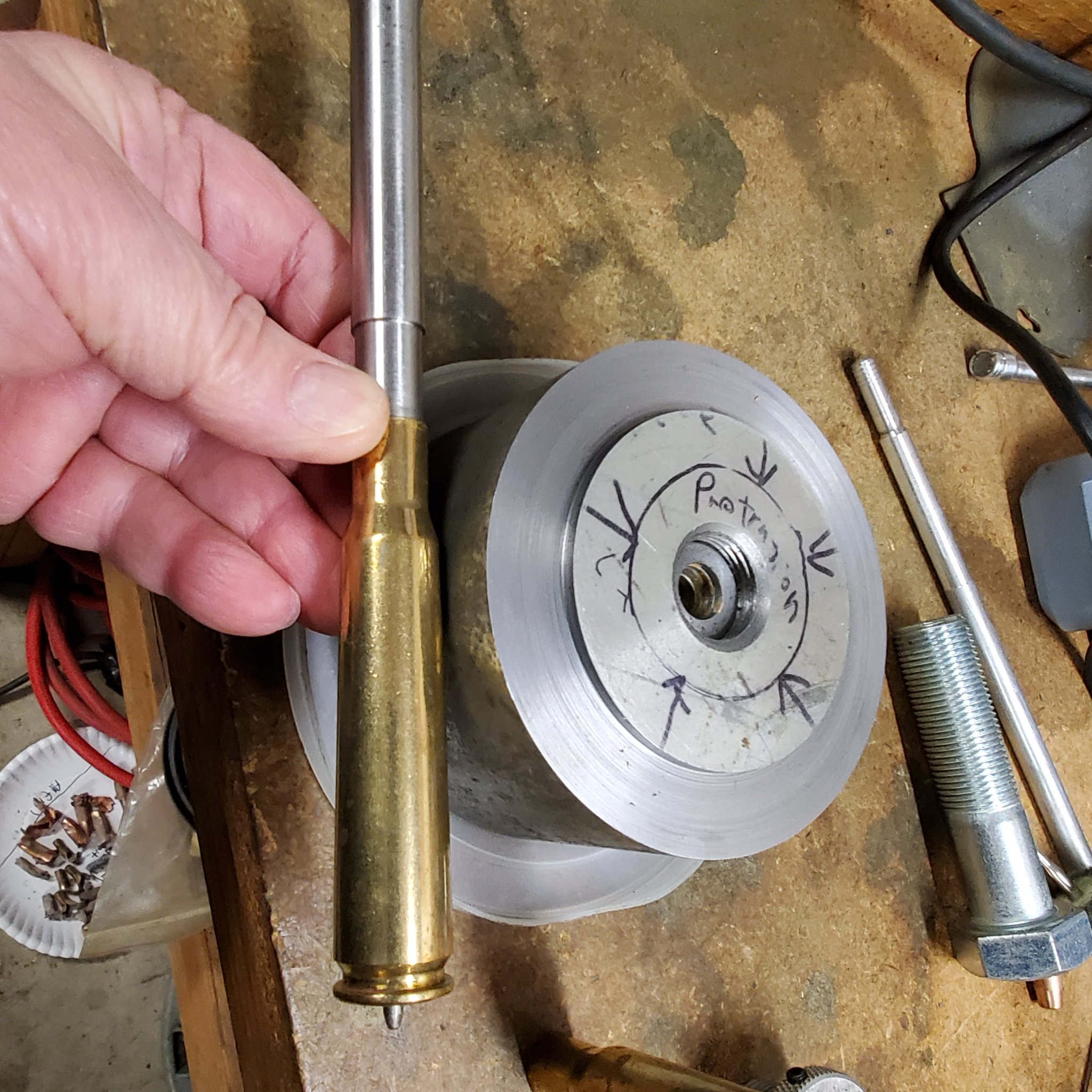

I made this tool...deprimed 1000 military crimped in 50 BMG primers without fail.
It has other functions besides depriming 50BMG.
Got the materials from a junkyard.
A coffee lid to collect spent primers.
Install depriming rod set over hub with hole and smack with hammer...
Every primer is removed.
