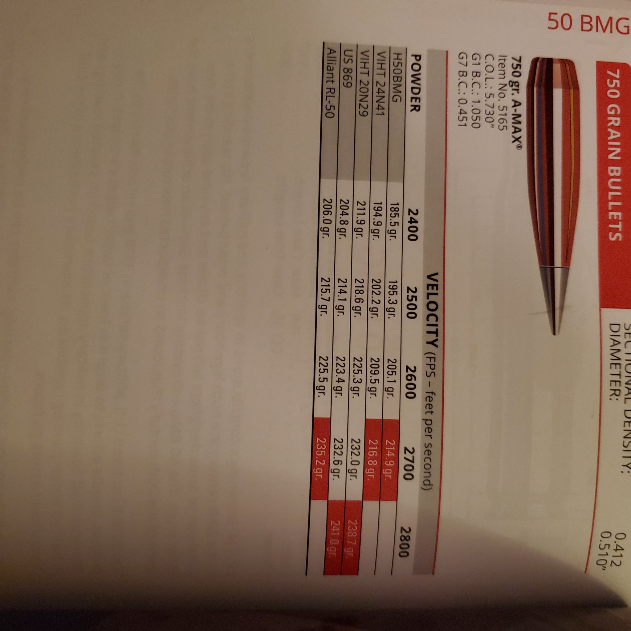

I haven't shot my 50BMG for awhile. Here is Hornady data for the 50BMG.

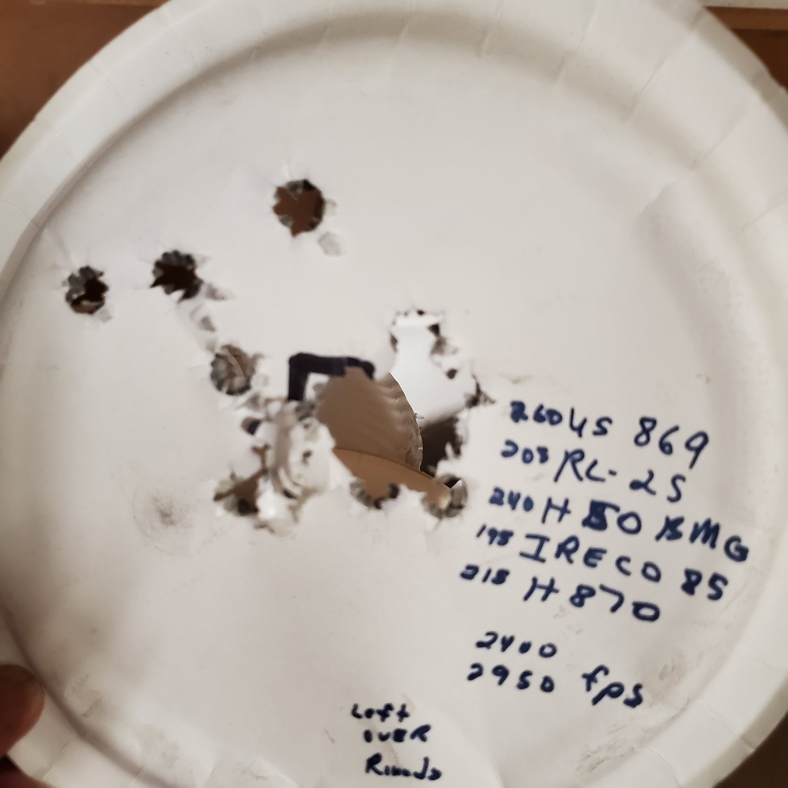

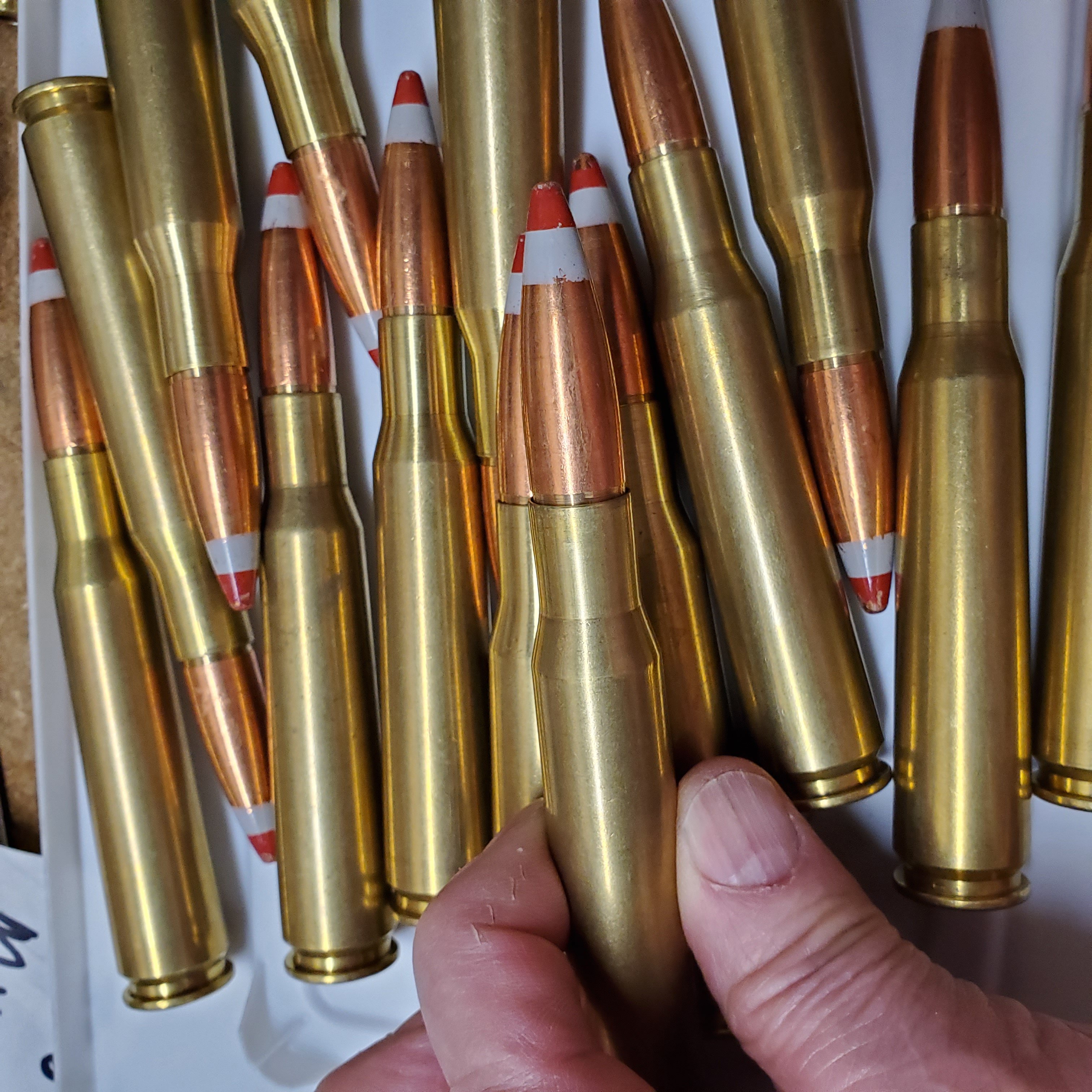

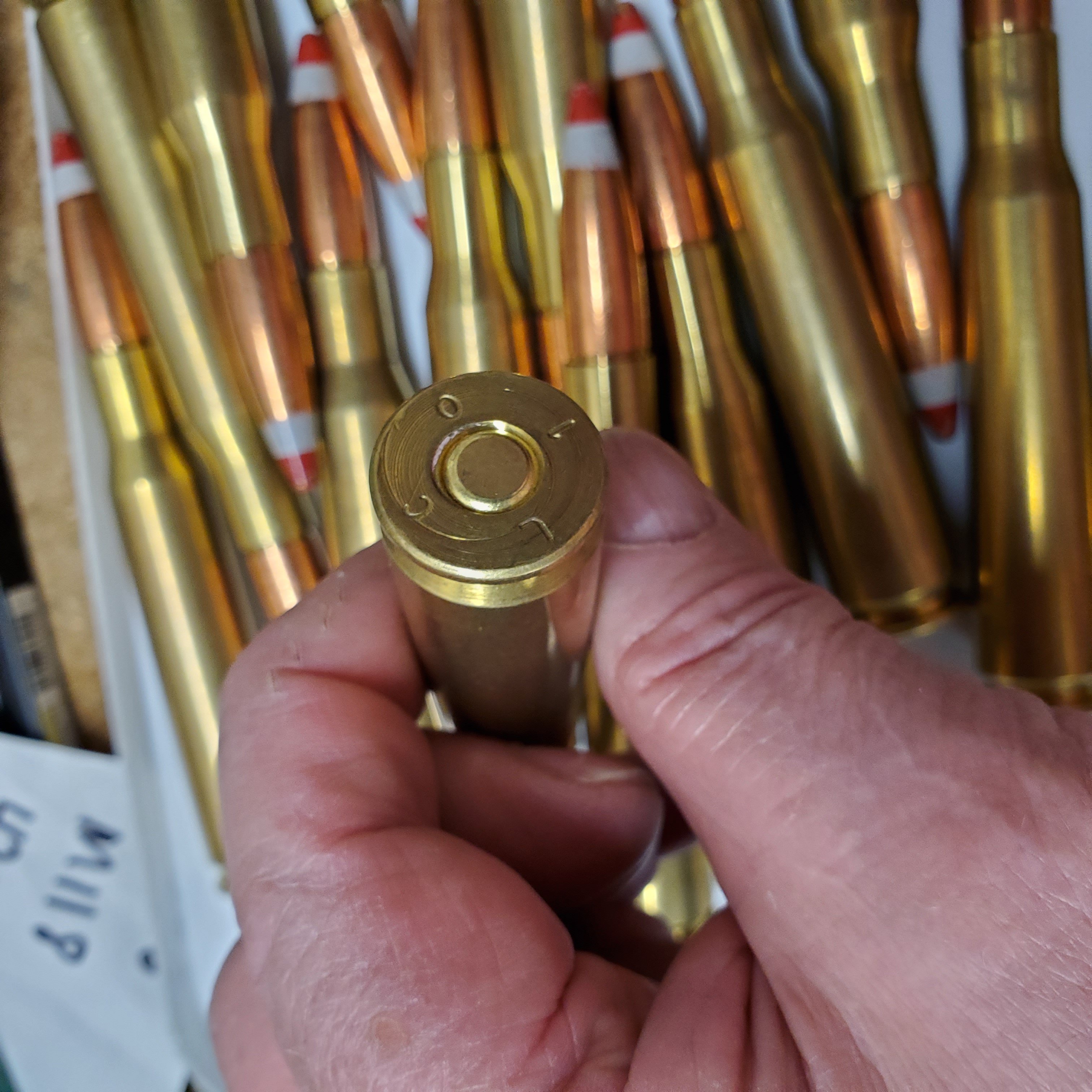

I've been playing with the 510 Whisper and wasting? ... my 750 Atips on that. Machined 700 cases for the 510 Whisper.
Still have a bunch of 750 Atips that I haven't shot through the 50BMG.
It's been awhile since I shot the 750 Atips in 50BMG, I believe I used H50BMG and US869 in my 50BMG and used the Hornady data, below. Did a bunch of 50BMG subsonic loads also.
All I have to do is load em up and chronograph them...have several hundred cases ready, and primed.
