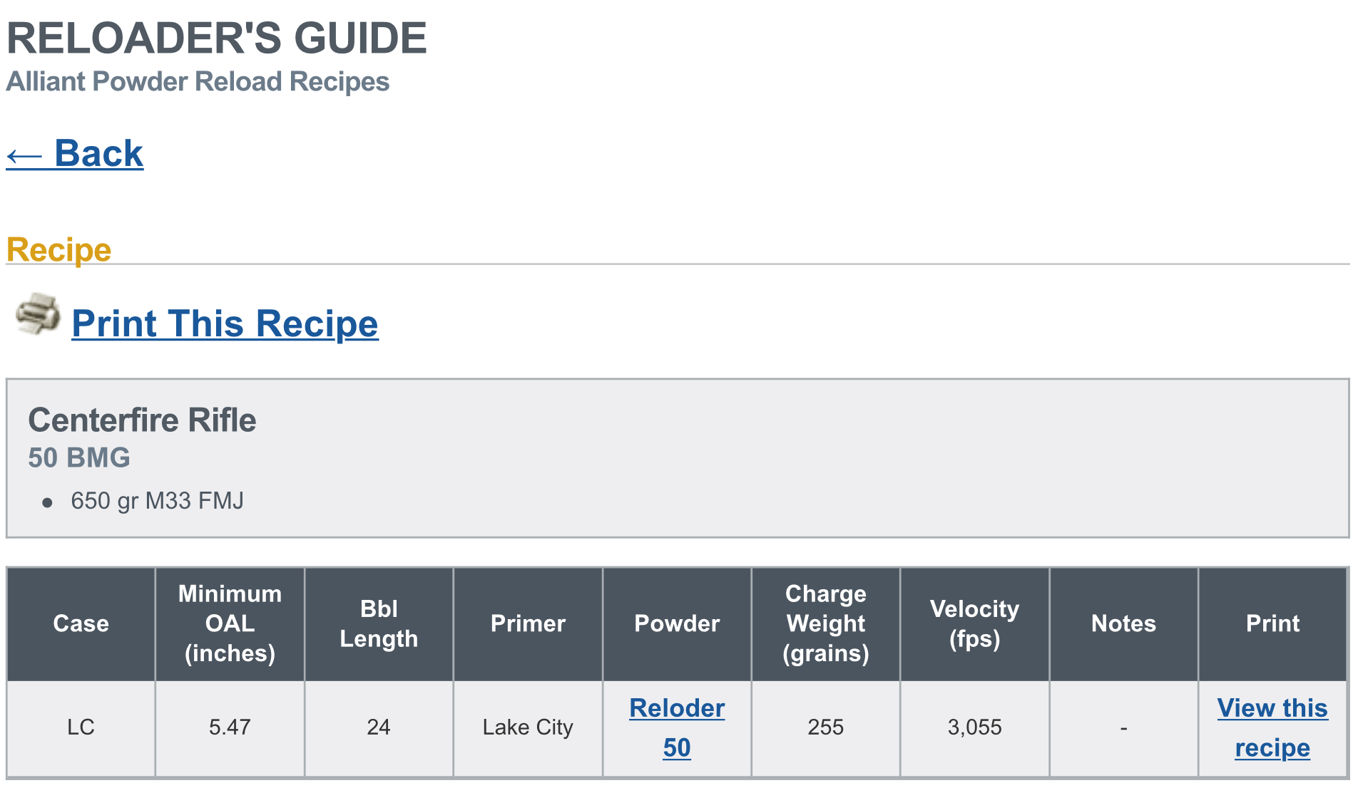

Bandit320 Gunny Sergeant Full Member Minuteman Sep 1, 2018 842 2,469 Missouri Feb 7, 2019 #3 Feb 7, 2019 #3 http://www.alliantpowder.com/reload...gtypeid=2&weight=650&shellid=174&bulletid=261 I don’t have a 50 so I can’t speak about this load. Mike Attachments D780D408-08FE-4C04-BDDD-D89B4E6B6F05.jpeg 393.1 KB · Views: 29 Last edited: Feb 7, 2019

L Lynn Jr Private Banned ! Full Member Minuteman Nov 20, 2011 635 212 62 Feb 7, 2019 #4 Feb 7, 2019 #4 256 grains is a case full of powder.
