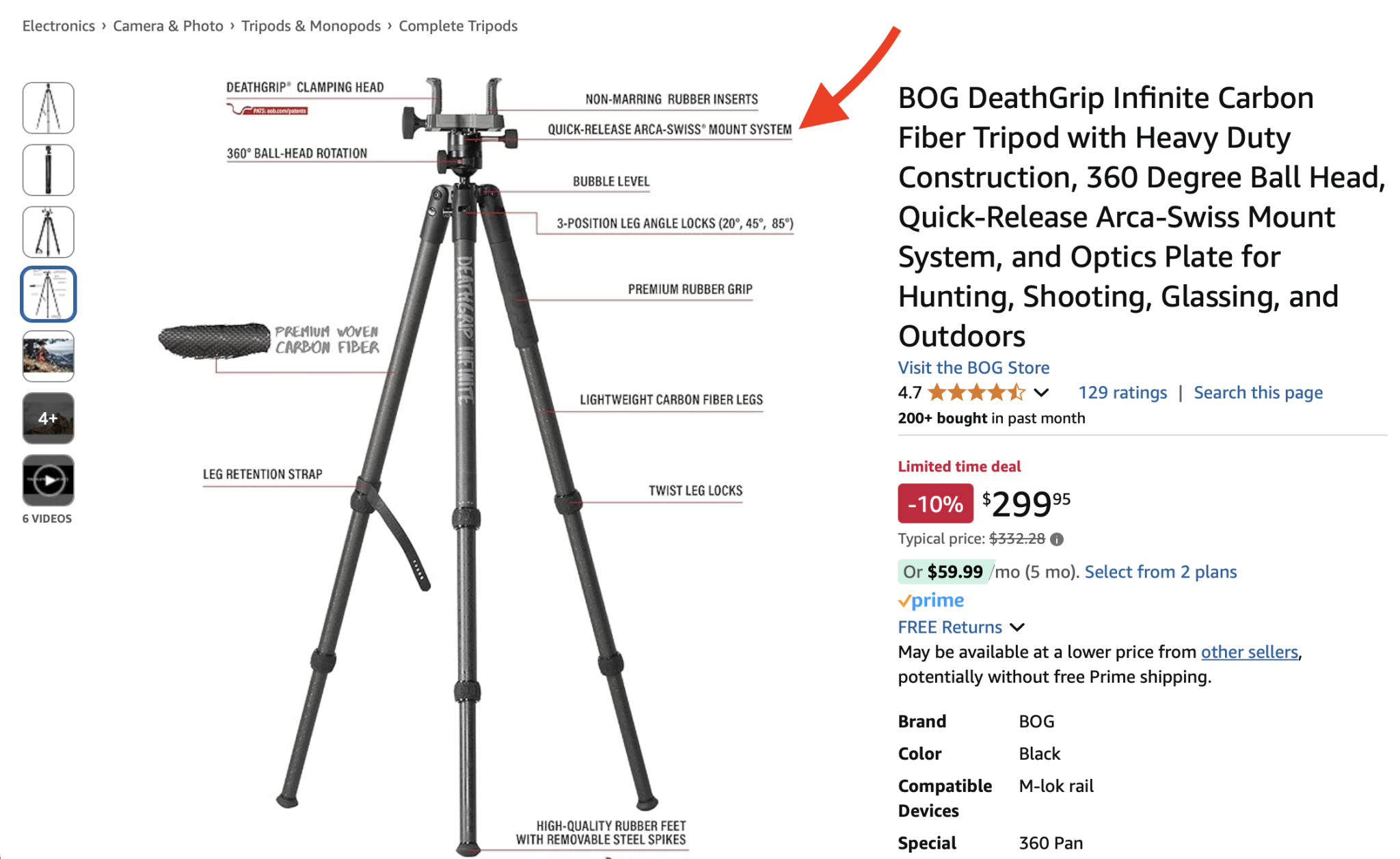

Can the head be changed to an ARCA type system?
Need to make sure it's an ARCA. They had some with just the clamp. I believe the ARCA is the newest generation.
Just wanted to show you a visual in the specs diagram... I put a red arrow to where it shows that it already comes with an ARCA-Swiss ball head on it, that the newly redesigned saddle mounts into.
