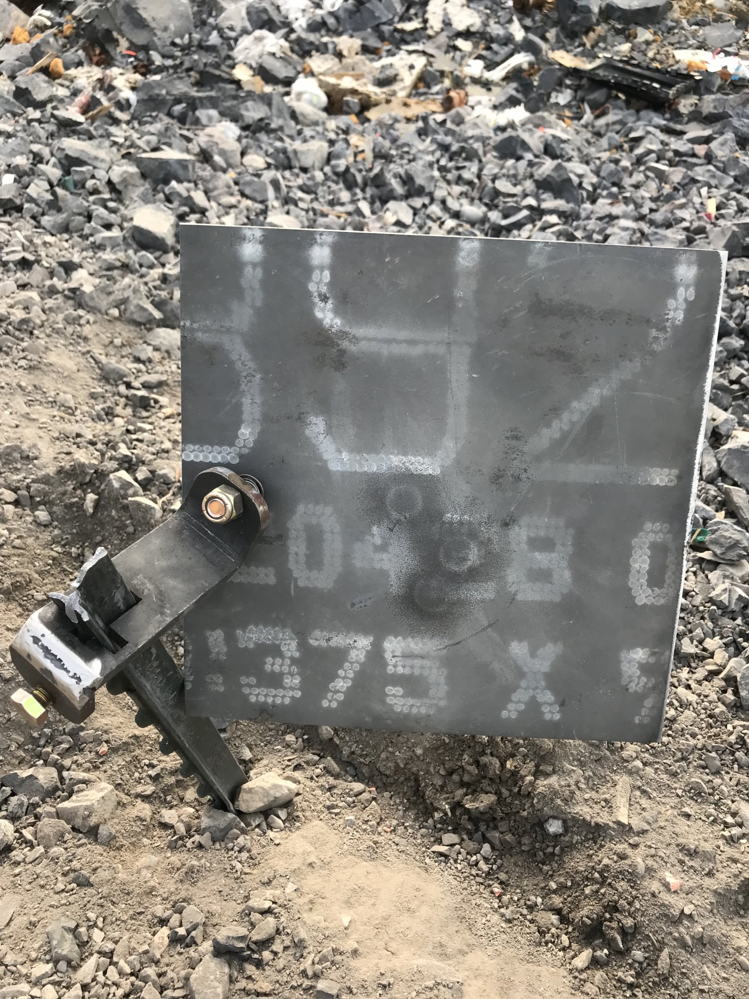

    Here’s a 3/8 inch AR 500 plate hanging from an MKM T-post hanger shot three times with a 50 BMG at 100 yards. You can see the small dents on the rear of it. That is all. the key is the plate has to give - to swing freely with the impact.
    I shoot everything from 223 all the way up to 50 BMG passing through 338LM and 375CT at 3/8 inch AR500 plates placed anywhere from 100 yards to over a mile. Other than these little divot or the occasional similar distortion of the edge of a plate from an edge impact, I don’t have any trouble. But we don’t shoot steel core.
    A buddy of mine did shoot his 30-06 at one of these plates at about 30 yards and it punched a hole clean through it like a paper punch
    I don’t think you need anything bigger than 3/8 inch as long as it can swing freely on impact and as long as you’re not punching it with ball ammo or steel core

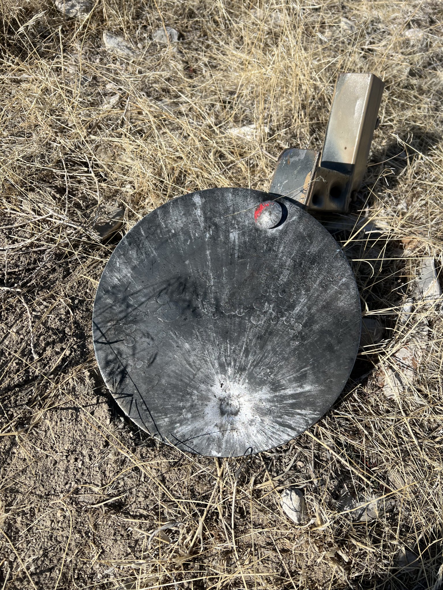

    Here are two targets shot today at 300 yards with a 750 grain Amax going 2800 ft./s. The round one got dimpled a little bit on that low hit, and the square one separated at the little scoring marks that Tyler Kemp at MKM put on his target, which I have strongly advised him against. It weakens the steel dramatically, and nobody is going and measuring their targets using the little grid. There is another hit where my right finger is low on the target, but it only caught half of the bottom edge of the target target so it didn’t separate the little squares. he doesn’t even make steel anymore so it’s your relevant, but it just goes to show you how a minor scoring of the target weakens it significantly
    Then there is the issue of how it is cut because water jet cutting does not weaken the heat treating around the edges like laser and plasma cutting do.
    The point is, I will shoot 3/8 inch AR 500 steel all day long at any range past 1000 yards with a 50 BMG and not even worry about it
