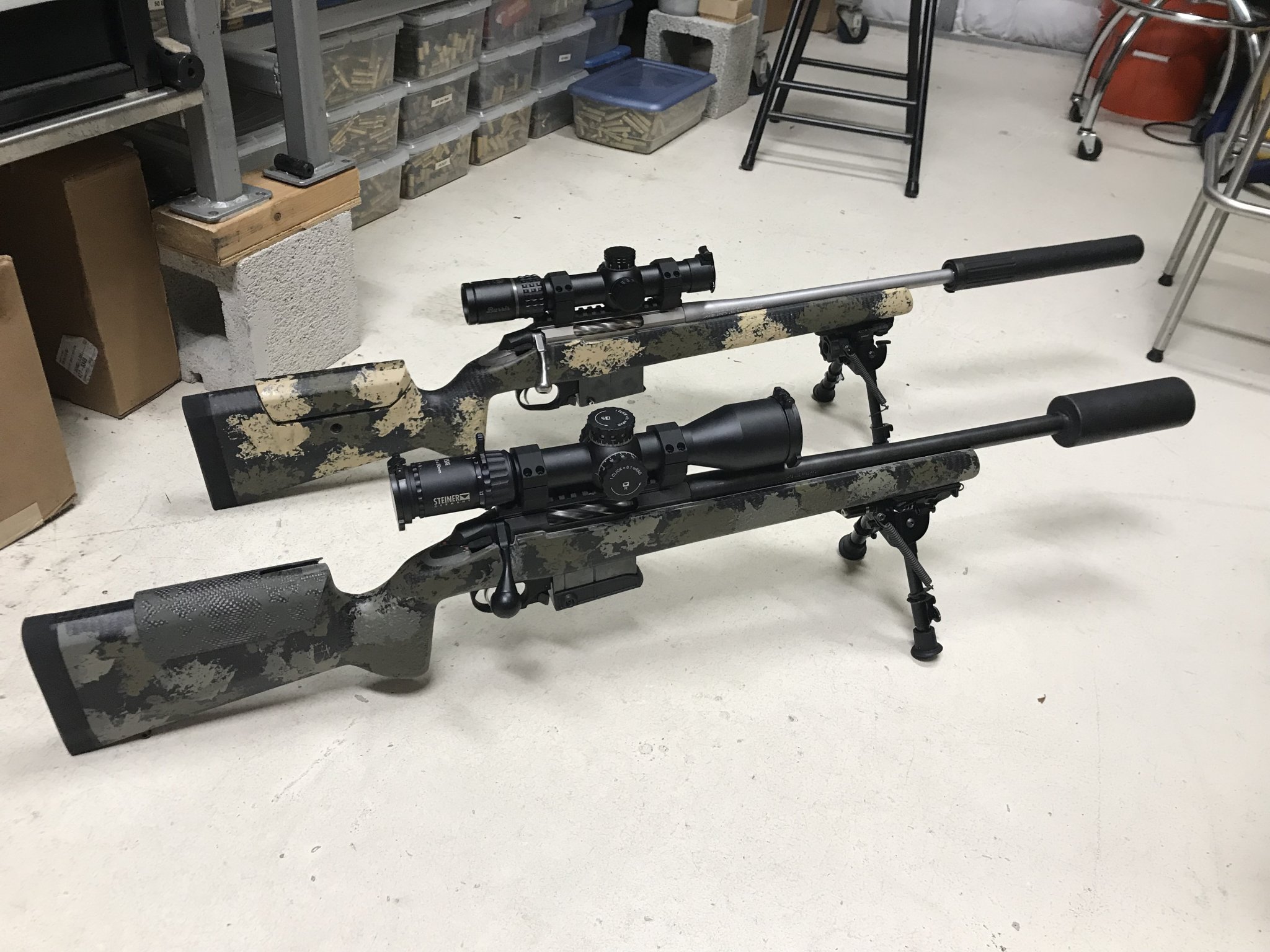

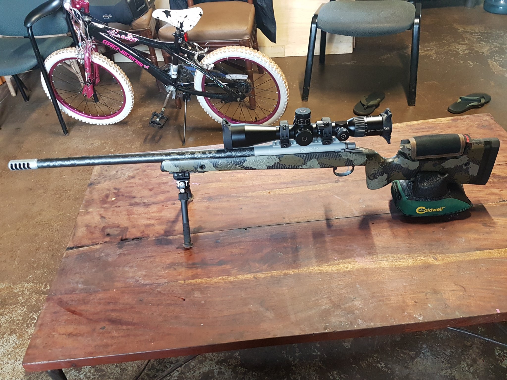

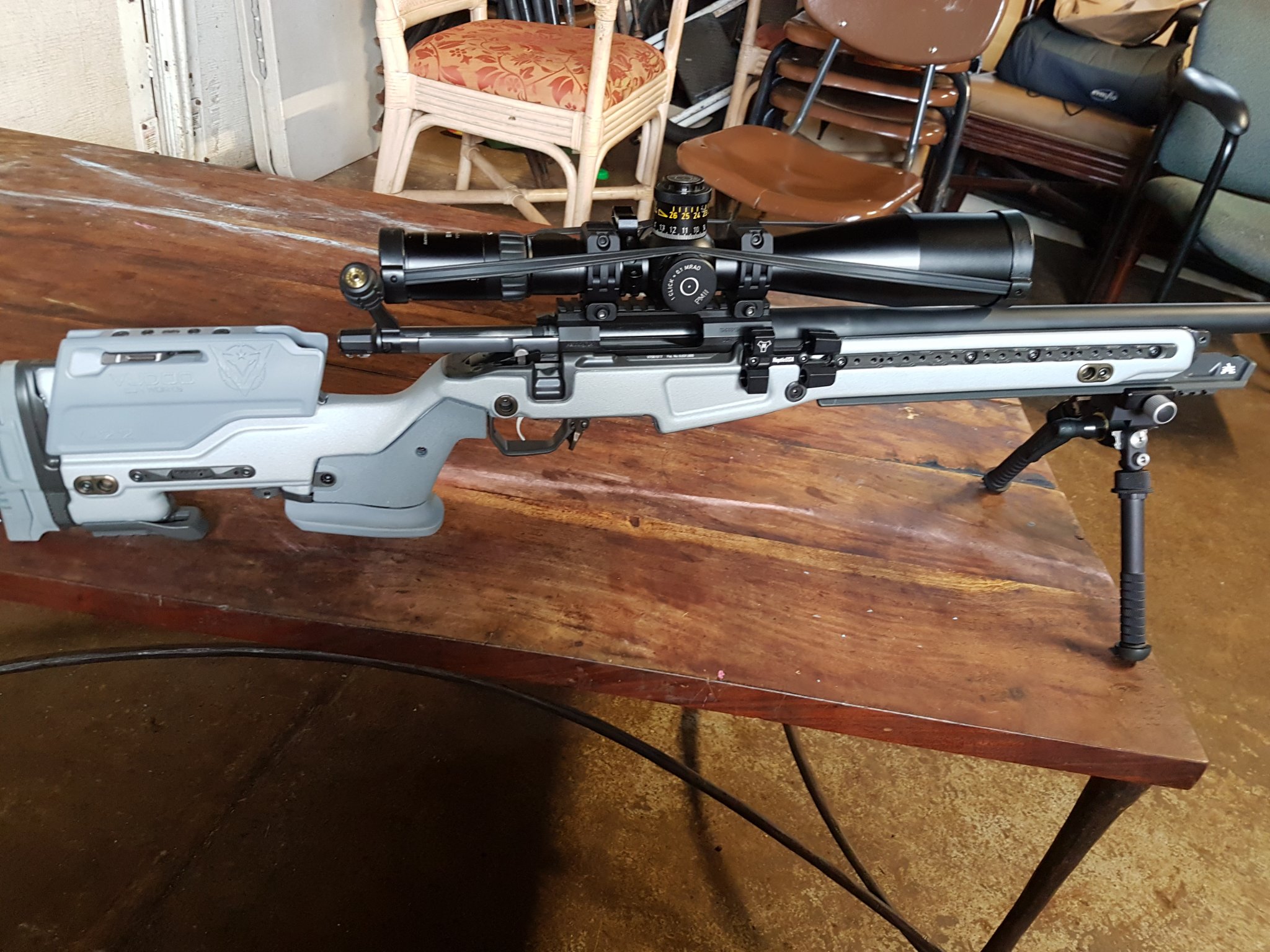

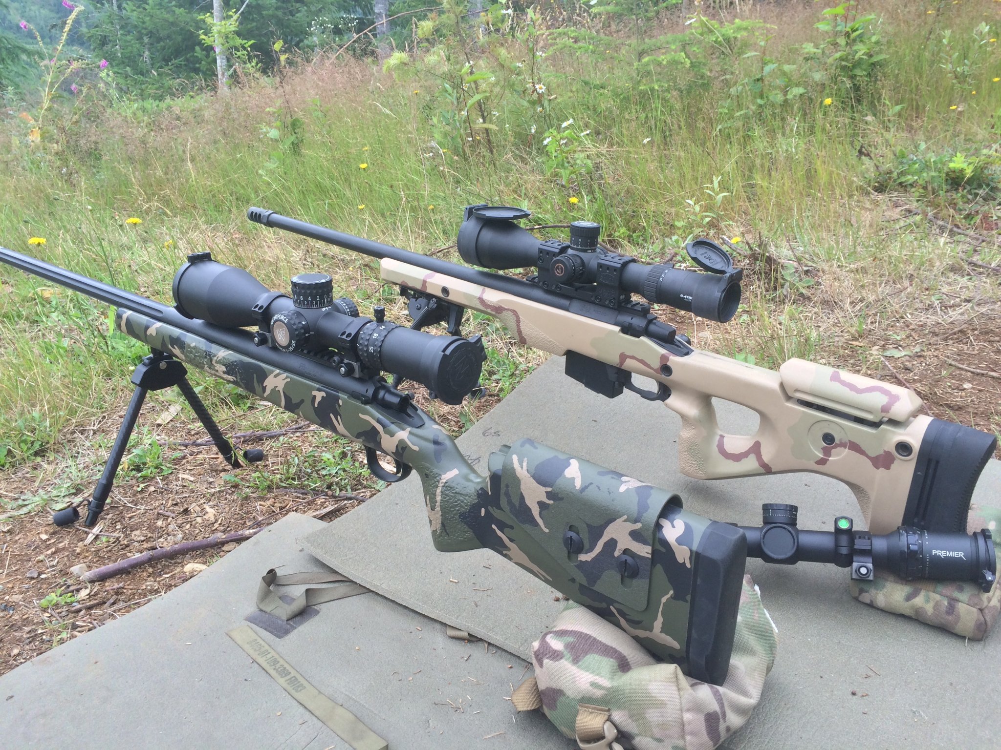

I have a 56mm obj with my EH1 and need a Defensive Edge Kydex cheek rest. Granted it's not much higher, probably .5", but it's higher than the stock for the perfect cheek alignment. I would say 50mm and below. If you want a 56mm, just get the DE Cheek piece. It's very awesome, and very light. WAY lighter than adding the KMW Loggerhead pieces to get the manners adjustable. Pics below show my NF (56mm) on there with my DE cheek riser.

R700 LA
Proof Sendero Light
3-15×50 Premier Heritage Light Tactical
Seekins 20MOA Picatinny rail
Seekins 30mm low .84" rings
Manners EH1
Still need a cheek pad for perfect alignment
R700LA
Bartlein 3b fluted
3-20×50 S&B PMII
Seekins 20moa Picatinny rail
Seekins 34mm low .92" rings
Manners EH2

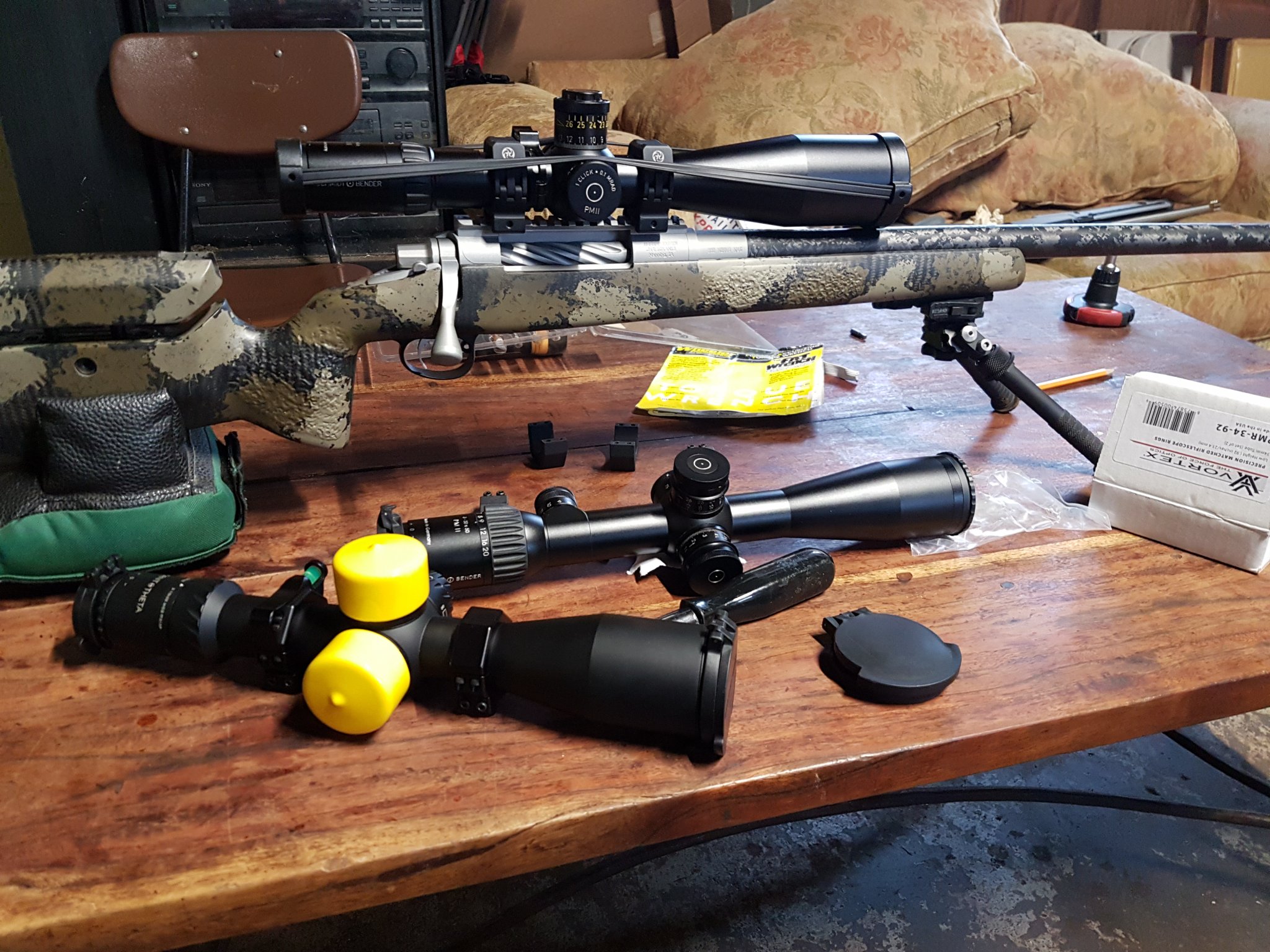

I tried .92 vortex rings same 3-20 sb scopes the mechanical housing sit on my rail and wont clear..am i missing something
