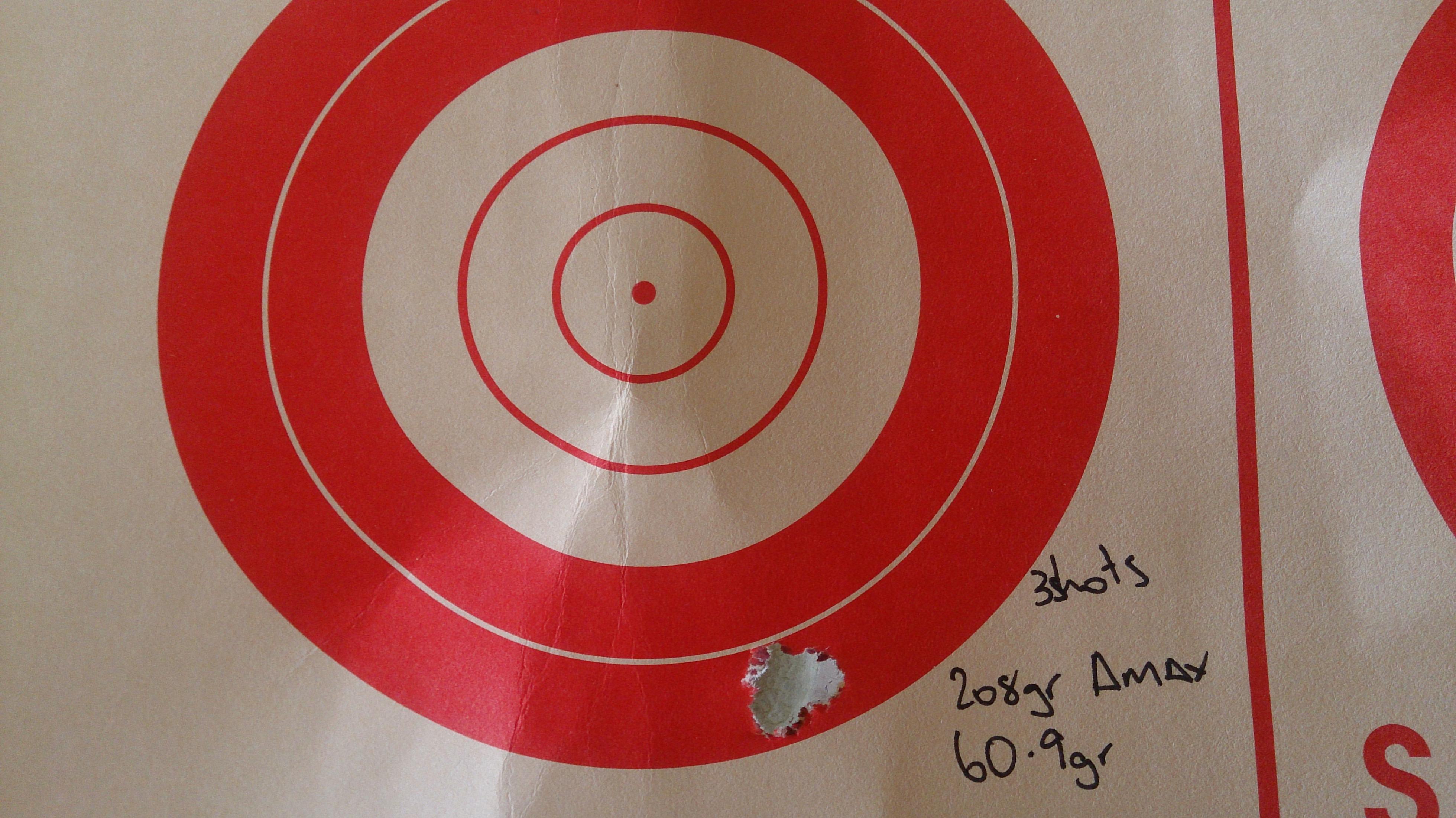

I have a Remington 5R 300win mag, 26 inch barrel. 20/1000 from the lands 208 Amax 60.9gr ADI 2209, Federal brass with Federal 210 primers. That thing is a lazer, I never thought that a factory rifle would be like that. Each shot touching the next, clover leaf!
I am not sure if you have checked your velocity but you are most likely much slower than you should be. Although you have an accurate load you are significantly undercharged. ADI recommends starting 63.0gr and max charge of 66.0gr with 2209 and 300win mag and ~200gr bullets. They state that 63.0gr (which is starting charge) gives velocity of 2650ft/sec from a 24" barrel. So at 60.9gr you are probably running slower than some 308s running the 208 AMAX.
