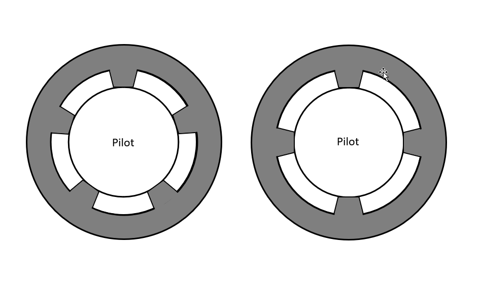

Its not rocket science 4 grove will support the front of a live pilot reamer more securely than 5 groove. Even less support of the lands are canted
(or what ever u want to call it) Spiral fluted reamer is the way to go. Carbide is even better. Chatter is only part of the problem. But I wont get into that
Be thankful that your Gunsmith is aware of this, It means he is on his game and looking at his work.
We are using a spiral fluted reamer that PT&G made for use and it limits the chatter you would get from a straight reamer because it stays in contact with the riflings at all times a straight reamer falls on and off lands anyway the my 2 cents worth , but everyone has their own opinion .
So you are saying that when a reamer "chatters" under a load, it is because of its engagement in and out of the lands it is cutting away?
I believe that is what he is saying. It has been explained to me several times in the last few days that the flutes on a conventional reamer make contact evenly with a 4 groove barrel but is not able to do so on a 5R because there is no opposing land as the flute pushes off on one side causing the reamer to cant slightly while cutting. This is what is often referred to as "chatter" and can lead to chamber that is not completely concerntric. Not really sure if it has actual affect on accuracy but that is how it was explained.
Please elaborate....
The tops of each land is simply the remnants of the original drilled/reamed/lapped hole that was used to guide the carbide tooth that cuts the grooves.

Based on their reasoning the answer is yes to any odd number of grooves, but I don't chamber barrels or measure them for concentricity so I can't support it with facts either way. At this point until someone can prove there is an actual difference in chamber measurements and that it affects accuracy, the theory of the 5R barrel engraving the bullet less aggressively and allowing better transonic performance carries more weight for me.
Would you care to enlighten us all as to how either a 4 or a 5 flute barrel supports the live pilot any better than the other? I have whipped up a sketch (below) to roughly illustrate how a live pilot fits into the bore. How exactly does what you are saying work? Feel free to draw on the sketch to show forces that would allow the pilot (in either case) to move away from dead center.
I am always willing to learn and since it’s not rocket science, maybe I’ll even understand it. Thanks.
P.S. I’ve exaggerated the lands for illustrative purposes and obviously the barrel thickness is not to scale.
Nice diagrams, how about putting the reamer flutes, the clearance between the lands and the pilot, and the clearance between the pilot and reamer in them.
Reactions: AccuSol-ERN
I’m sure that you would be better at that than I would. As I said, these are sketches. And how exactly would that change the answer to my question?
It’s a very straightforward question.
