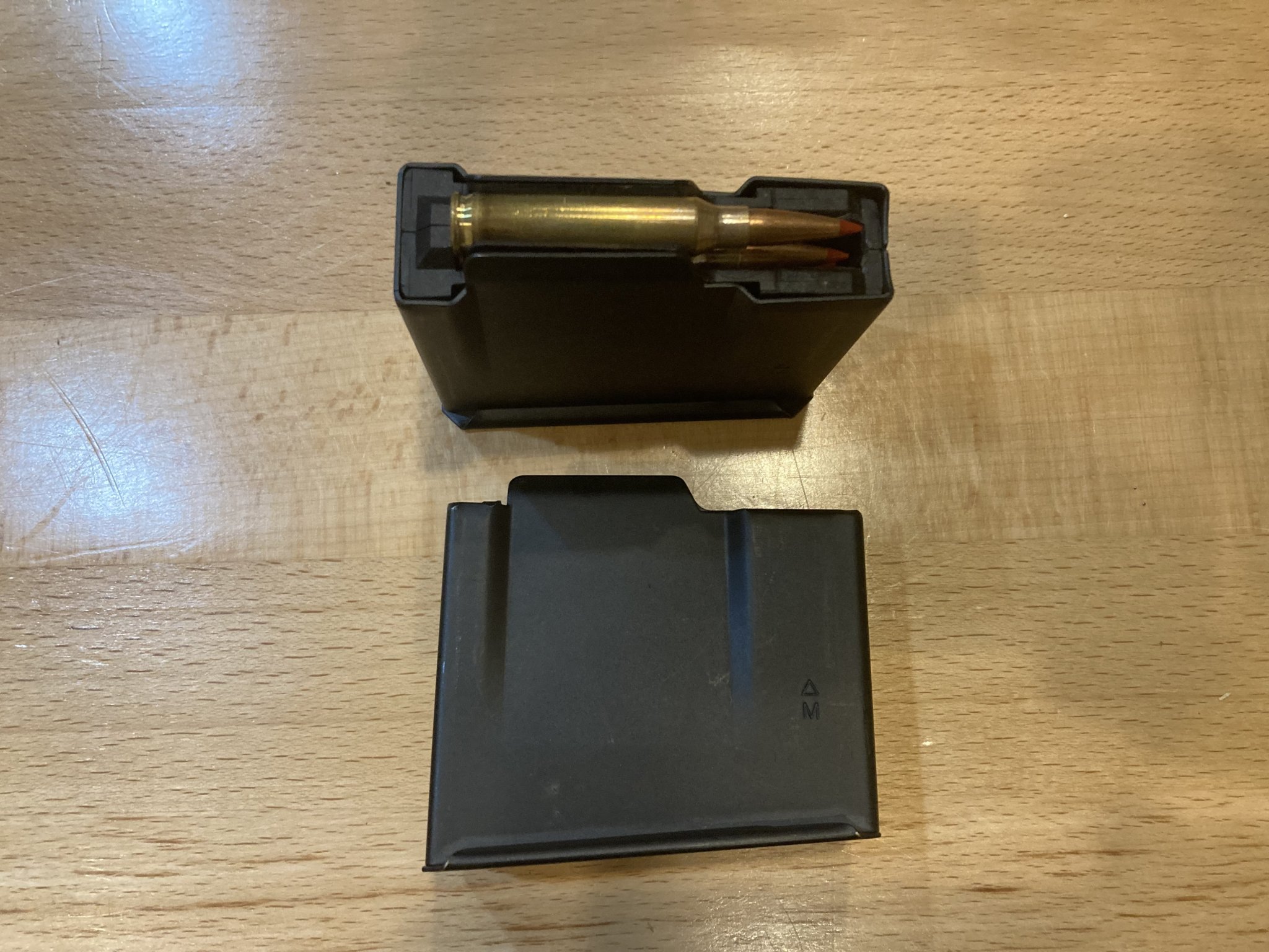

Is there a 5 round AICS pattern .223 mag that will allow seating out at 2.500-ish? I know there are 10rd MDTs but I want minimal protrusion from the underside of the rifle. Is filing out the nose of an Accurate mag the best option? I really wish MDT would make a 3rd flush fit like they do for the larger rounds, but they tell me there's no demand, so they have no plans to release one.

Accurate mag makes a great 223 5 round mag. Just needs a little trimming on the front of the liner to seat them longer. These rounds are 2.450.
But a flush fit 3 rounder would be awesome.

I have accurate .223, modified to around 2.450 for running 2.375 COAL (Berger 80.5s)
If you can, get your hands on a jewlery file set (aka swiss files),
they are much better for this mod than regular files.
Overall, the 5 rnd accurate is great for daily driver use...(y)

I have the accurate mag 10 round and the 5 round. I had to modify the mag latch to get the 10 round magazine to fit. For the 5 round to fit I'd have to remove more metal from the latch. I am hesitant to do that since the 10 round already flops around a bit. 20 practical, CDG action, Xylo chassis.
