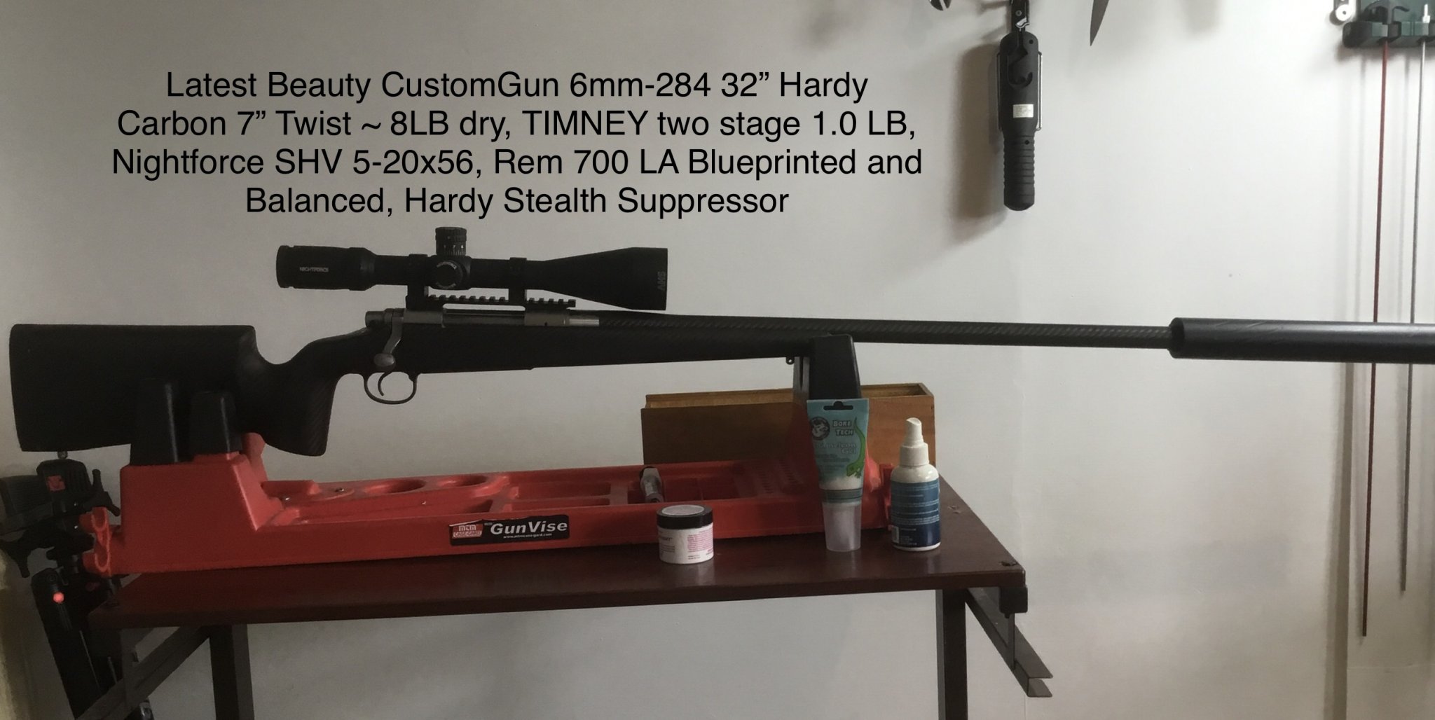

Seek hand load assistance with new 6-284 :
