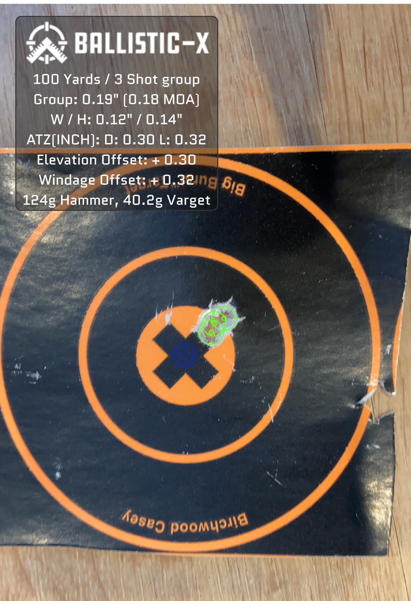

I shoot the 124g Hammer Hunter out of my 6.5 Creed at 2900 (20" barrel).
