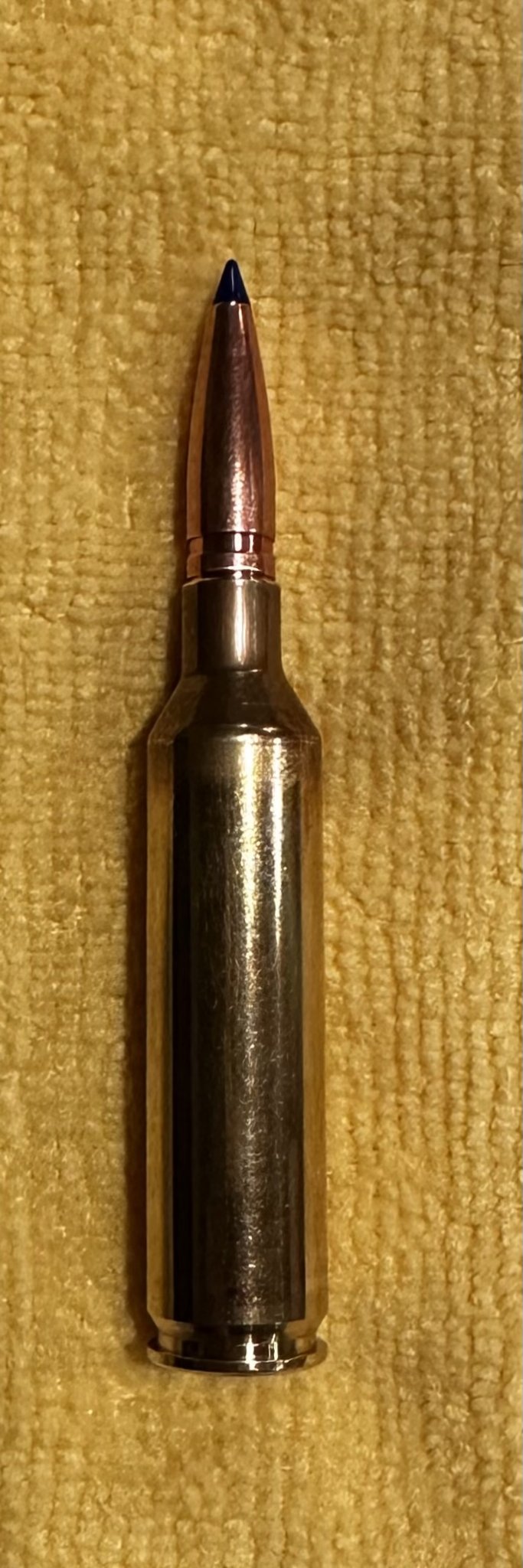

Here’s a peterson 7 prc necked to 6.5 with a Barnes 127 LRX. I know this isnt your bullet, just a data point. The bottom of the bearing surface is .025 above neck/shoulder junction. OAL is 3.23”.
Thank you very much. Will have a mag length of 3.600 to play with, so I should be good with the heavies. Dies are next on the list, a long list.
