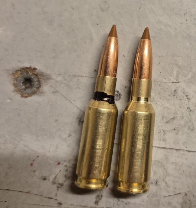

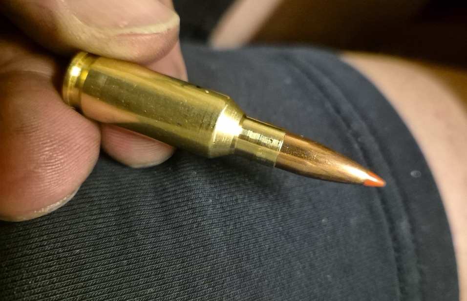

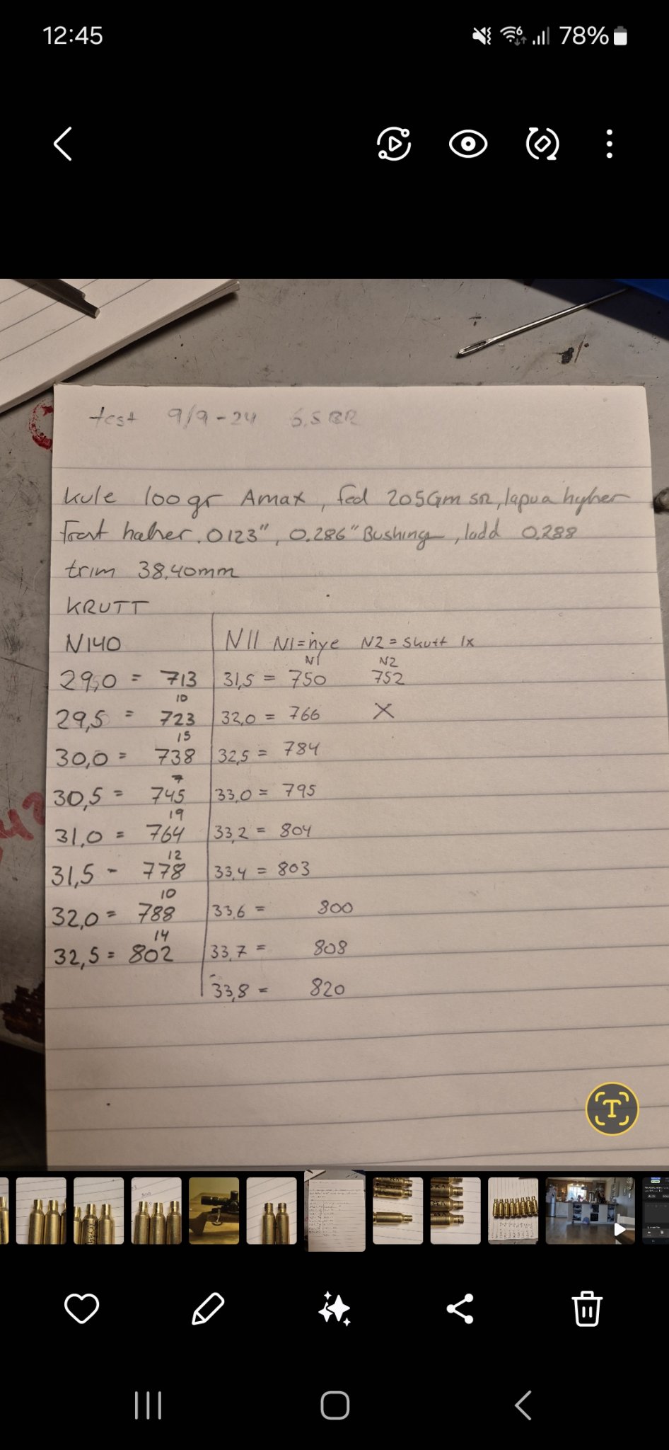

I have built a 6.5br Rem with a 1-8.25" twist 20" barrel on a Shilen Dga action, have had some chamber issues, but hopefully sorted now. Have been using vithavouri N140 and Norma 11(around Rel15) with 100gr amax,
Got to 820m/s without any serious pressure issues, but will do a new test with 123gr scenar and n135.
This is the test ladder:

Great little project for sure. It does confirm that the OP’s hope to achieve 2600fps with a 140gr bullet with a 14” barrel wasn’t going to be achievable.
There are numerous solid copper bullets on the market that would be a good alternative to the A-Max for deer hunting. They would give better penetration further out.
Yeah, I don’t see 2600fps being remotely achievable with 130s or 140s with a 6.5BR.
